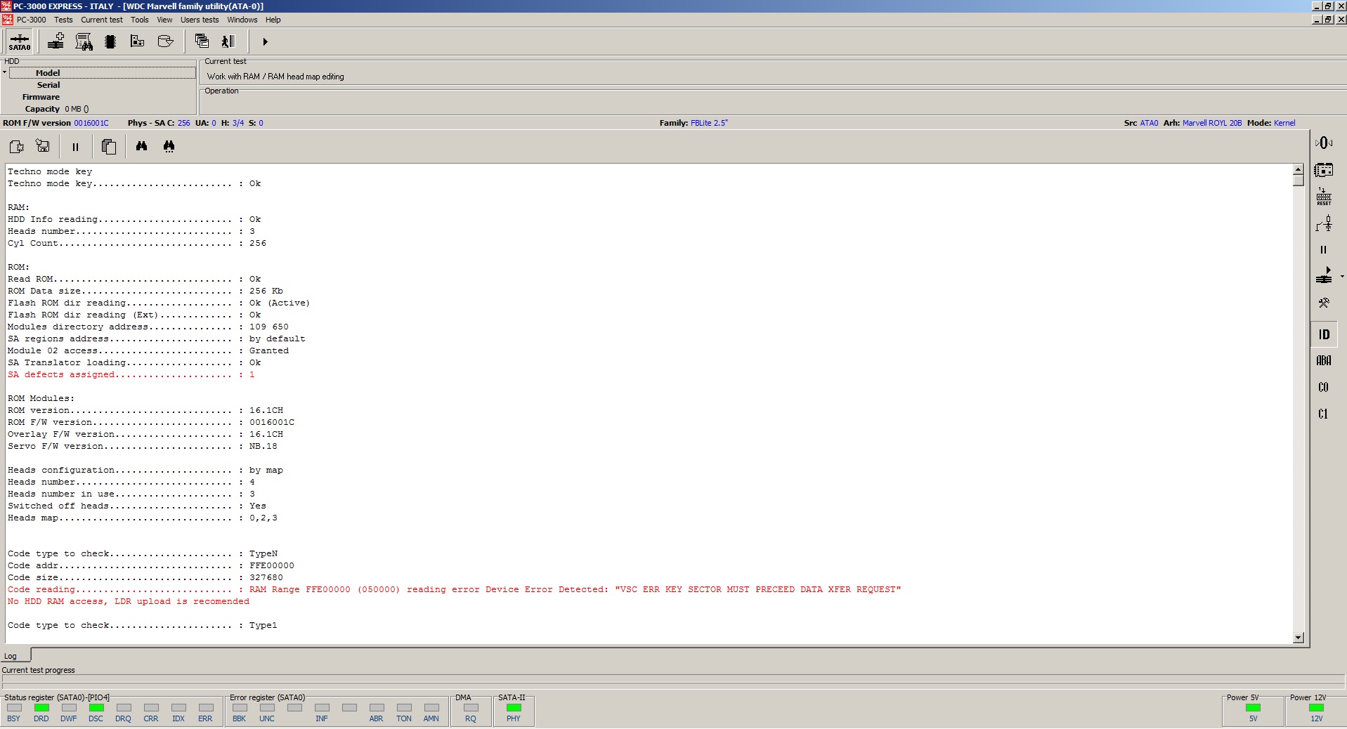

I have this situation
rec 34812.jpg (311.99 KiB) Viewed 3111 times
Re: ROM/LDR for WD5000BMVW-11AJGS3
Postby AJ2008 » 21.09.18, 16:24
Upload LDR with a corresponding revision that matches your ROM, and then check how it behaves
