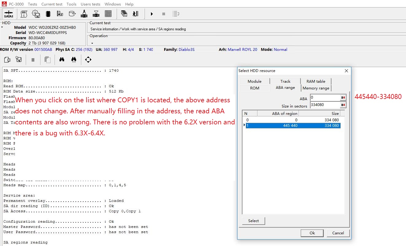

When the western data hard disk firmware area is flawed, we often use the edited hard disk different ABA area to read the module.
Before 6.3X version, this function was normal. When 6.3X is up to the latest 6.418 version, corresponding to this menu is flawed.
Caused us to need to repair this kind of breakdown, only can talk about PC3000 downgrading to 6.2X version again, can use this function normally,
Hope to fix this bug
Thanks!

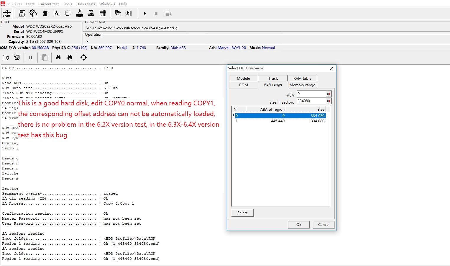

This is a good hard disk, edit COPY0 normal,
when reading COPY1, the corresponding offset address can not be automatically loaded,
there is no problem in the 6.2X version test, in the 6.3X-6.4X version test has this bug
When you click on the list where COPY1 is located,
the above address does not change. After manually filling in the address,
the read ABA contents are also wrong.
There is no problem with the 6.2X version and there is a bug with 6.3X-6.4X.

huangmiaofang, please submit a new ticket regarding this issue at ts.acelab.eu.com

Use Double click on needed region or right mouse click and "Select" option from expanded menu.
