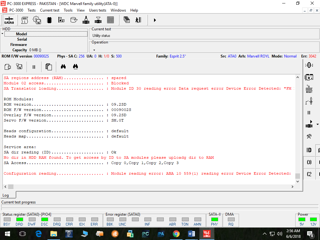

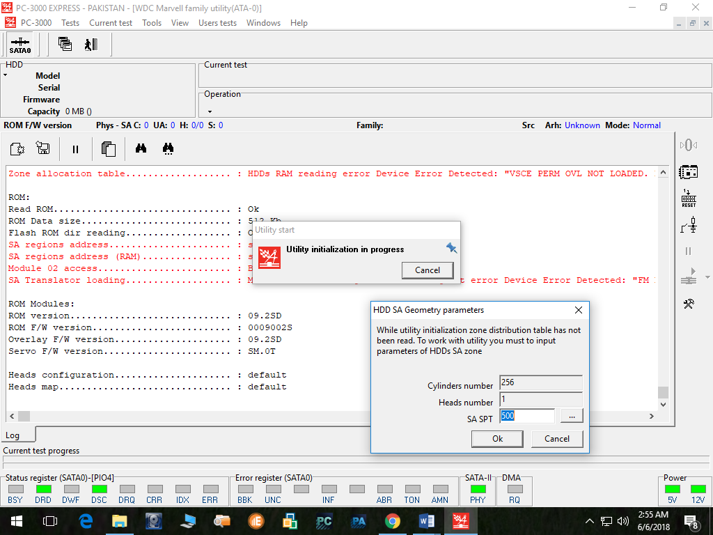

I am new in PC3000 blog :?

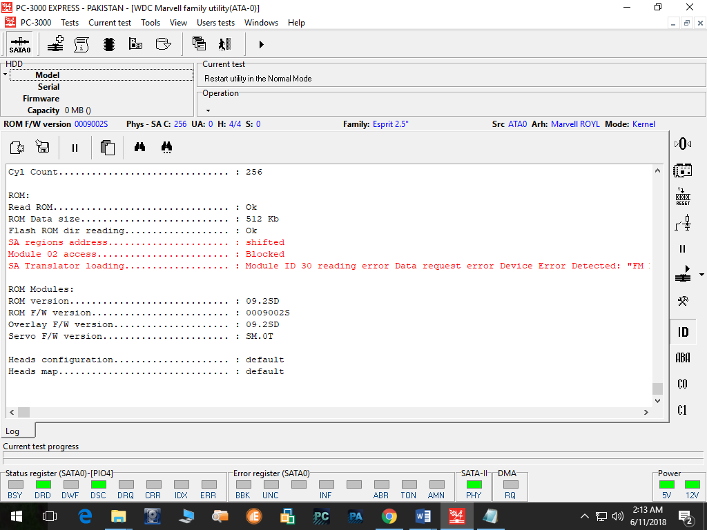

I have WD 750GB 2.5" HDD (WD7500BPKT), :x
The HDD spin normal and no noise, the status registers are also normal. :thumbup:
I just need the user data, kindly guide me.. :idea:
A few screenshots are attached for reference :?:
SA Logs.png (23.04 KiB) Viewed 5235 times
HDD SA Geometry parameter.png (24.81 KiB) Viewed 5235 times
Auto Detect.png (29.84 KiB) Viewed 5235 times

Load this LDR

Why are regions spared and 02 blocked?
Were you just pressing buttons around?
Unblock 02 and revert SA regions to normal and then post again drive's behavior.

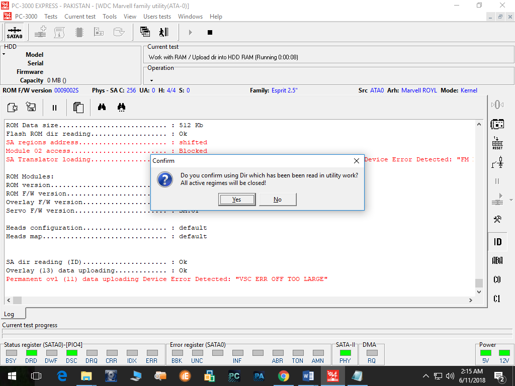

northwind, maybe Delta1 got the drive in current state :)
Delta1, heads are good, the Dir is readable by ID at least.
Just block SA access, go to Work with RAM, load Dir and loader into RAM, and tell us what's happening.

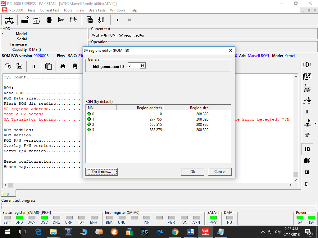

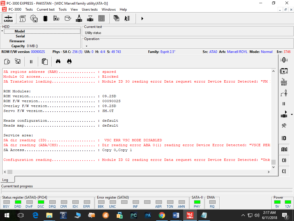

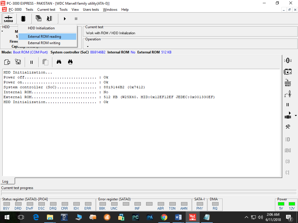

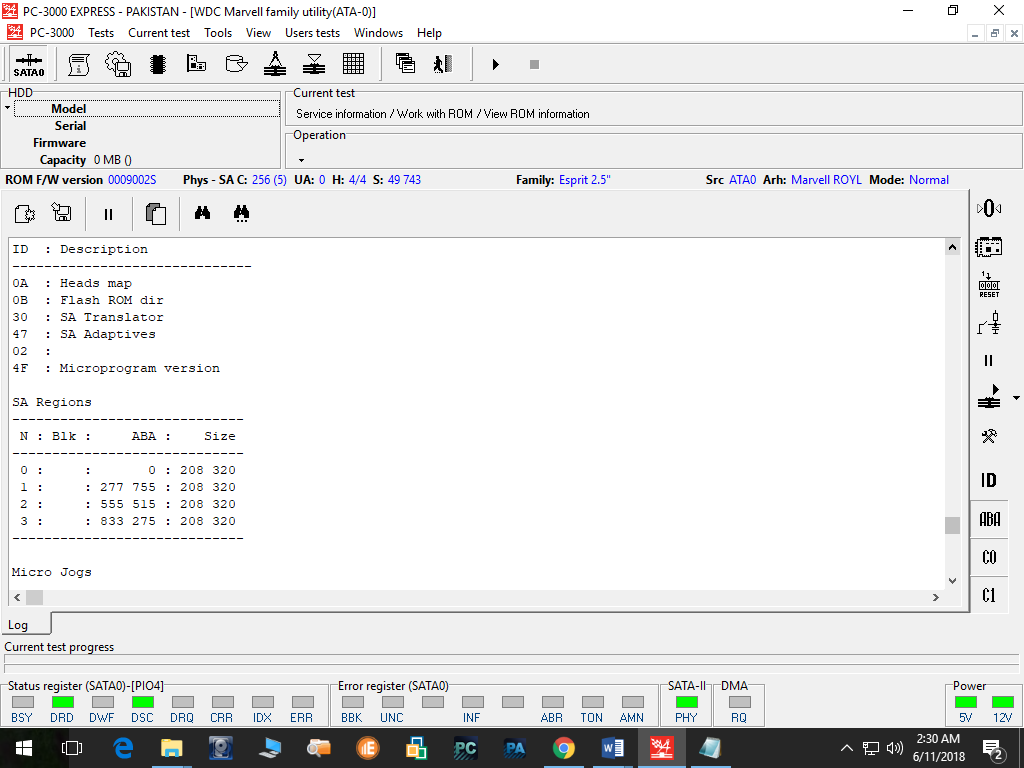

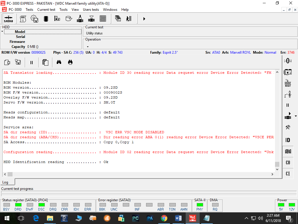

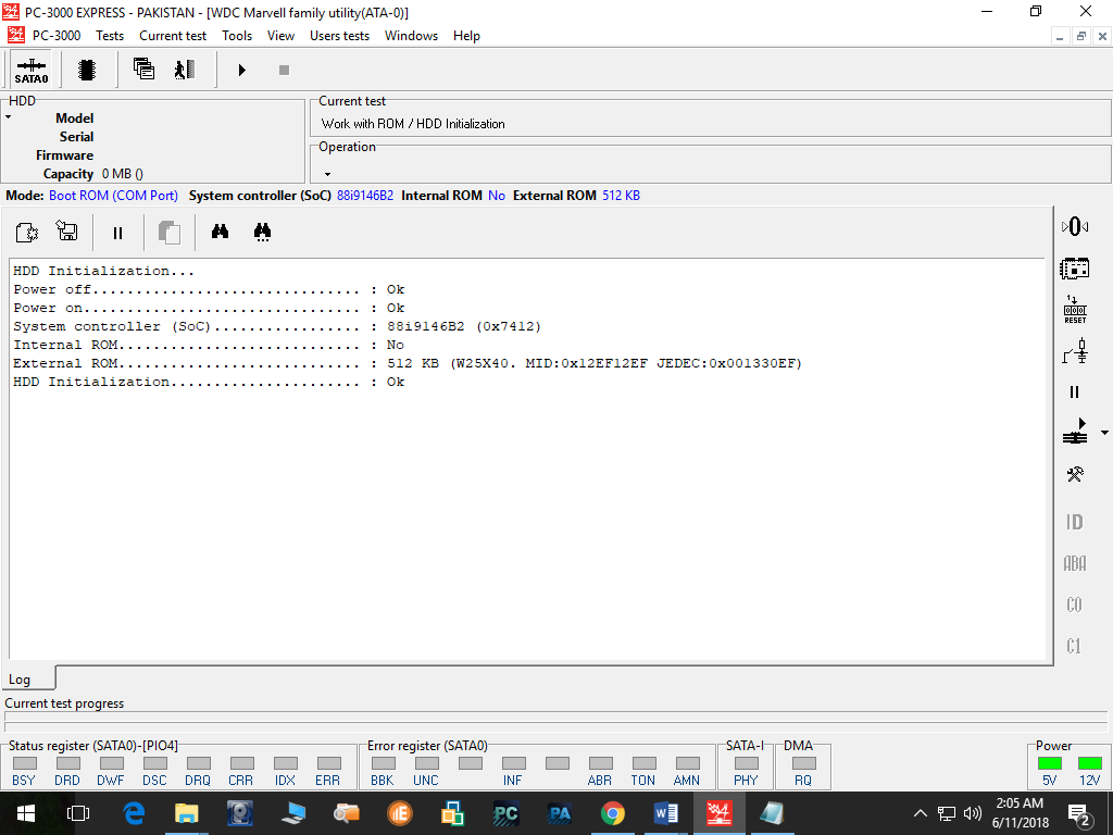

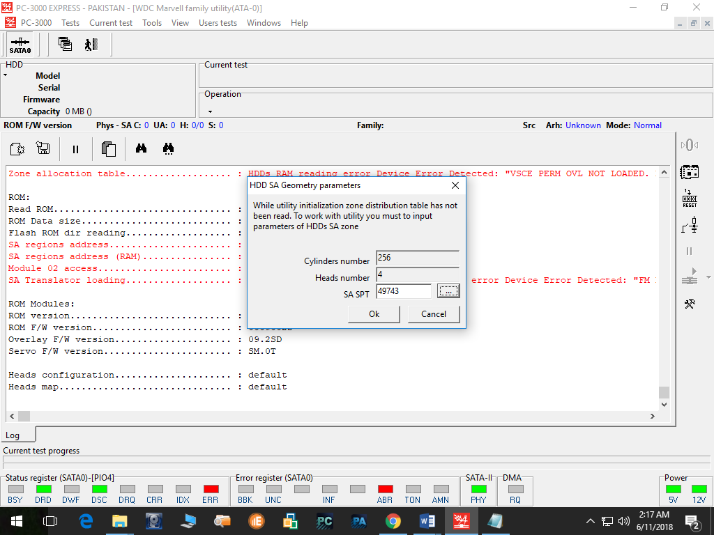

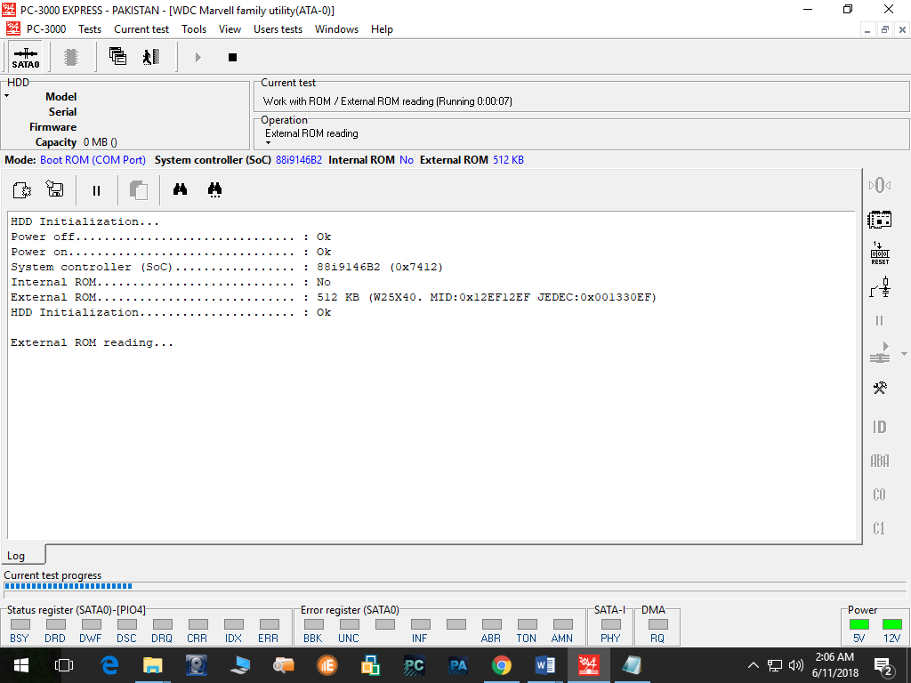

Thanks brothers
I have follow the steps as:-
Block SA access, go to Work with RAM, load Dir and loader into RAM
But have no success
Here are few more screenshots for your reference.. :shockable:
Kindly Guide me if is there any other way to copy the user data :umnik:

Postby Maxim_TS » 12.06.18, 18:51
Delta1, please submit a ticket for me at http://ts.acelab.eu.com/ with teamviewer.
