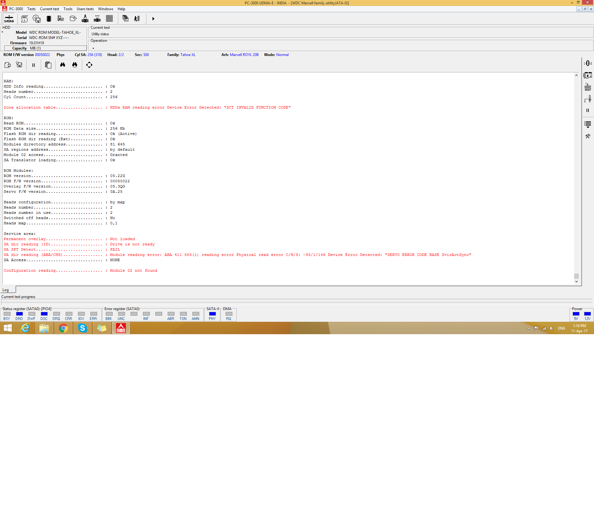

When power on it is running few seconds and showing Ready status. After loading LDR id is not showing properly.
Anybody help in this

ID never will show properly after ldr upload. That's only to get access to the SA. However, it looks like you've got some bad heads. Usually when it fails to read aerial density it's a sign of bad heads. Is the drive even still spinning after it goes ready?

datacare, try to block SA access in Work with ROM menu, and restart the drive. If it spins - the problem can be in one of heads of damaged SA modules.
If it's not - the head comjutator can be bad and heads need to be replaced.

First block SA Access ,Then upload LDR and Dir To memory ,Then you will get SA access ,Check Complete SA and Heads Quality By Doing Structure test and Head test ,report back please

I have same problem with datacare. I replaced heads and upload LDR from WD5000AAKX-00ERMA0 but other problems appeared.
I don't have firmware of WD5000AAKX-75U6AA0. Could anyone help me? Please upload the firmware of WD5000AAKX-75U6AA0.
