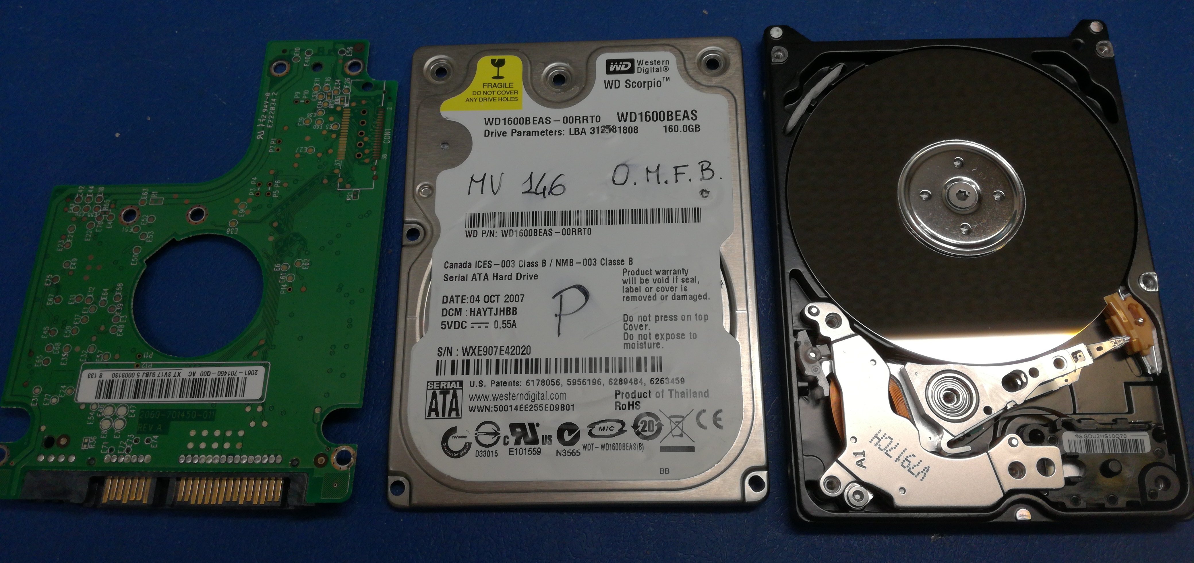

Hi all, I've encountered this drive and I think heads are not working.
I'm looking for a compatible HDD for a heads swap because I can't find a donor with same model.
HDD Info:
Model: Wd1600BEAS-00RRT0 (Recognized as Scorpio by PC3K)
Date: 04 October 2007
DCM: HAYTJHBB
PCB: 2061-701450-Q00
Could you please suggest a compatible donor?
WD1600BEAS-00RRT0 Compatible heads Topic is solved

The donor drive for heads swap procedure should have the same are following:
Model: Wd1600BEAS-**RRT* (Recognized as Scorpio by PC3K)
Same Heads map ( It is OK if the donor has more heads than the original drive, but all heads before that should match.)
Date: from September till November of 2007
DCM: ****JH**
Country: the same (Thailand in your case)
PCB: any
___
* - mean any symbol
