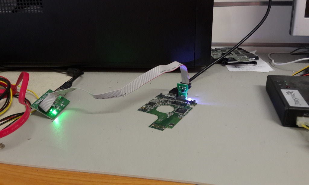

Sometimes You Have To Wait Till 15 Minutes so That Drive Can Enter Kernel Mode When Its Connected To PC 3000 Alone .Also Can You Show Me How You Are Connecting It In a Picture Attached To The Post Please

Hi Arambir,
Please find the attached picture, i waited 20 minutes an still get nothing.
Maybe i am using the Utility in a wrong way?
I go to Marvel USB/COM Utility and try to run it in Boot ROM mode, but nothing is found.

Try flipping the adapter over. Usually it's set to stick up when the PCB is assembled to the HDA.

tried both ways and it didn't work, i'll try with the HDA connected cheers mate
