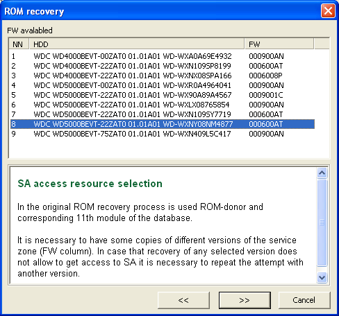

fastec
Posts: 23
Joined: 26.04.12
Re: ROM restoration
Postby fastec » 27.10.12, 11:29
I did it and it worked like a charm at first attempt.
The precaution that I've used has been to use the closest serial number available in the resources list (obviously the closest serial number for the same model, in my case it was WD5000BEVT, see attached screenshot)
Thank you
Roberto
The Available Resources List
