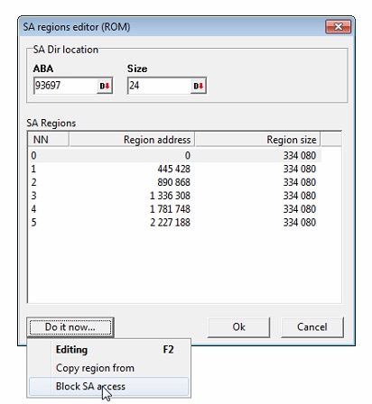

We have already changed the connection type from USB to SATA (using a compatible SATA PCB or SATA adapter), but when we start Marvell utility we see SED locked error.

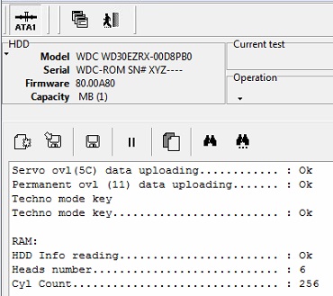

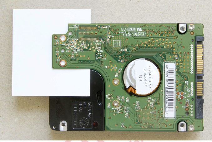

1. Start the drive in Kernel mode: head isolation with connected spindle contacts
or short E47 PCB pin to the ground (tested on 2060-771961-000 REV P1). Status registers will be off, ID is not detected, but autodetect should work correct.

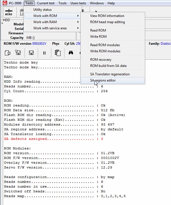

2. Follow Work with ROM->SA regions editor->Do it now.. button and Block SA access.
3. Power off the drive, remove the isolation.
4. Power the drive on.

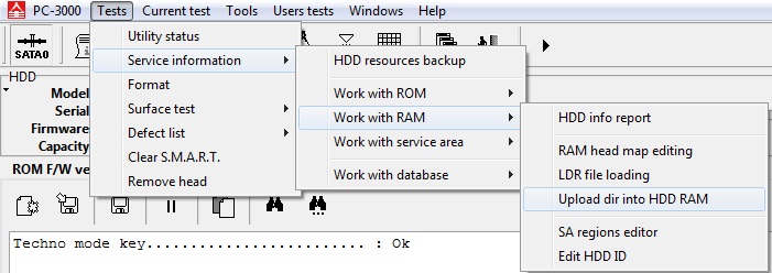

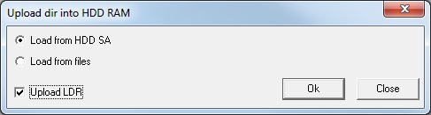

5. Start the utility in Kernel mode, load DIR into RAM using Work with RAM->Load DIR in RAM option.
Exit from utility, start the utility in Normal mode.

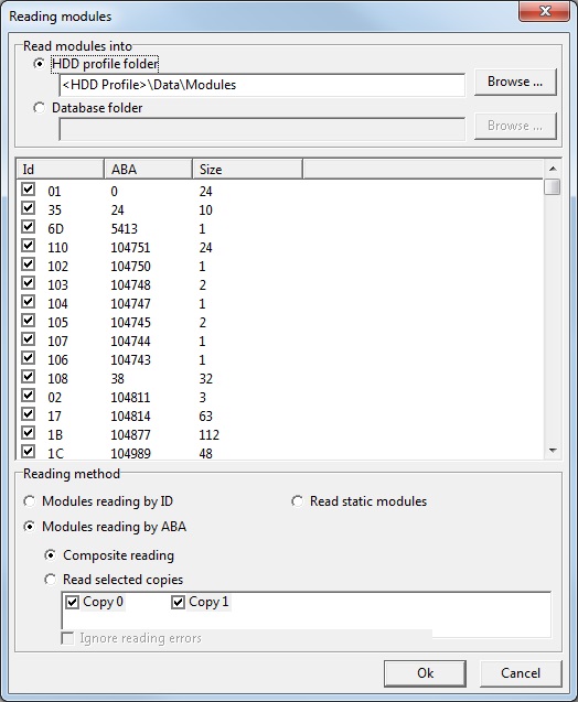

7. Save Service Area modules by ABA:

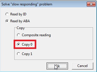

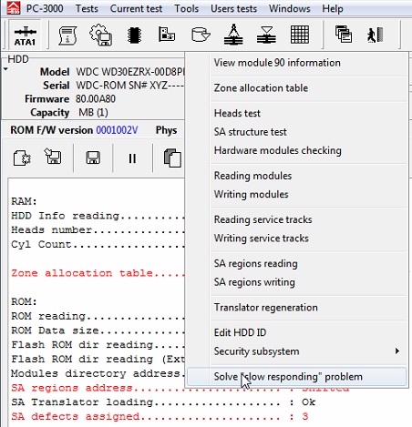

8. Follow Work with service area->Solve Slow responding problem, do it by ABA, by copy 0.

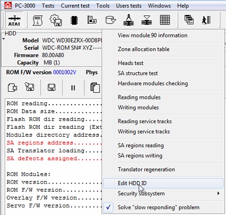

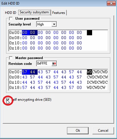

9. Follow Work with service area->Edit HDD ID,
go to Security subsystem tab, remove SED checkbox, press OK.
Do it by copy 0 only
10. Follow Work with ROM->SA regions editor->Allow SA access, press OK.

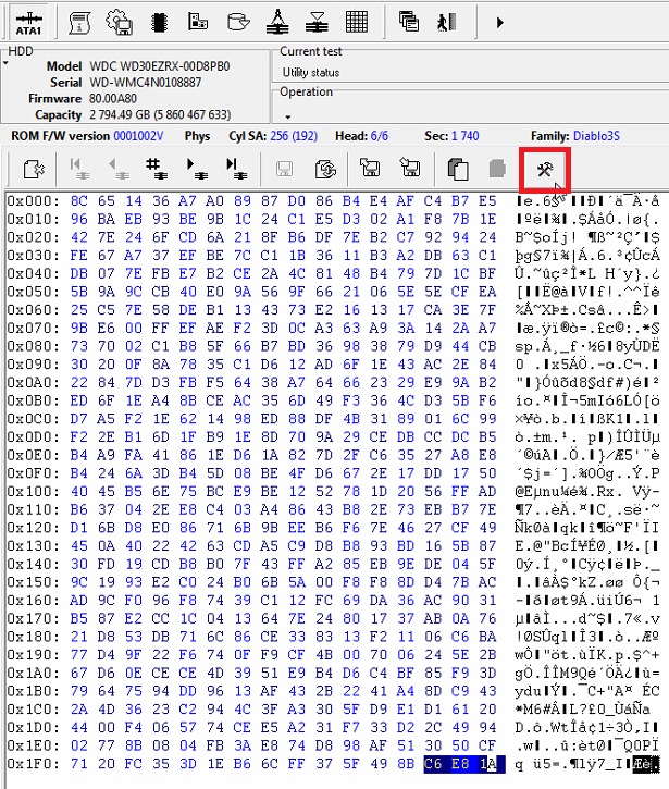

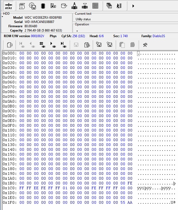

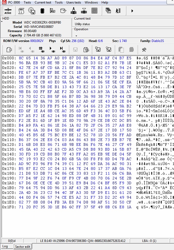

12. Open Tools->Sector edit. Data looks encrypted.

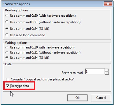

13. Follow Reading options
and set Decrypt data checkbox, press OK

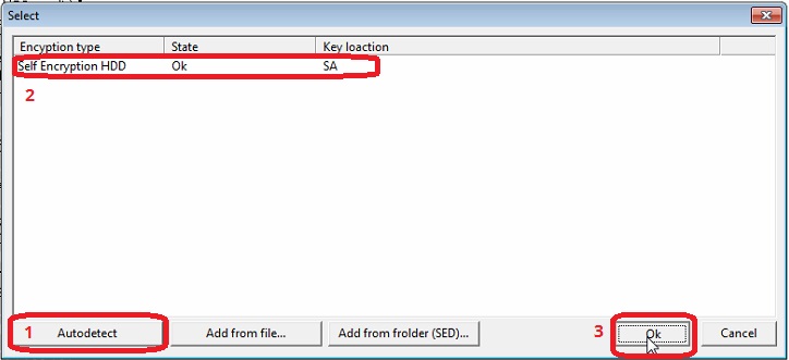

14. Autodetect the encryption type, choose Self encryption HDD and press OK.
15. Check if sectors are really decrypted in Sector edit.

I went through the procedure, which allowed me to save modules. When I chose to decrypt (in sector edit) it finds INIC3608
as the type, but "no key" under module 25. It alters the data in the selected sector (0), but it's not decrypted, just changed to some other encrypted-looking form. Starting a DE project as-is of course is also still unable to decrypt.

After 'upload DIR to RAM' there is a dialogue box about the regime changing, you have to select 'yes' here, then you can read SA modules over ID (no ABA will be available at this stage).

Reading sector 0 showed it looked encrypted.

drdoc wrote:Source of the post Reading sector 0 showed it looked encrypted.
With SED active, data will be decrypted by default. with SED disabled, decryption should be done via Self Encrypting Key found at drive - this can be done in the PC3000 / DE software.

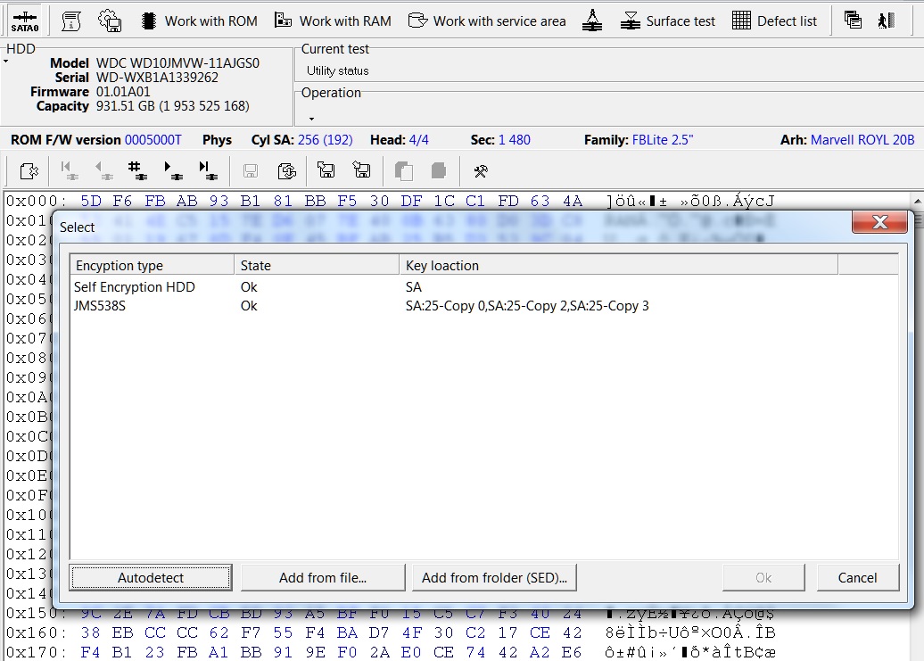

Question 1: However, there are a couple steps before Step 14 where PC3K ask to repower the drive. But you do not mention to repower. Do I assume ignore PC3K until you actually say 're-power' in your tutorial?
Question 2: At Step 14,, after clicking Auto-detect, I get 2 choices. (see attached picture). I can only choose 1 of these items. Either one does NOT decrypt the data. What to do at this stage? (I have repeated procedure twice, with no change.)
P.S.: I have the newest PC3K software: PC-3000 v5.9.21
P.S.2: There are 4 heads, 0, 2, and 3 test okay, but Head 1 has errors. Is this the reason for failed de-cryption (SED)?
