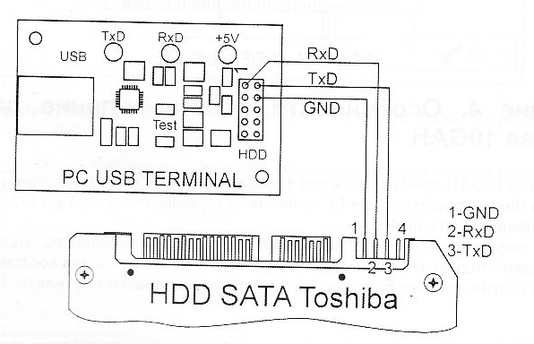

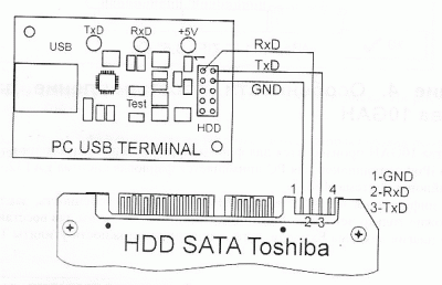

As far as you can see from latest PC-3000 UDMA 4.7 change log , current WDC Marvell usb utility supports com-port connection.
This could help to reach the SA modules on WD drive, when hard drive is not identified by operational system.
Here is the connection for WD USB 2.0 drive:
Hard drive has 6 pins in one row. So, PC-Toshiba adapter is connected, and three pins are left free. Please check the picture above.
Here is the connection for WD USB 3.0 drive
Hard drive has two rows of 6 pins. PC-TOSHIBA adapter has to be connected onto top row. The drive position has to be same, it is on picture.
As soon, as new manuals for PC-3000 WD USB utility will be ready, it will appear in personal update box, manuals Western Digital section.

Postby ACE_Admin » 18.08.11, 10:33
PC-Toshiba adapter scheme
