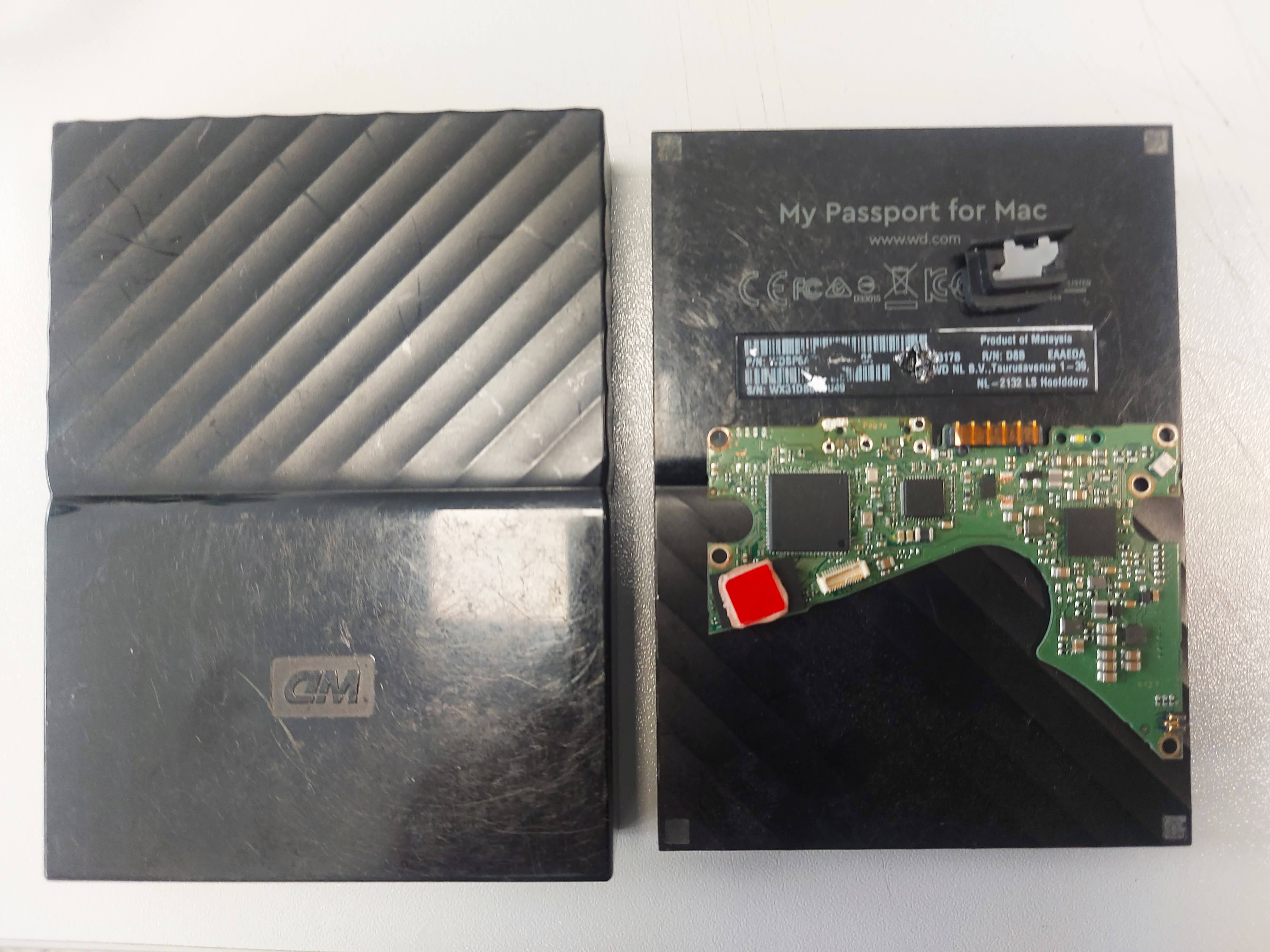

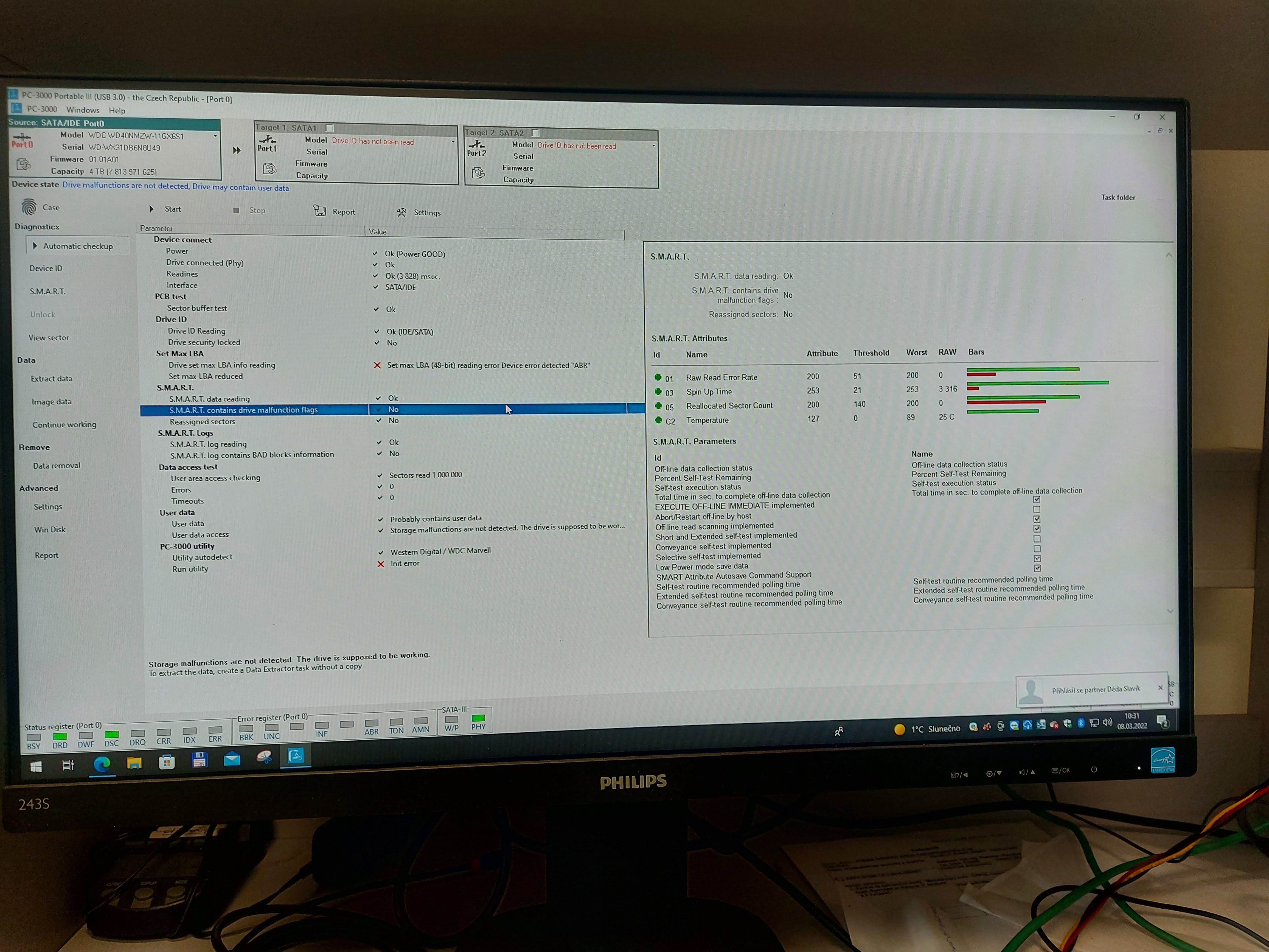

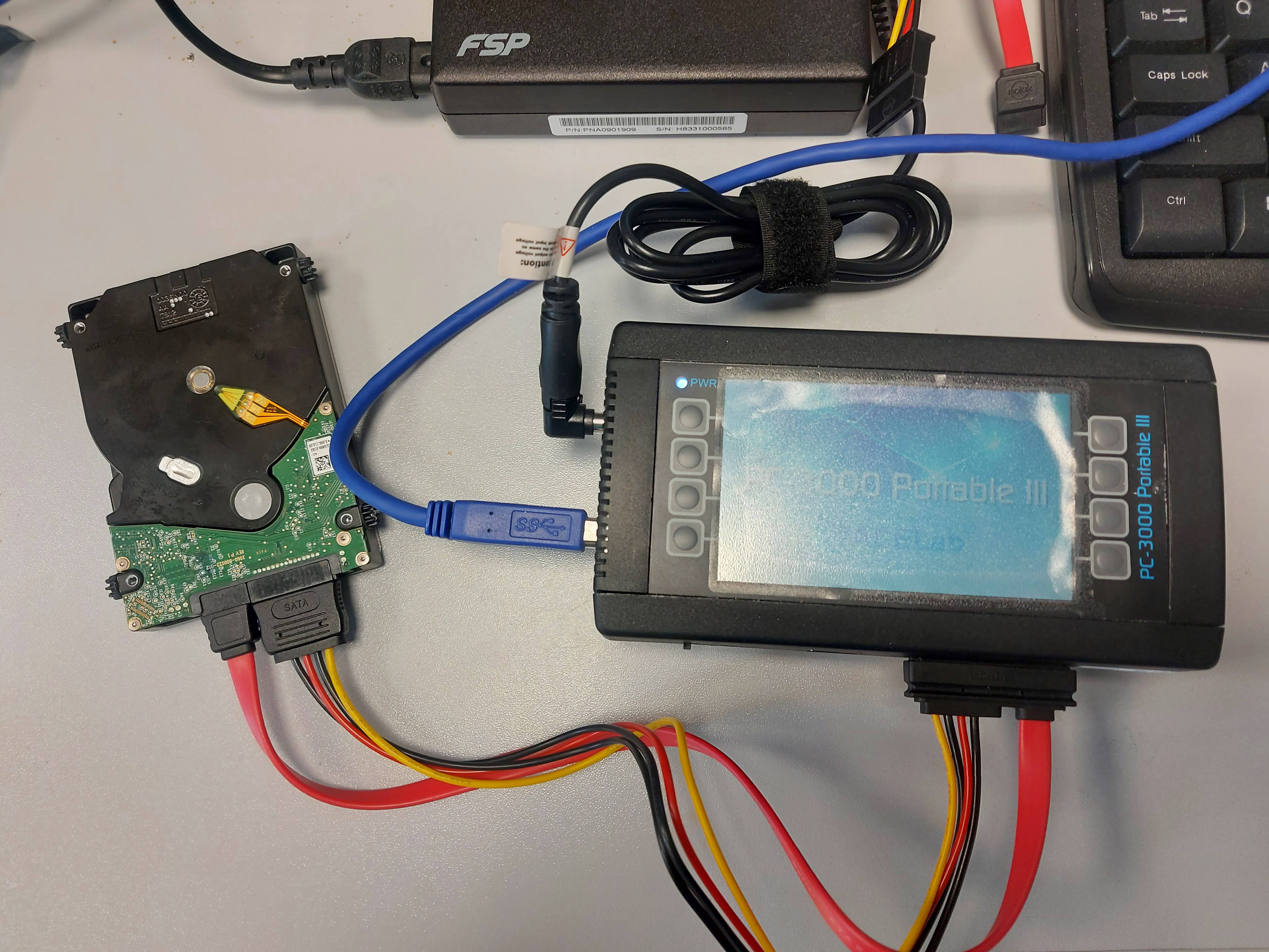

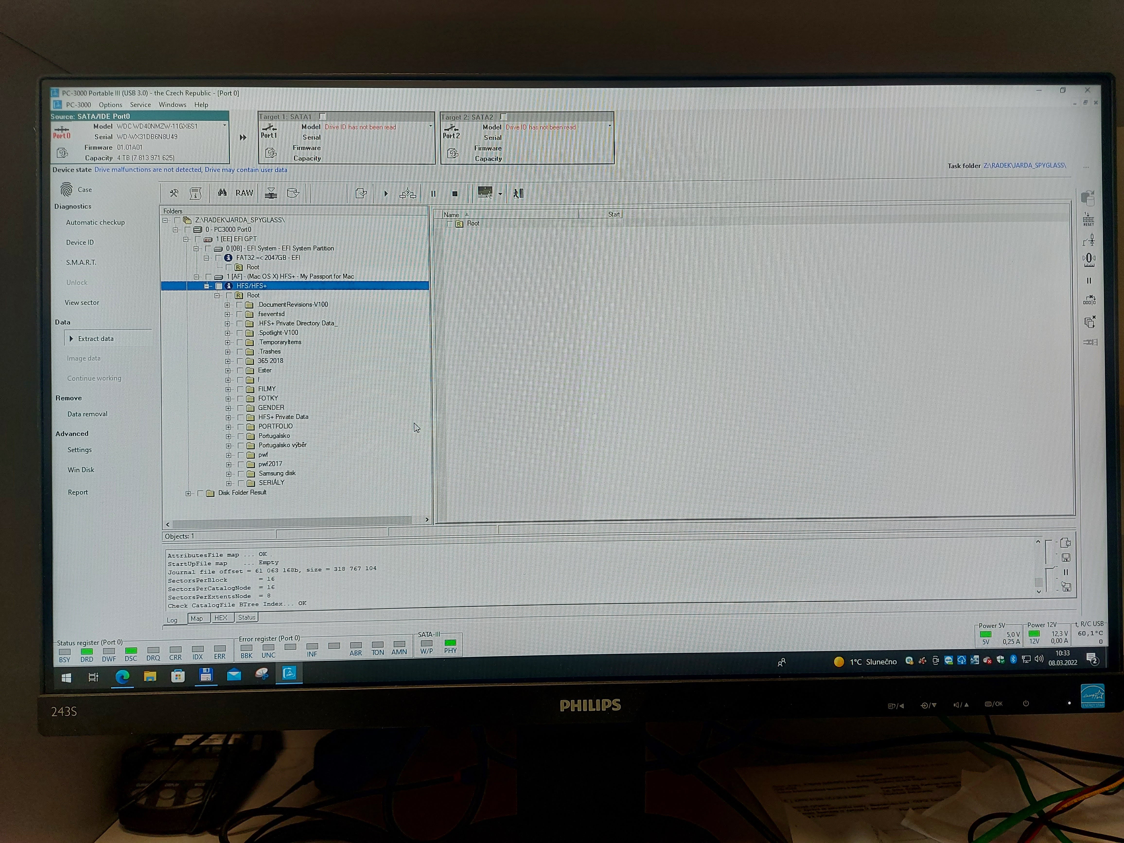

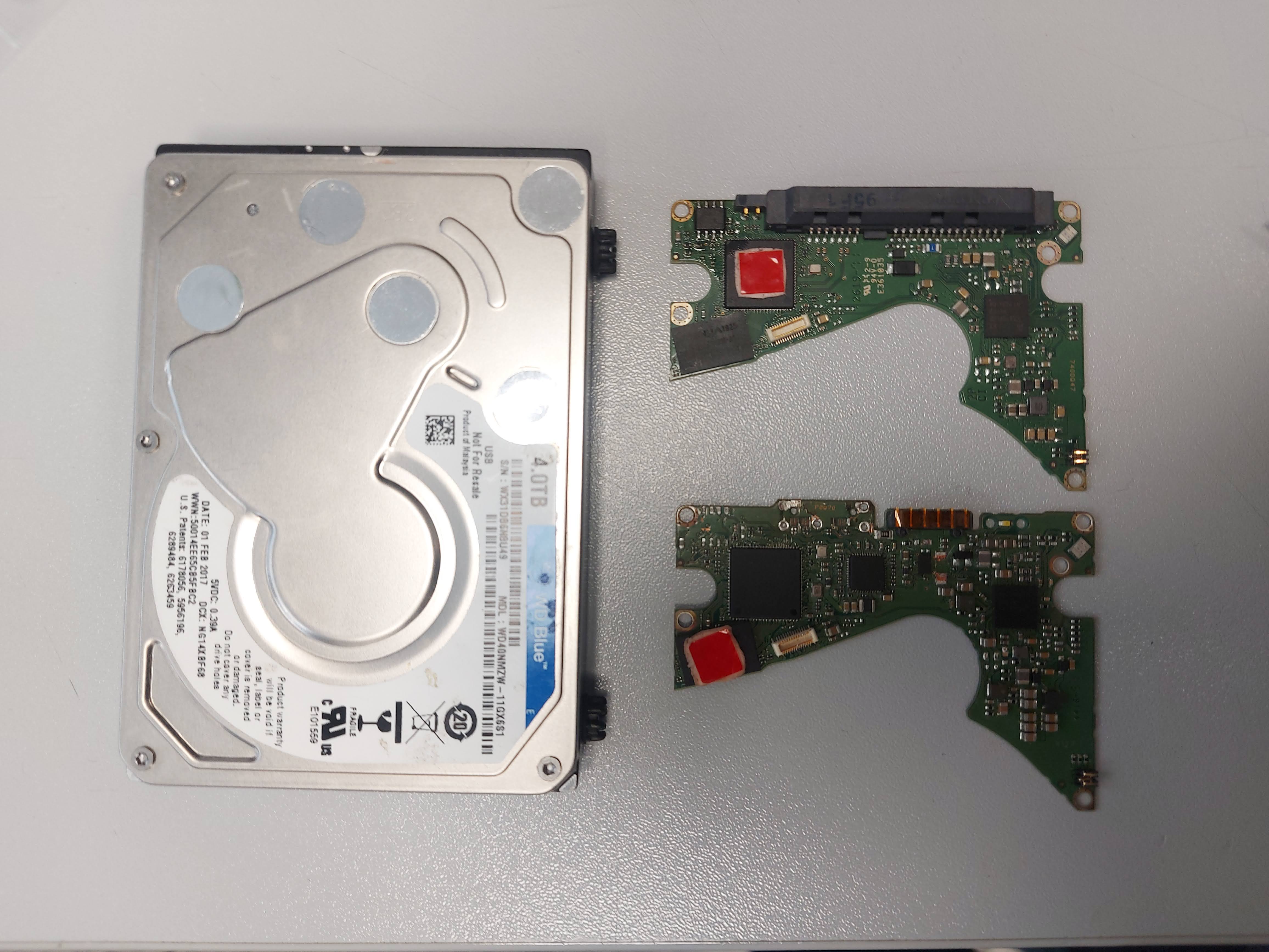

Hello, I had case 4TB WD MY PASSPORT - WD40NMZW-11GXS1. This drive had damaged PCB. This was Spyglass drive with active SED. Original USB board 2060-800041-003 was not usable. I choosed simple way to get data, use SATA compatible board and ROM chip swap. In my case, it was SATA board 2060-800022-002. Data were successful backuped.
This topic I created as inspiration for others...
