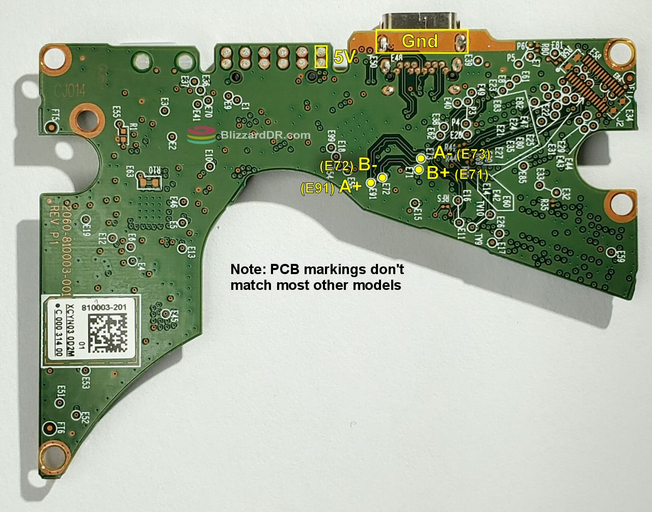

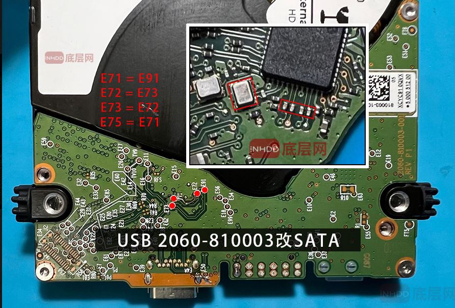

hello there i came across one page regarding "usb C to SATA" conversion by blizzard data for the PCB 2060-81003-001 REV P1 i believe the wiring is correct however i saw another post by chinese person were they did soldering on different PIN numbers so got confused..... do someone know which one is the correct? sorry im getting old

Both are correct and shows the same as i see it.
810003 has reversed connection sequence ( or has wrong pcb makings :shockable: )
