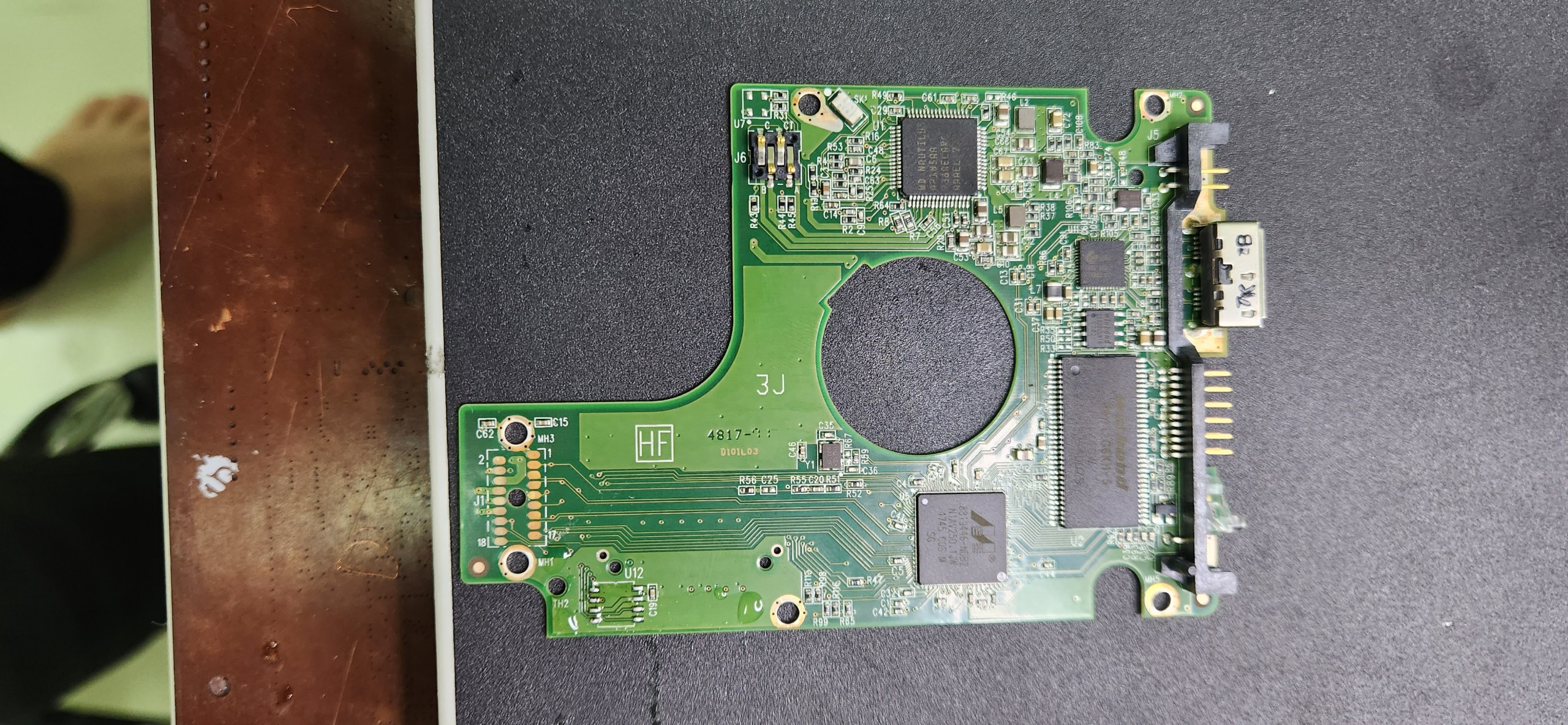

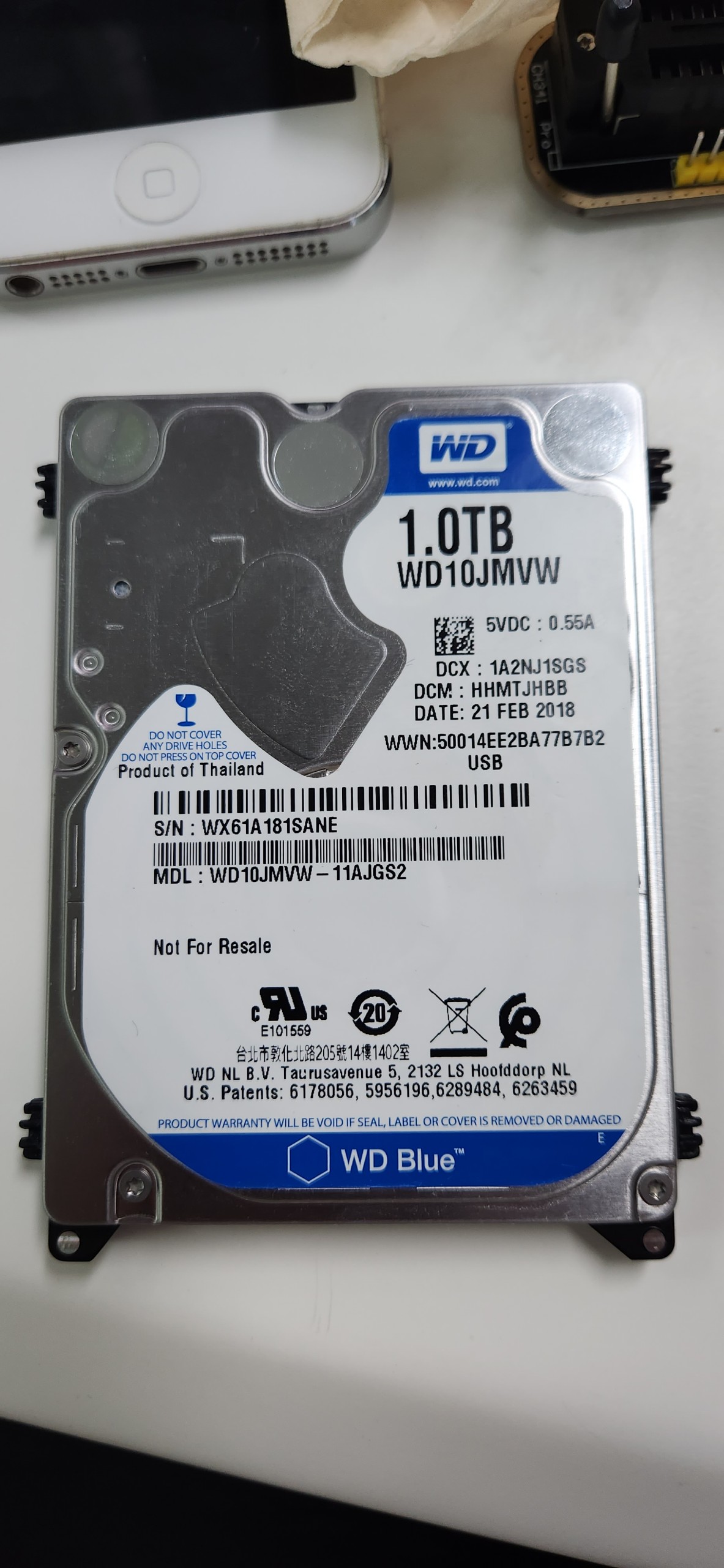

I have a WD Elements WD 1TB WD10JMVW. When it plugged through USB the drive is spinning fine however the lights on the usb drive flashing and the drive never got recognized

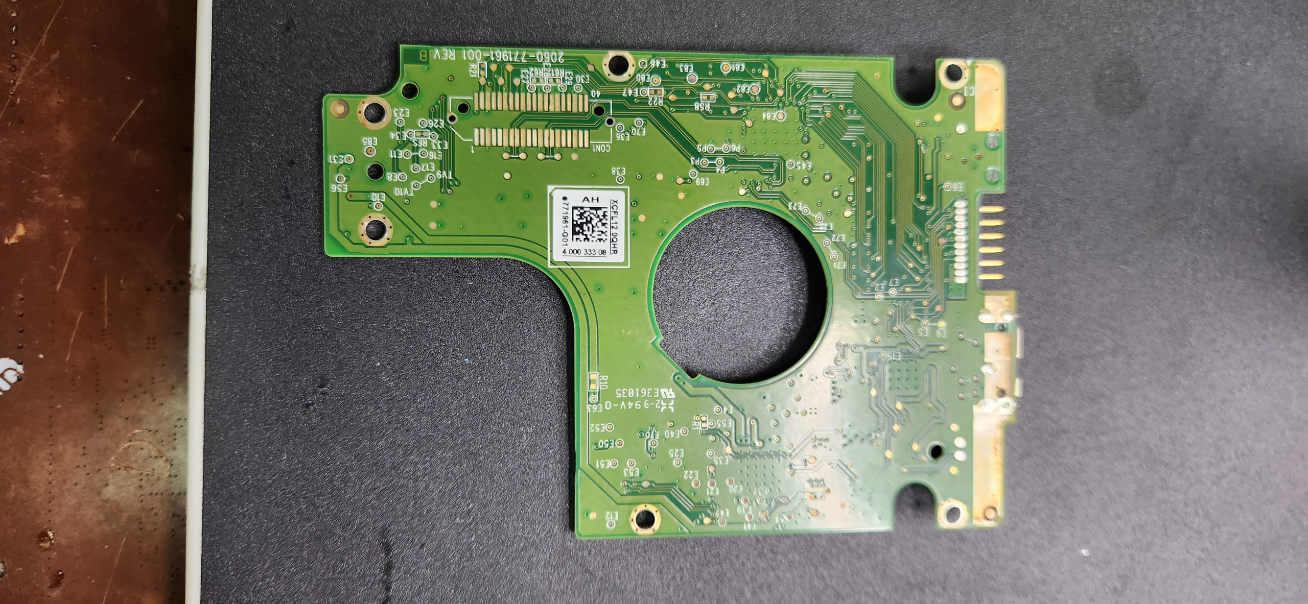

With the PCB 2060-771961-001 REV B

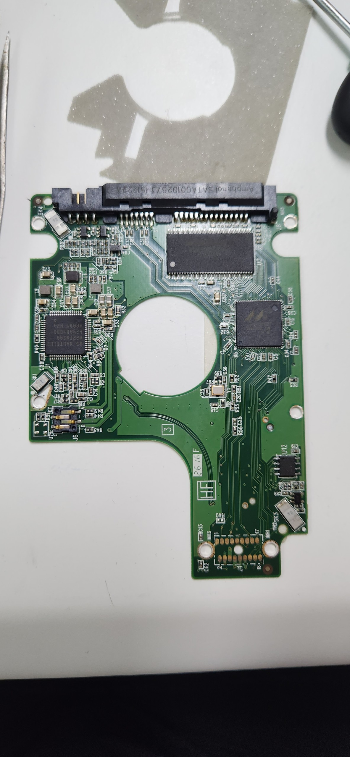

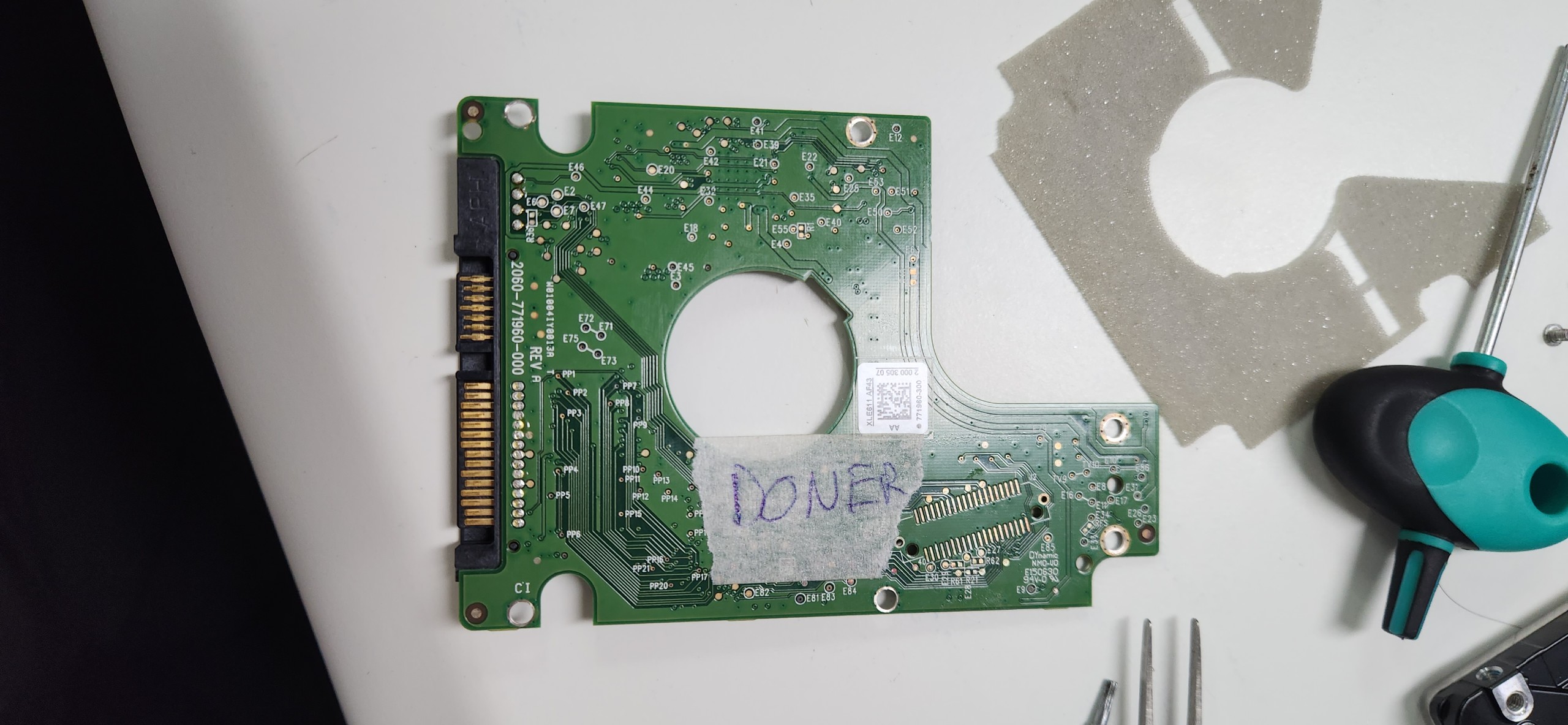

I swapped the PCB with the donor 2060-771960-000 REV A. Swapped the BIOS also
I have looked through the PCB Compatibility before swapping the PCB over. So in theory it should be working
