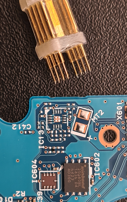

Yes, you can physically transfer the ROM chip from one PCB to the other, that is the correct SATA PCB for your drive. However, that's not the method I'd recommend. The location of the ROM chip is really close to other circuitry and it's extremely easy to ruin these PCBs just from applying the heat necessary to remove the ROM.
What I always do is to just remove the ROM chip from the failed PCB, read it in an external programmer, then write the ROM code to the working drive through the PC-3000 utility. This way I'm not ruining good PCBs in the process.

Can recommend REVELPROG-IS as external programmer, with the right testclips you can do in system read / write without soldering.

Re: Rom Transfer from WD40NMZW-11GX6S1
digitalsupport, you wrote: " with the right testclips you can do in system read / write"
What do you mean by testclips? Is the programmer not ready to go as it?
osity wrote:Source of the post digitalsupport, you wrote: " with the right testclips you can do in system read / write"
Sure - programmer is ready to go. But I preferer to read and write ROM on PCB with SOIC 8 pogo clips
