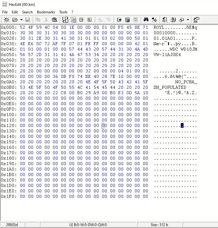

d1d
Posts: 54
Joined: 15.09.18
Re: WD10JMVW-11AJGS4 USB HDD Recovery
Postby d1d » 16.03.21, 16:48
So i can save the Rom and all Moduls whitout the Modul 30 Translator....
The Moduls and the Rom locks good in Hex...
As Example Modul 0D in Attachments.
Best wishes Luigi
Maxim_TS
Posts: 344
Joined: 27.03.13
Reputation: 18 / (175)
Postby Maxim_TS » 18.03.21, 13:09
Looks like ROM module 30 is damaged. Try to write it from the same ROM FW version donor backup.
