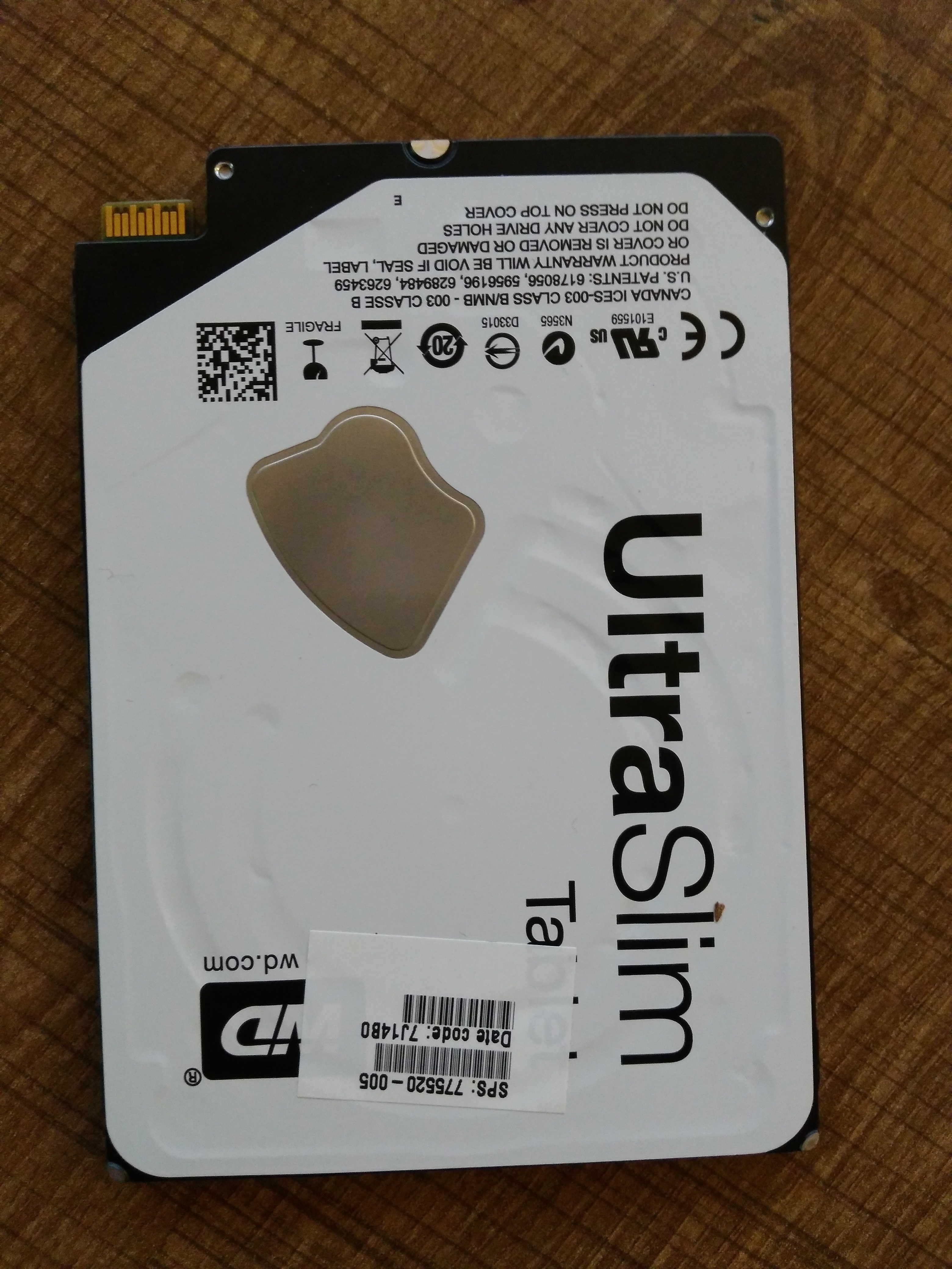

WD5000M21K MODEL SSD HYBRID DISK
Postby bayerecep » 07.11.17, 17:59
I have wd5000m21k model HYBRID disk,
How to sata connection?

Postby thatdellguy » 07.11.17, 18:18
Either solder on a SATA connector or buy the adapter.
https://www.ebay.com/itm/Sintech-WD-Blu ... xyi-ZTZ0FJ

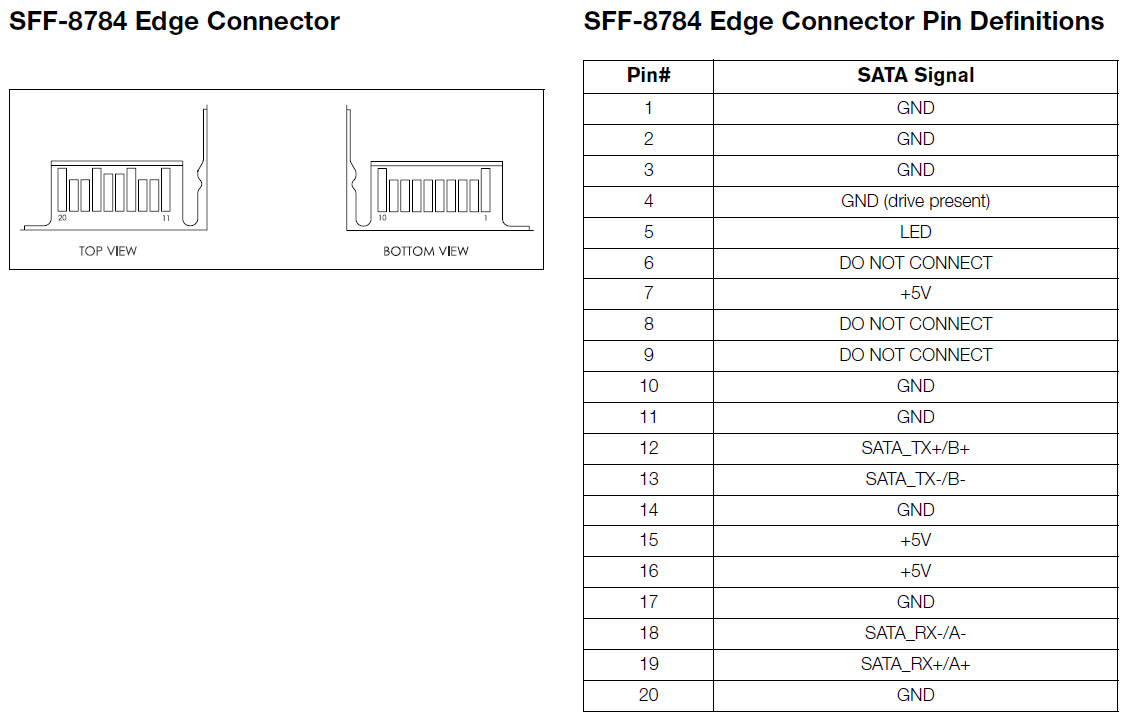

Postby bayerecep » 07.11.17, 19:19
thank you #thatdellguy
so, do you know about connection points?

Postby thatdellguy » 07.11.17, 19:48
Its easier to buy the adapter.
