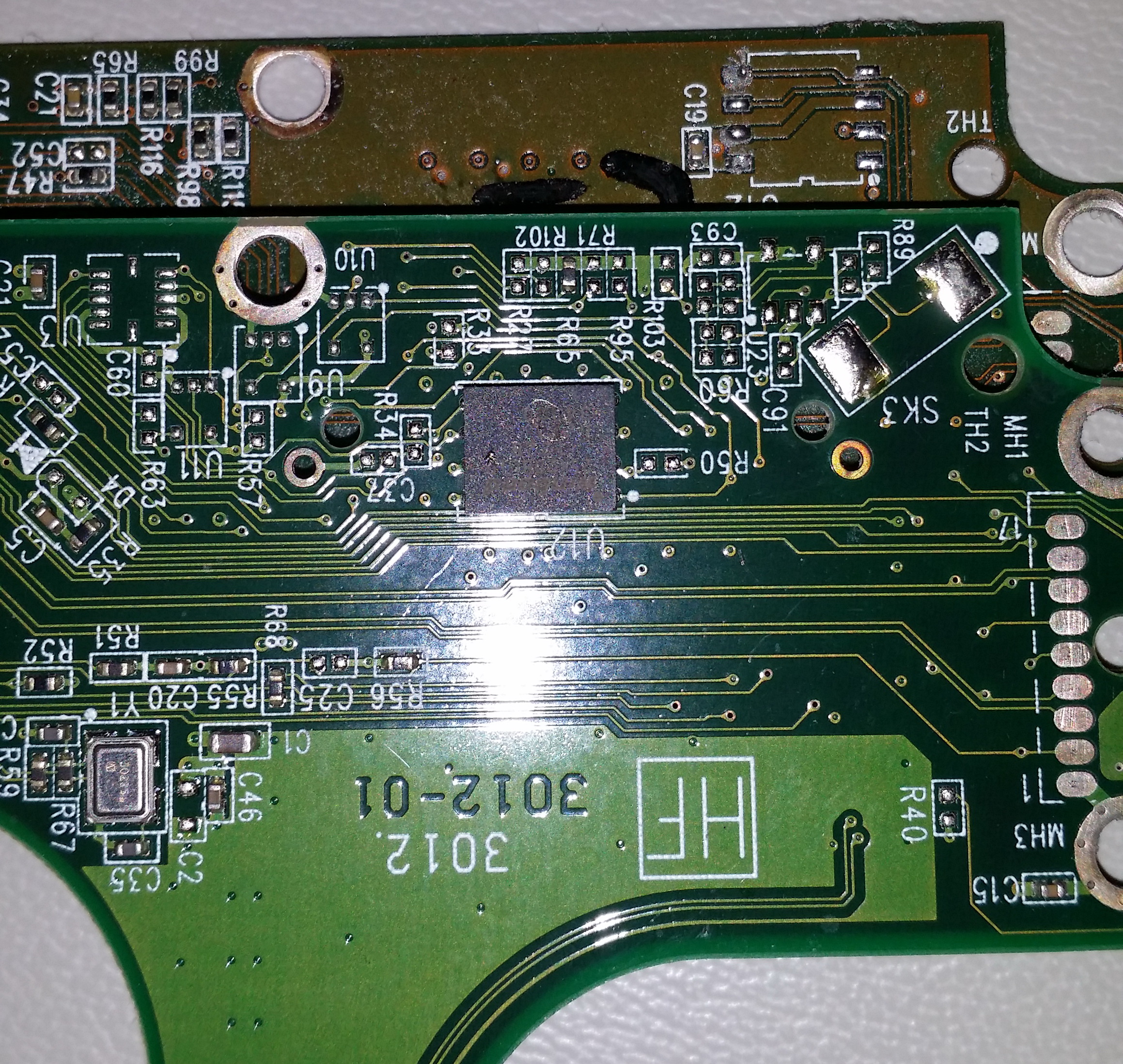

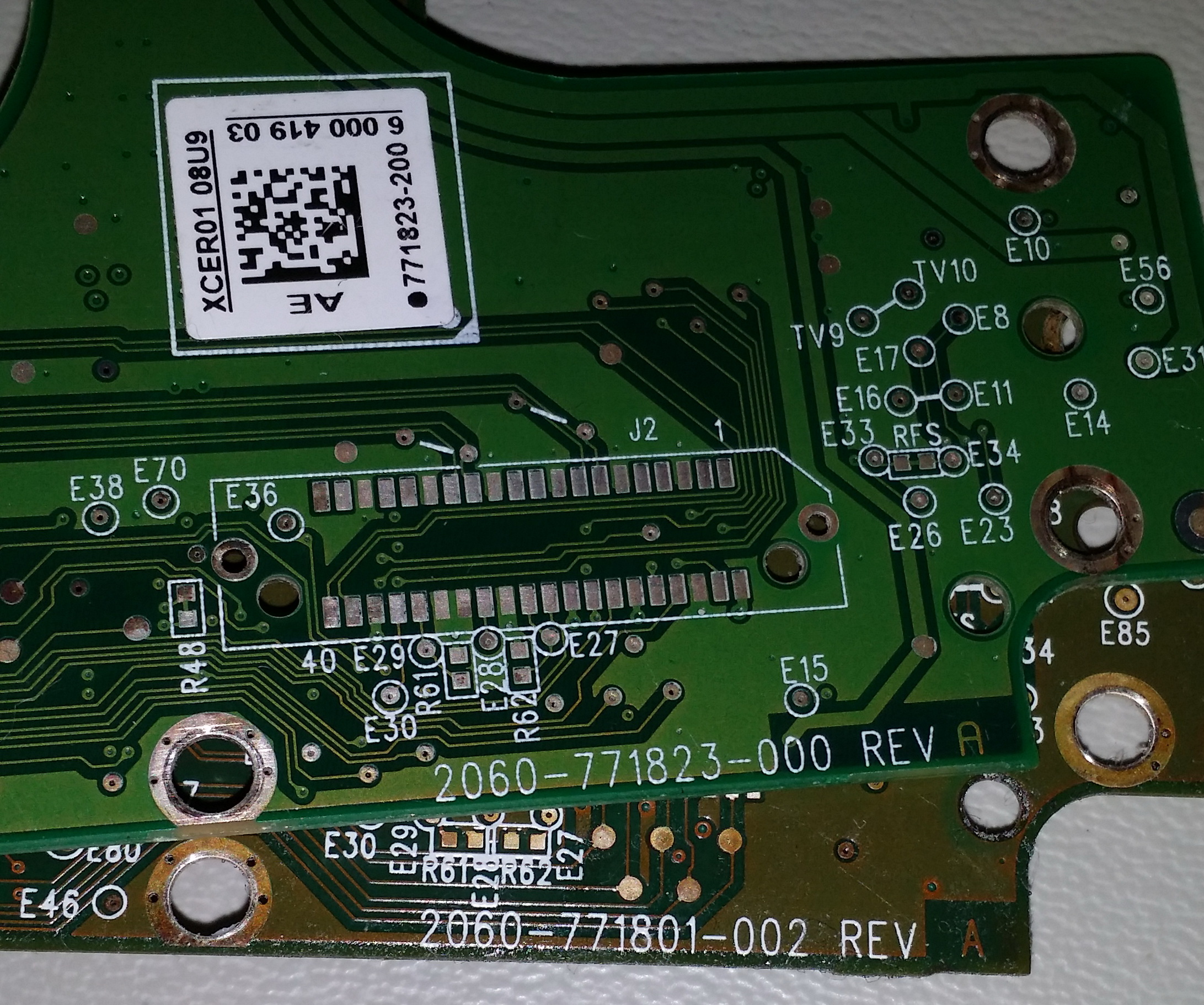

Hi, I wish to recover the USB3.0 WD Passport having controller "771801".
According to the information is this sub-category, the matching SATA controller is 771823.
However, as seen from the attached pictures, the ROM chip, U12, is different physically -- the
newer, 771823 controller has the solder legs Under the U12 chip but the Patient controller,
771801 has regular solder legs.
- I think they refer to the newer legs-under ROM chip as an "SMT" (surface-mount) chip.
Anyway, SMT's are no fun to work with regular soldering tools, plus I can't be sure the legs/pinouts match.
Point is, I can foresee a whole lot of work leading to disappointment.
So, this is where transferring the ROM digitally through PC3000 would/should be ideal. However, a new
problem is the controller cards do not come ready on PC3K (not even Kernel Mode), so this normal ROM-
transfer procedure on PC3K won't work.
Does anyone know how to transfer that ROM digitally? Another solution? (probably solder a SATA conn. to the USB, right?)
Transfer ROM 771801 --> 771823?
