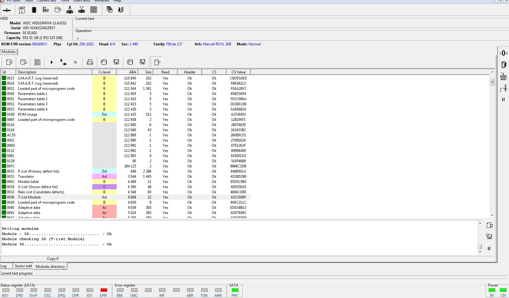

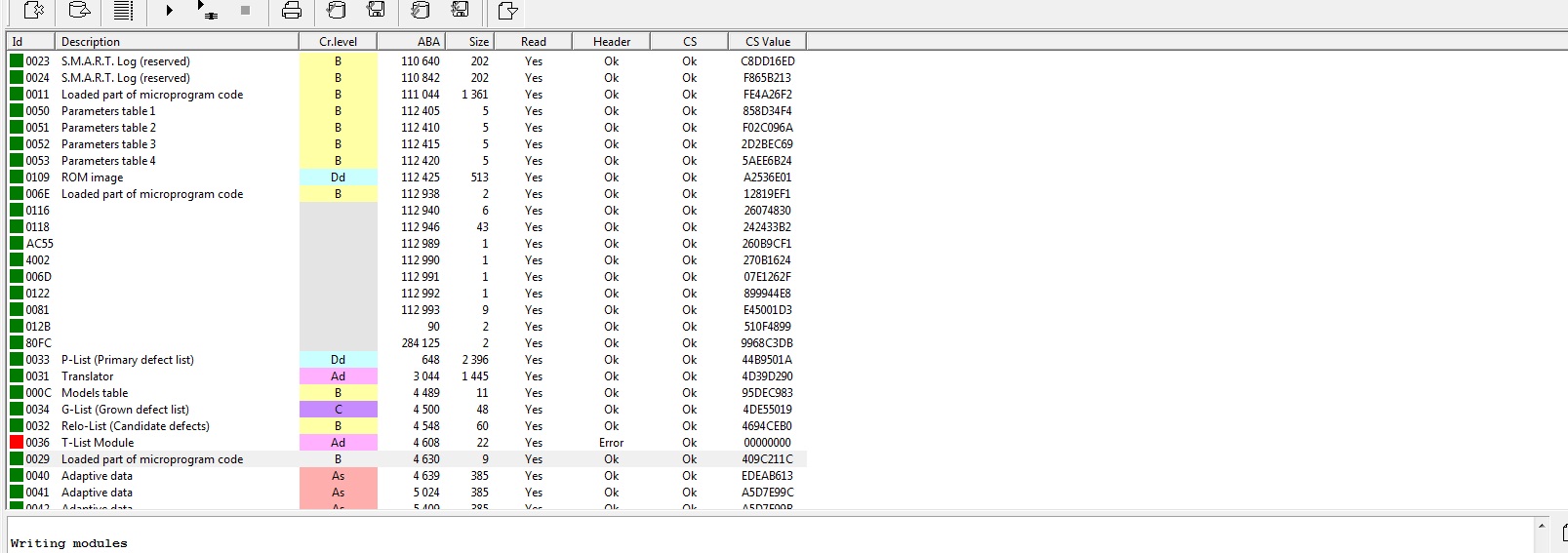

i have problem module 36 i cant access sector

Try changing which copy you are reading from when you're checking the modules. Likely one of the two copies is bad. Also, please beware that you can't replace that module with a donor one. Needs to be from the actual drive.

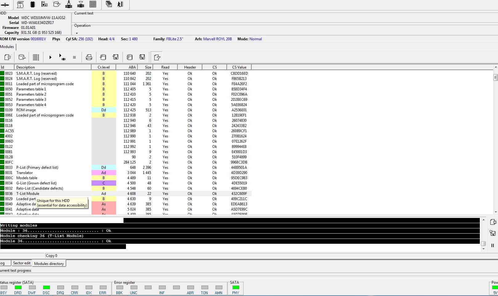

DataMedics wrote:Source of the post Try changing which copy you are reading from when you're checking the modules. Likely one of the two copies is bad. Also, please beware that you can't replace that module with a donor one. Needs to be from the actual drive.
Well,
This fellow has posted in multiple forums and Facebook pages etc etc ,He is doing it all wrong ,He should have read copy 0 and 1 initially in composite mode got the intact T List ,Then relocated the module position and write back the T-List .If still not working recalculate Checksum and voila
