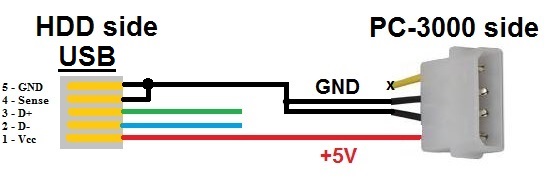

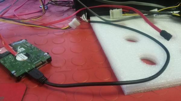

USB reading/writing mode have a lot of restrictions and as result a lot of options are not available.
But if you need just to switch on|off power supply via USB..
I think that better to save a money: :wink:
