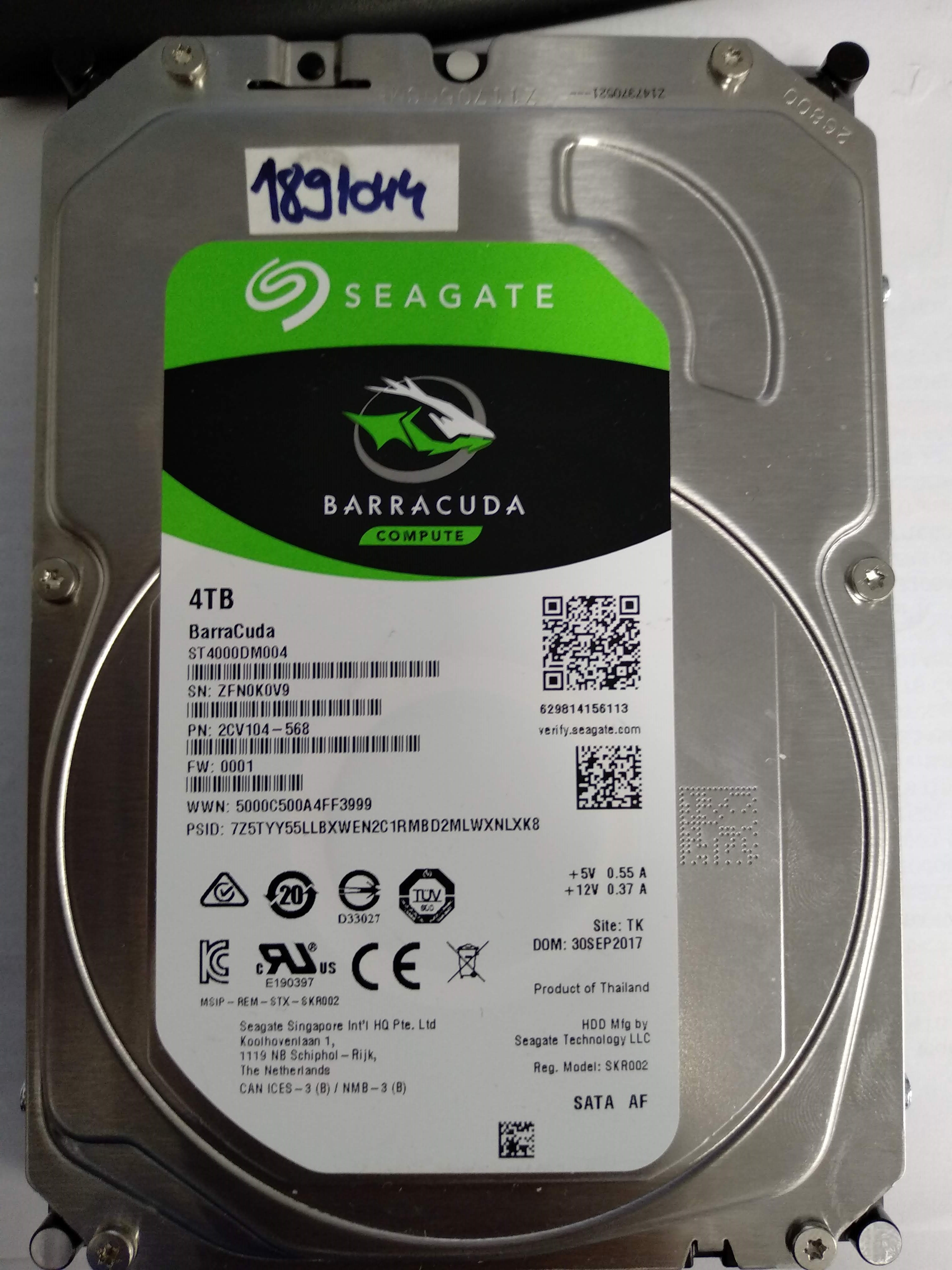

In first look like standard PCB issue, the drive was dead, without any signs of life
. When PCB was changed with donor one (of course with rom swap) nothing changed, the drive stays dead. So the next step was trying with orig PCB but with donor rom chip and that bring life to the drive, he spins, get ready status but can't load properly. So next few hours I play with rom chip and his content. I didn't notice any problem with the rom chip I can read the content, erased it, and programming it without any error or corruption. So I'm not sure how can only rom content be corrupted here, the logical conclusion was that somebody messed up with the content of original rom?

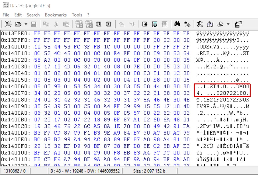

Well, the messed up model number in ROM does suggest a problem with it:
Possibly could be sabotage, or it might just be a bad read of the ROM. However, now that you've written over the ROM (something you never should have tried) there's no going back to attempt re-reading it.
Personally I always make two backups of a ROM before I even do something as small as modify headmap. Just in case you get a bad read (which has happened to me a couple times).

I don't think that is from bad reading ROM, I read it twice and compare the content (both ROMs were identical). Definitely is some sabotage, I will see how much time do I have to play with it.

That actually looks normal for ST4000DM004-2CV104 ROM. You can see model at address 1580E0 and serial at 158000.DataMedics wrote:Source of the post Well, the messed up model number in ROM does suggest a problem with it:

I upload original ROM from PCB and it is read twice (to confirm reading is ok). Data in ROM, regarding model and serial, are checked and look OK. Are you sure that you see same ROM (with the same model and sn ?) available for download somewhere else?
Re: Seagate ST4000DM004 ROM corruption ?
Yes, I'm sure. Only 4 bytes different. Check your PM.Miodrag wrote:Source of the post ...Are you sure that you see same ROM (with the same model and sn ?) available for download somewhere else?
One of the ROM parts is corrupted but it's not the one with model or serial number
