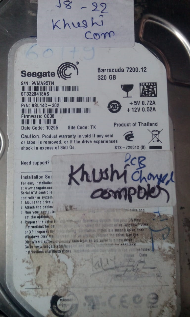

I have one Seagate 320 GB Barracuda 7200.12 (F3 Arch. Pharoh) hard disk drive.
S/n: 9vma95tn
P/n: 9sl14c-302
FW: cc38
Date Code: 10295
Site code : TK
The hard drive is not detected.
and the Hard drive original pcb(ROM) is lost. So customer has no native (original PCB)
is it possible to recover the data from not native pcb hdd? why/How?
I have attached the photos of the hard drive.
Thanks,

i'm no way. anyone have solution.??
I have been successful with a pair of HDD twins. They are had date code the same day. After replacing the rom, translation . it can read data . But it's hard to find a donor HDD same Date code :D
