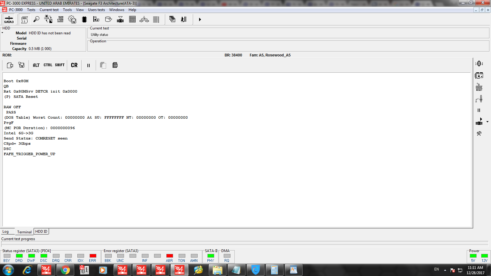

Hi Dears ,
the rosewood drive ABR detected and hasnt any ID and I cant write sys files via ATA(direct or indirect) and terminal after unlock, please give me a solution ,
thanks a lot

The status register shows DWF flag - this is common symptom of damage to MC and often this error is presented during attempts to work over ATA.
You need to work over terminal only - save important modules including translator, clear translator which will rebuild MC, restore translation system via the backup taken before the translator regeneration.

Correct my advise to him would be reach terminal and then check defect list he will note its overfull with defects he needs to clear it in terminal ,Then reach c level and work with MC and Also Reach level 7 and work with dos config level clear it .
PS : in few cases i have seen you cannot take a backup of anything until you do this :D
