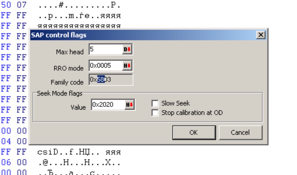

This probably happened because you wrote the wrong using "common" family or the wrong family. Next time, find the family code in ROM after reading, then re-enter utility using that family, then write ROM and it will succeed.

How to identify family code from rom?

Postby 300ddr » 03.10.17, 18:34
Open ROM, click SAP button, see highlighted characters in this pic: https://www.dropbox.com/s/9js00pwtecyltxs/sap.jpg?dl=0

Here ya go Larry.
Note: latest versions of PC3K show the name of the family now -- next to the family code.
