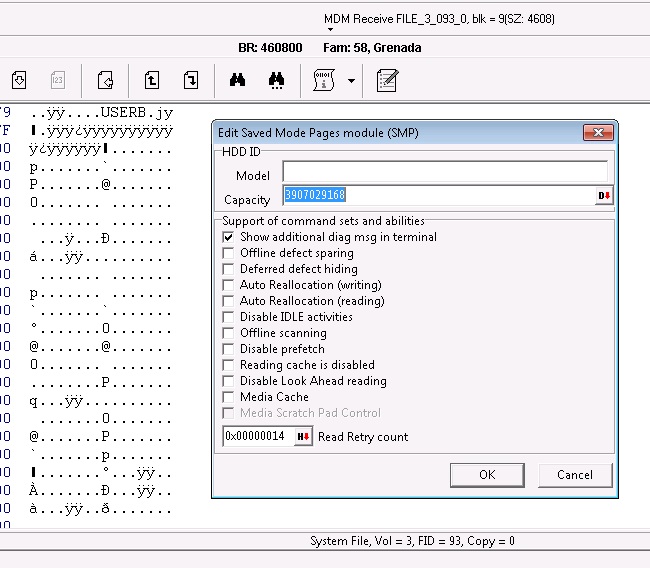

SMP page (93) made modification as described.
but hdd hangs on BUSY

Did you recheck system file 93 to be sure it actually wrote the changes? You'll probably need to write it via terminal.
- vaidis1973
- Posts: 26
- Joined: 11.04.12
- Reputation: 2 / (16)
Re: Seagate ST2000DM001 Busy
i can access only via terminal. Sata BUSY. Yes recheck.
- vaidis1973
- Posts: 26
- Joined: 11.04.12
Vol=4, FID= 93, Copy =0 , write Ok, after restart only junk.....
93 sys file is via Vol=3.
What about all other sys files? Did you fixed them all and after relaunching power supply Ctrl+X report with out errors?
vaidis1973 wrote:Source of the post Vol=4, FID= 93, Copy =0 , write Ok,
- vaidis1973
- Posts: 26
- Joined: 11.04.12
vol=3, 93 sys file both copy 0 and 1 , ok. Bad Vol=4 fid=93
Yes i fixed all 93 sys files, and was also bad 17A file. LBA B 000000040557 map to 17A .
After repair and relaunching power supply, Ctrl+X report without error, but hdd report SIM Error 5000 LBA 000000000002C0F5 FD 3811611F
RW Error 43110081. And HDD be BUSY,
If LBA 2C0F5 map to sys file , then show Vol=3 fid=1B, 1C and 1D. 1B is P=list, but this list i can read without error. With command show too.
