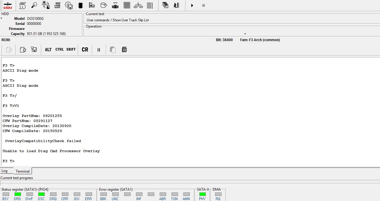

Hi , Amarbir
drive capacity shows correct serial no 0000000,wrong model , no fw version
no terminal access i tried shorting process then got terminal access
i tried smart , i tried nrg list ,i tried translator recovery & and tranlator regenrator
no result
thats why i need to uplaod LDR
Pavan
no result
Pavan

if i give a V1 command i got error

Hmmm.... just a guess here, but was that drive at another company before it came to you? Looks suspect.
Re: PLS SHARE LDR FOR ST1000DM003 FW:CC43
ROM edited, most probably...

hi
actually its a refurbished seagate drive .

CS DATA RECOVERY wrote:Source of the post hi
Ah! that's probably why it's so screwed up. Who knows what they did to "refurbish" it. Those tend to be nightmares.

yes u write fake serial no fw i return the drive .
Thanks for sharing Data Medics
