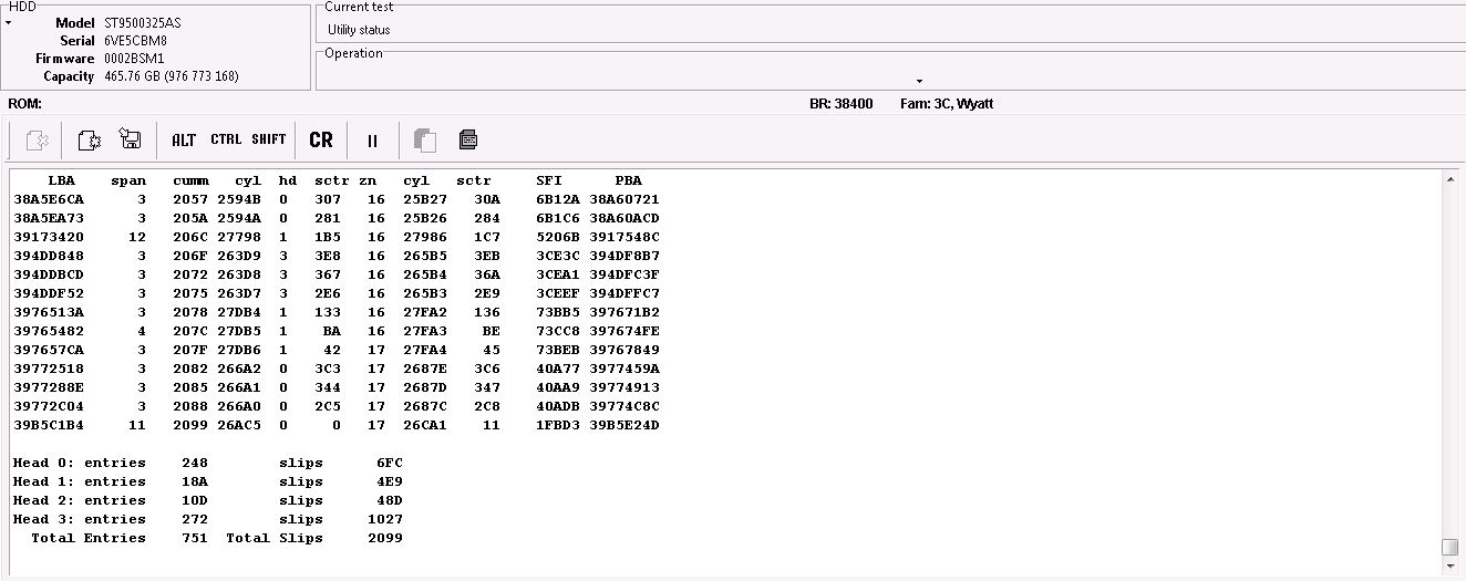

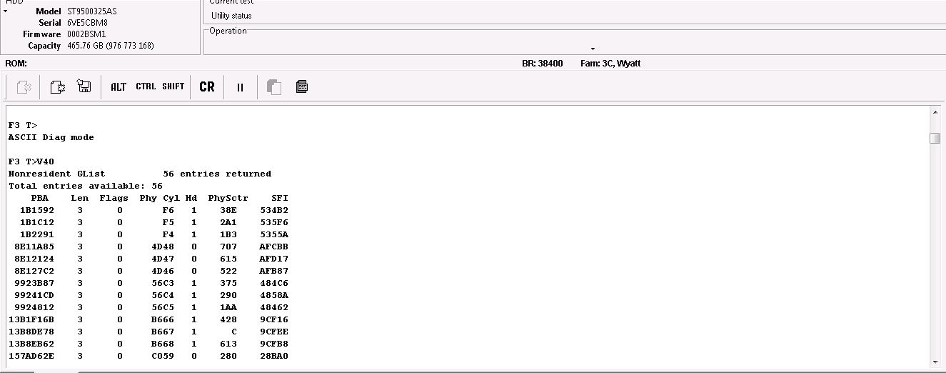

Hi Dmitry , Filipp & all guys

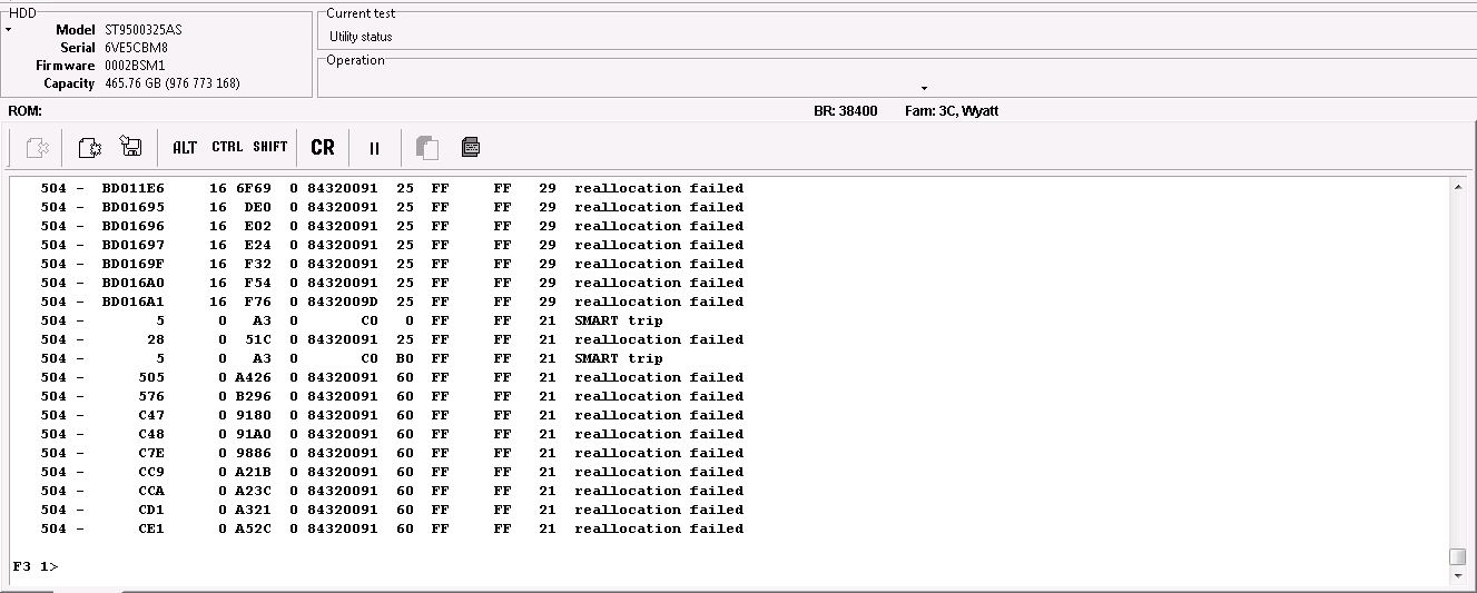

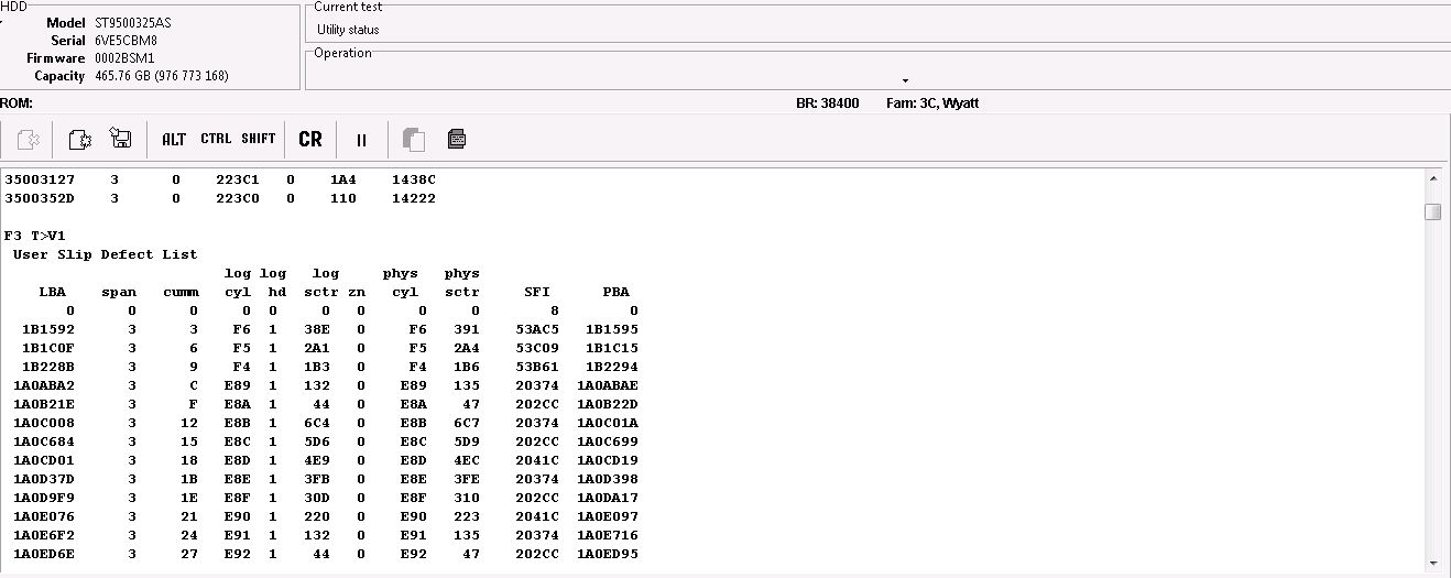

I would like to know how Pro's will recover data from this typical Seagate F3 case ( Smart trip/ Reallocation Failed / BGMS dos Rewrite)
So far I use to do following which I think is not correct ,one senior member has advised not to use M command too often nor to erase defect list directly ( erase from modules)
What steps will be most safe and appropriate ?
Attached are snapshots of Terminal output.
Thank you.
user track defect list.JPG (98.81 KiB) Viewed 8293 times
user track defect lis1t.JPG (108.74 KiB) Viewed 8293 times

There is so much confusion about right technique.
One said to clear Non resident Glist , clear smart and reg. translator
other says ny clearing non resident Glist hidden defects are also cleared , and this will create more trouble.
what to do ?

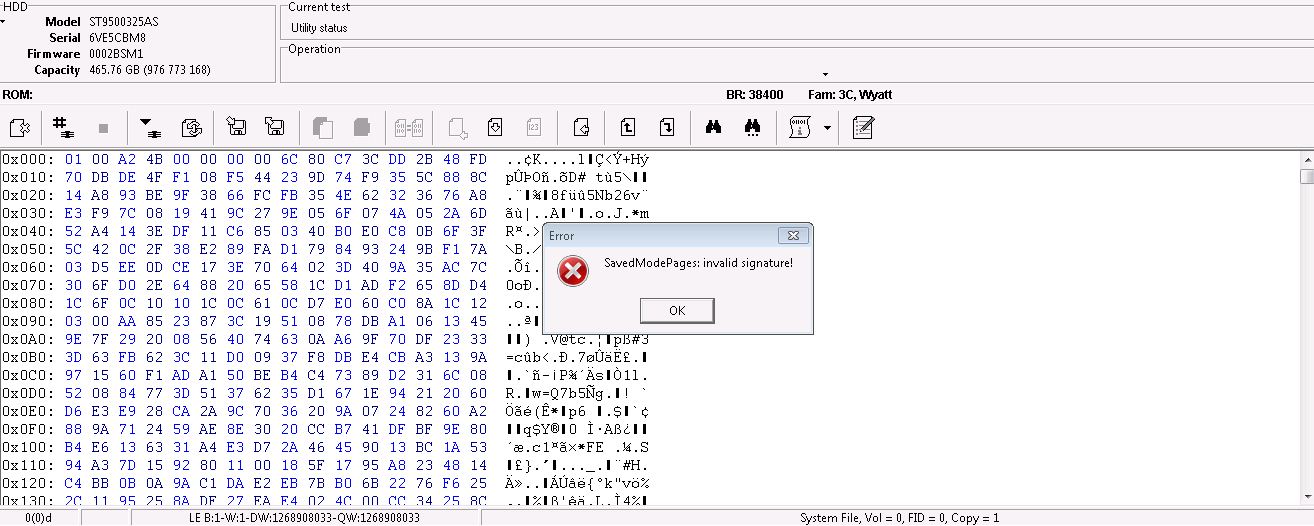

I tried to clear flags in SMP but getting error.

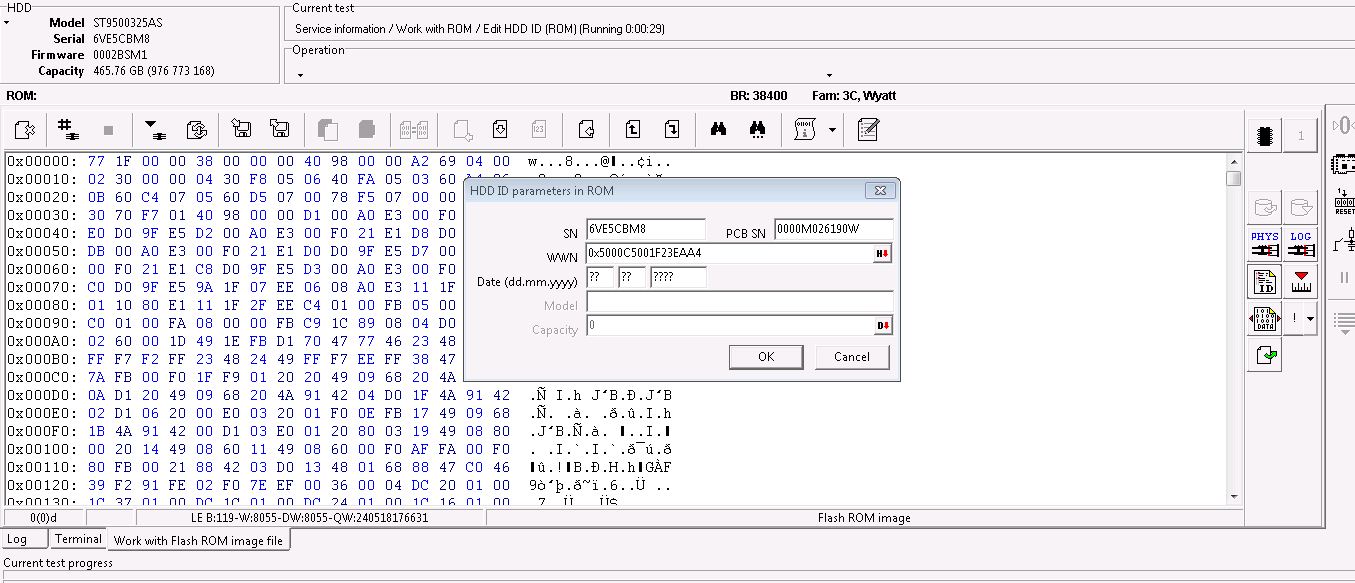

HDD ID parameters in Rom also does not show hard disk model no and size

Athena, usually we clear Non-resident G-List and Alt-list if we see too much defects inside, then we regenerate the translator.
But it works not in each case? and we need to check the other important system files.
If you have a doubts, contact us in ts.acelab.eu.com for remote help.
