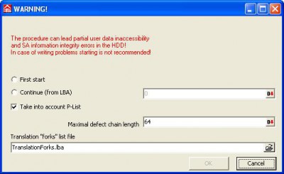

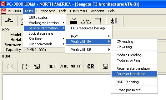

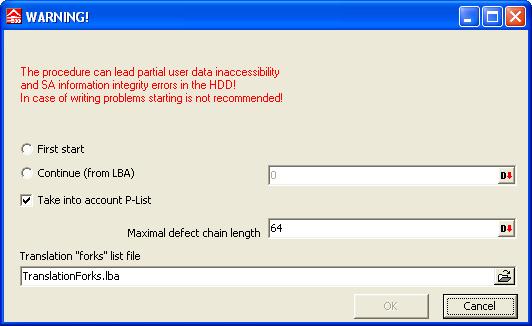

First.
Full automatic solution. You should launch option that is shown on the picture below
Recover translator.JPG (31.83 KiB) Viewed 53299 times
Then you will see window where you can select "First start" of procedure or "Continue from LBA".
If you know that P list is damaged you should unmark "Take into account P-list"
So if you launch this solution first time and suppose that P list is OK you should just press on the "OK" button and wait till end of procedure.
It may take long time.
Second.

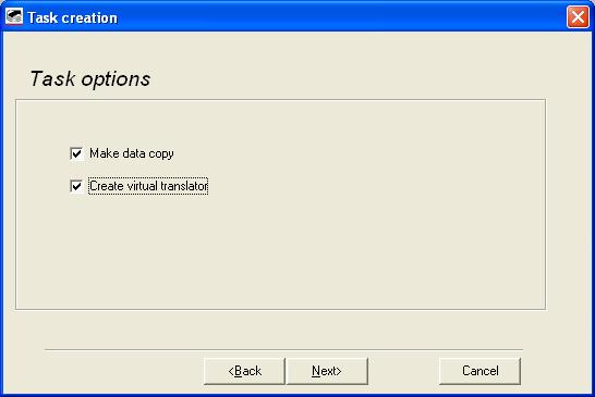

Task in DE.
If you want to use this solution you should create task in DE in mode "Create virtual translator" (and "make data copy" of course).
Task creation.JPG (15.67 KiB) Viewed 53299 times

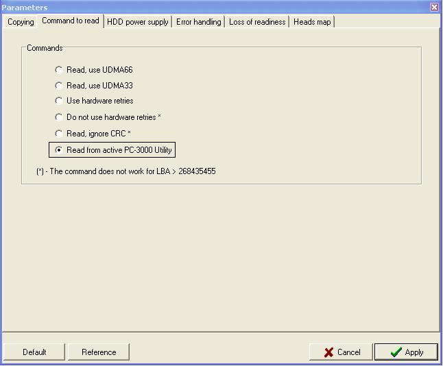

Then you should select reading mode "Read from active utility"
In this mode reading will be slowly than in UDMA mode. But you will get full image of disk with shifts.

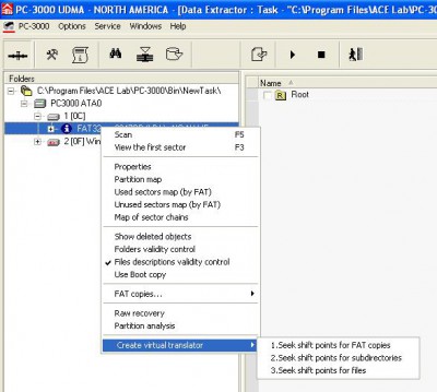

Then you should create virtual translator via menu of DE.
Create virtual translator.JPG (34.71 KiB) Viewed 53299 times
