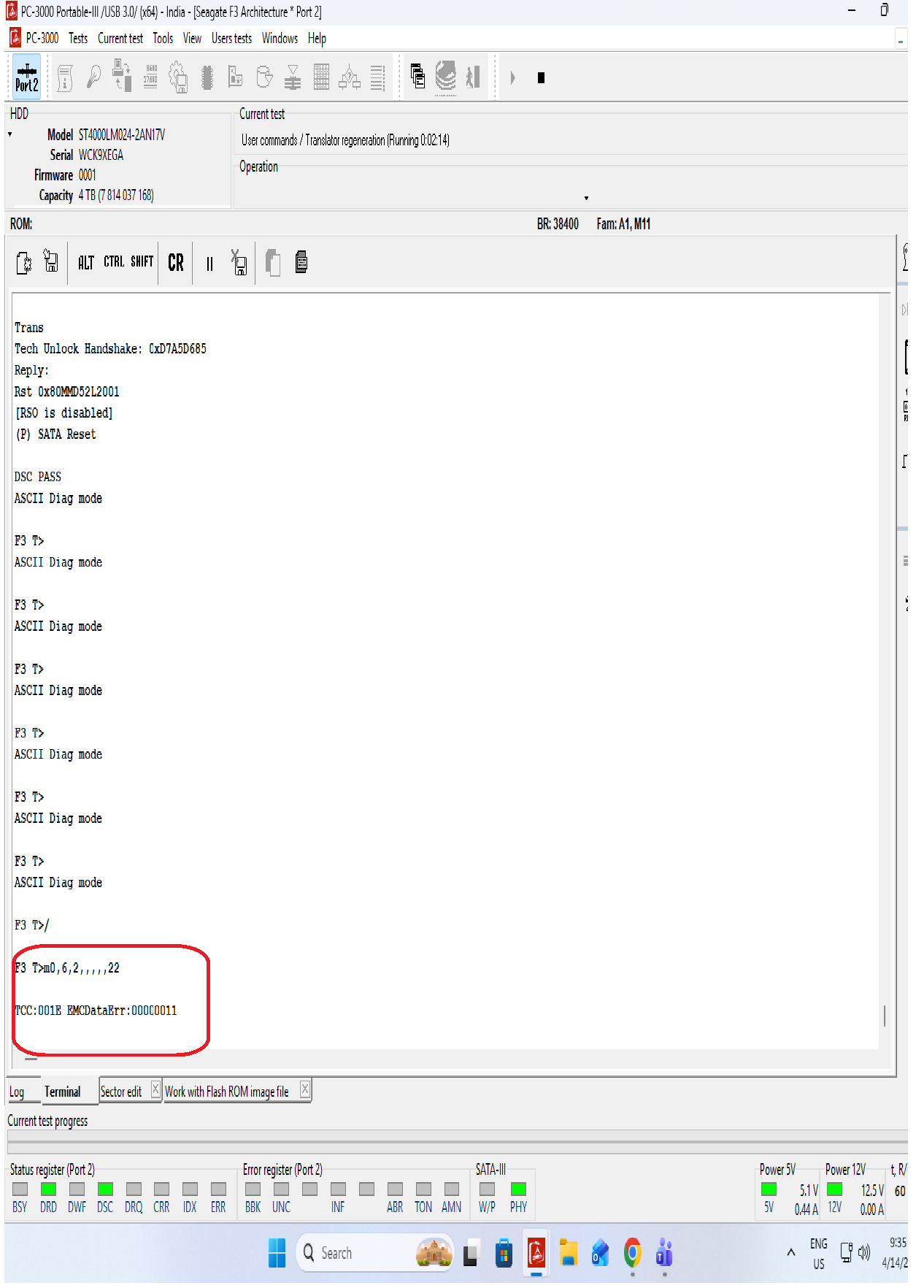

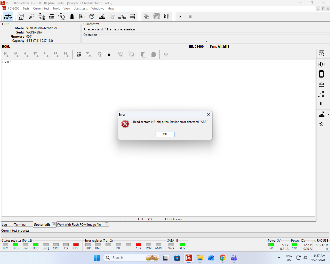

I have a Seagate ST4000LM024 hard disk with an issue where sectors are not reading. After analysis, we found that the system files are not accessible.
The drive goes into terminal mode, but whenever we run any command, it shows the error:
TCC:001E EMCDataErr:00000011
After this error, no further commands can be executed, and the terminal goes into sleep mode.
If anyone has a solution or suggestions, please help.
F3 T>/
F3 T>m0,6,2,,,,,22
Boot 0x80MMD52L20001
RECOV Servo Op=0100 Resp=0005
SpinUp
TCC:0022
Trans
Tech Unlock Handshake: 0xAFCF3943
Reply:
Rst 0x80MMD52L2001
[RSO is disabled]
(P) SATA Reset
DSC PASS
ASCII Diag mode
F3 T>
ASCII Diag mode
F3 T>

u save all modules and all sys files? u check mcmt table?

The system files are not readable, and we are unable to execute any commands.

Try set in rom, other heads, if not reads sys files u can t repair firmware

there may be an issue with heads
