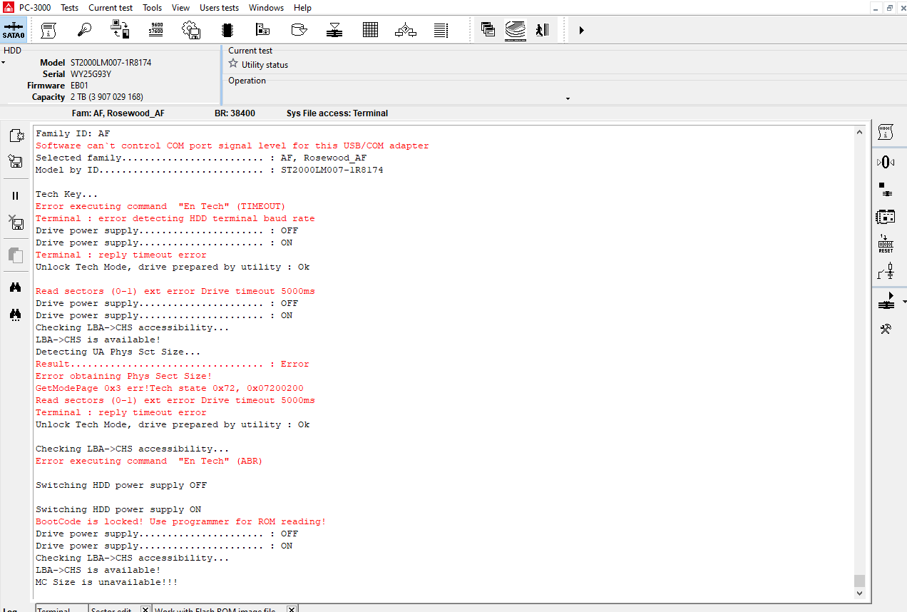

I have the same drive ST2000LM007-1R8174 here. I read the ROM using a programmer and unlocked. But the drive still gives "BootCode is locked! Use programmer for ROM reading!". I got access to user files and i am copying files but extreemly slow. I need to speed up the process please. Unlocking the ROM on WD drives using PC3k is straight forward. May be i didn't do the unlocking right? This is terminal and log

italyassistance
Posts: 90
Joined: 11.09.18
Re: Seagate 2 Tb Rosewood_A5 ST2000LM007 busy
Postby italyassistance » 22.08.26, 17:55
Why u read a rom with programmer? u dont have a Ace Pc usb terminal 3?
