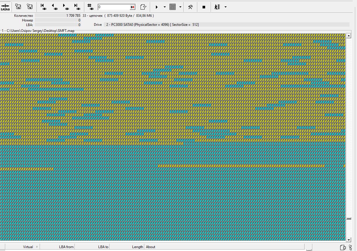

AJ2008 wrote:Source of the post clear MCMT is better option
You may erase anything containing errors (plist, translator, mct...) if you think it will give the desired result.
Here is a REAL example of Rosewood drive MFT map. Blue sectors are located in MC area. Reluctant to describe the importance of that
