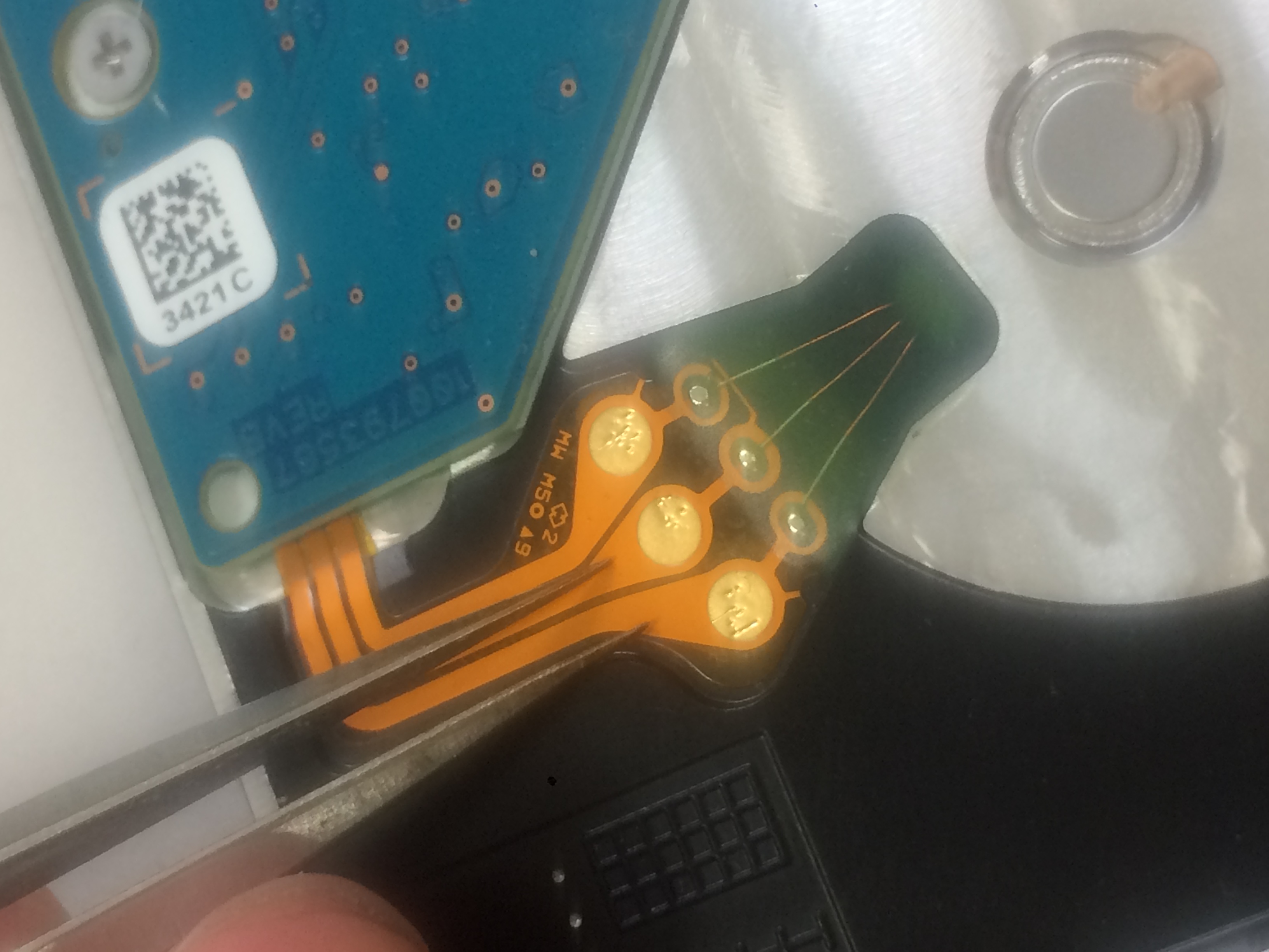

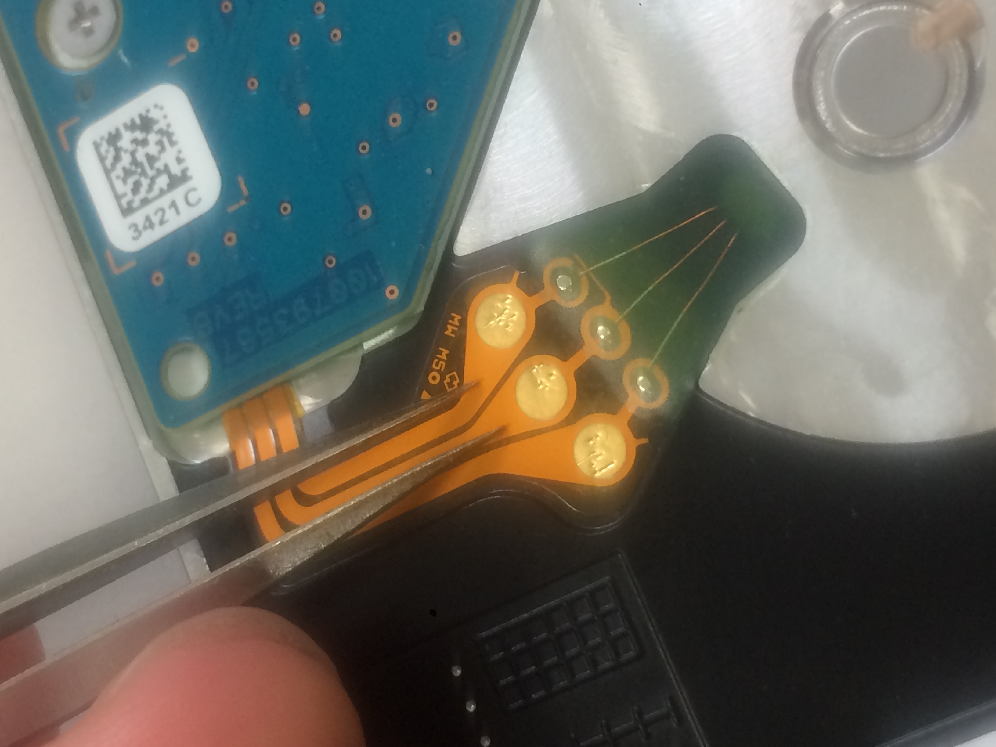

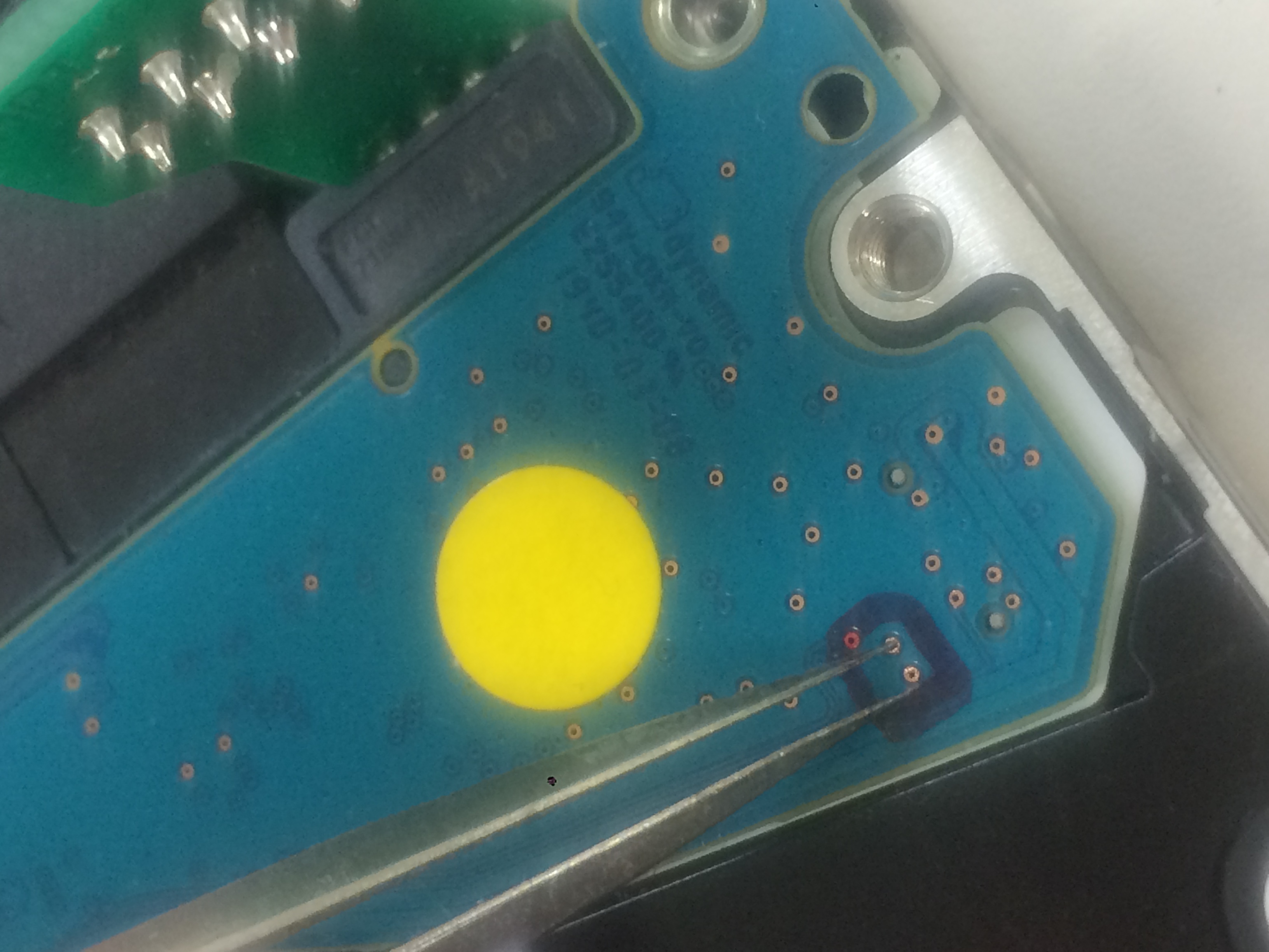

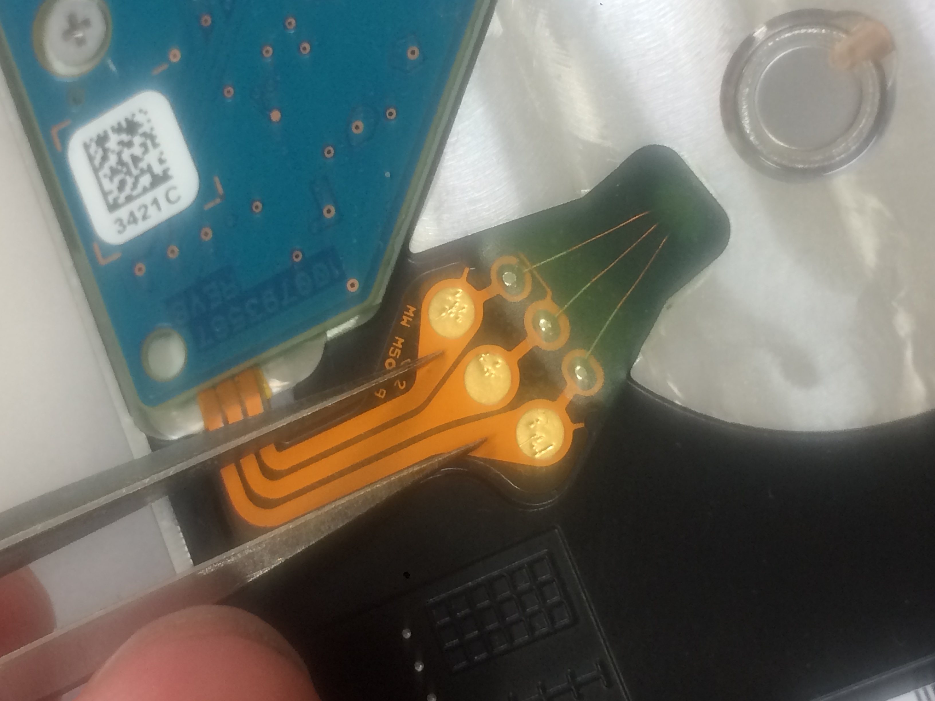

can somebody tell me which is the correct position for the read channell? i tried many times but is still get the error LED:0x000000BD FAddr:0x00008004
should i short before or after the tech Unlock Handshake"?
should i keep the position untill the drive get ready ? if the position is correct will the drive keep spinning or will stop spins?
osity
Posts: 491
Joined: 05.12.15
Reputation: 4 / (44)
Re: ST2000LX001 LED:0x000000BD FAddr:0x000059D8 HELP PLEASE
Postby osity » 22.02.24, 02:52
Those above contacts are for the motor. Are you trying to short the motor? Short after initialization. You may want to incorporate a paperclip into your tweezers. There should be a blog post that should help you with this also.
