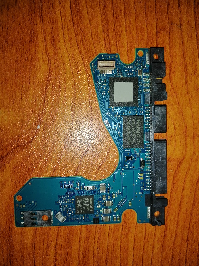

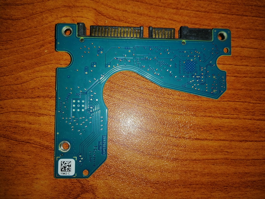

Hello Everyone.,
please find attachment pictures,
I have this hard disk with MCMT error, let me know this pcb short point ??
because i can't get terminal access.

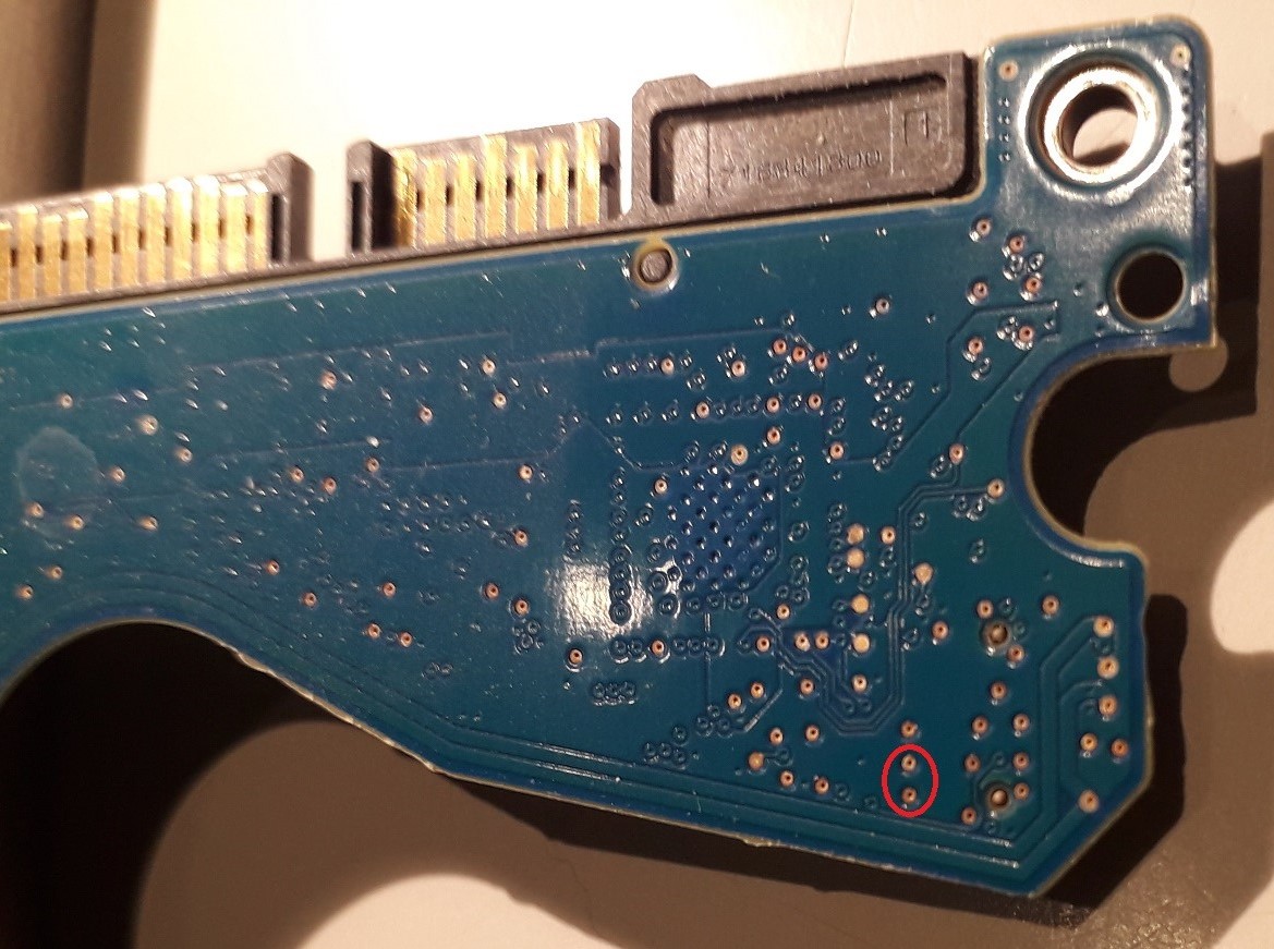

Hello Igen,
do short point method and get terminal access first.

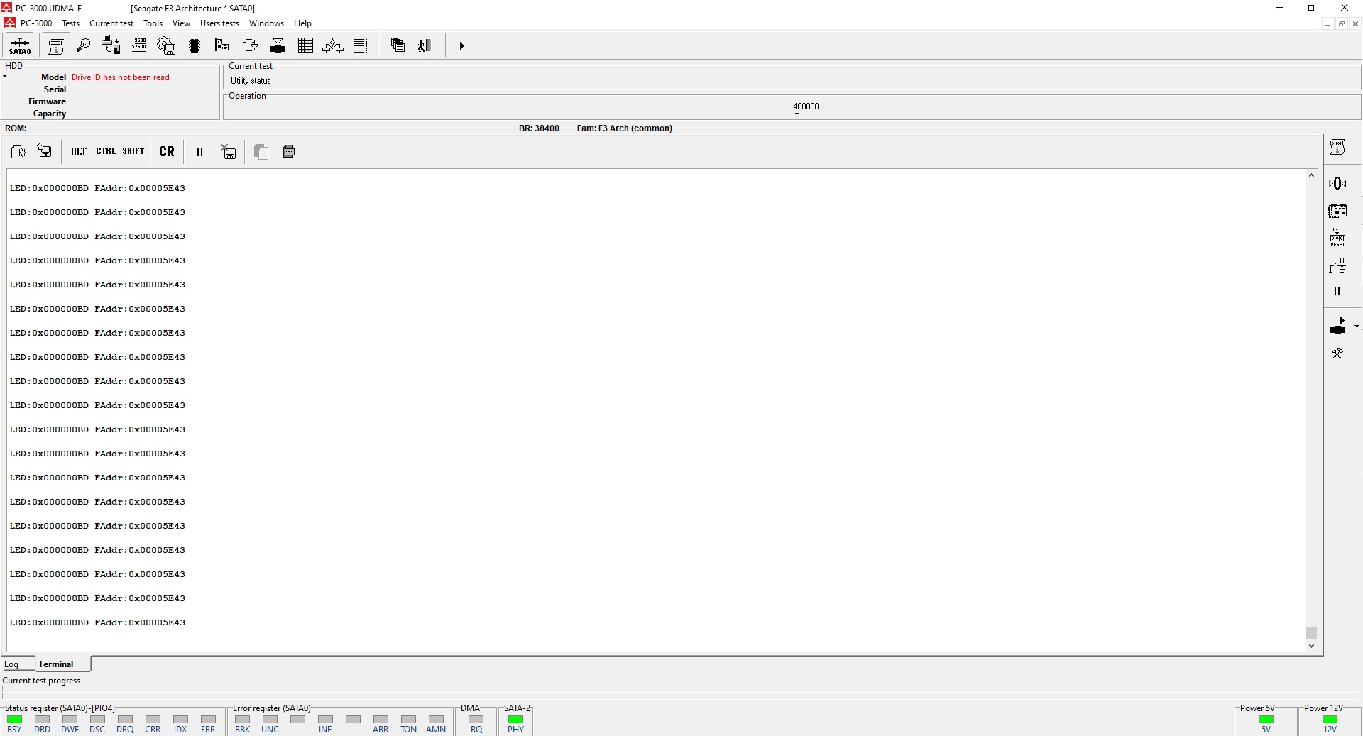

Re: 100781943 - Hard Drive Busy Shorting Pins.
Thanks DRCSL for quick answer
Unfortunately - after a short circuit, have a dozen minutes of messages (in the terminal) and again the LED.....
Previously, the disk worked - but it took a long time to boot (with or without patch) and I could not (temporarily) make a copy in DE.
I couldn't make a full copy of SYSfile.
I only have 348 - after overwriting this I have this state .....

1. Tech Mode Unlocking bios patch uploaded
2.After a power reset, we must prepare - tweezers
3. Run the patch
4.We wait for the "PASS" message to appear - exactly then - not later and not faster - at this moment make a short tweezer (fot.).
If we do it too early, we will not have access to SA - if it is too late, the LED message will appear.
We keep a short tweezer until DRD DSC appears. Now - we have full detection - but we don't have access to the data

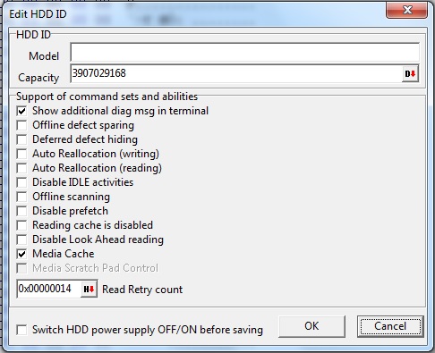

5. Edit sysfile 93 - uncheck all except first and last option (media cache) position (fot.).
Restart hdd and repeat the disk startup procedure above (short-circuit points).
