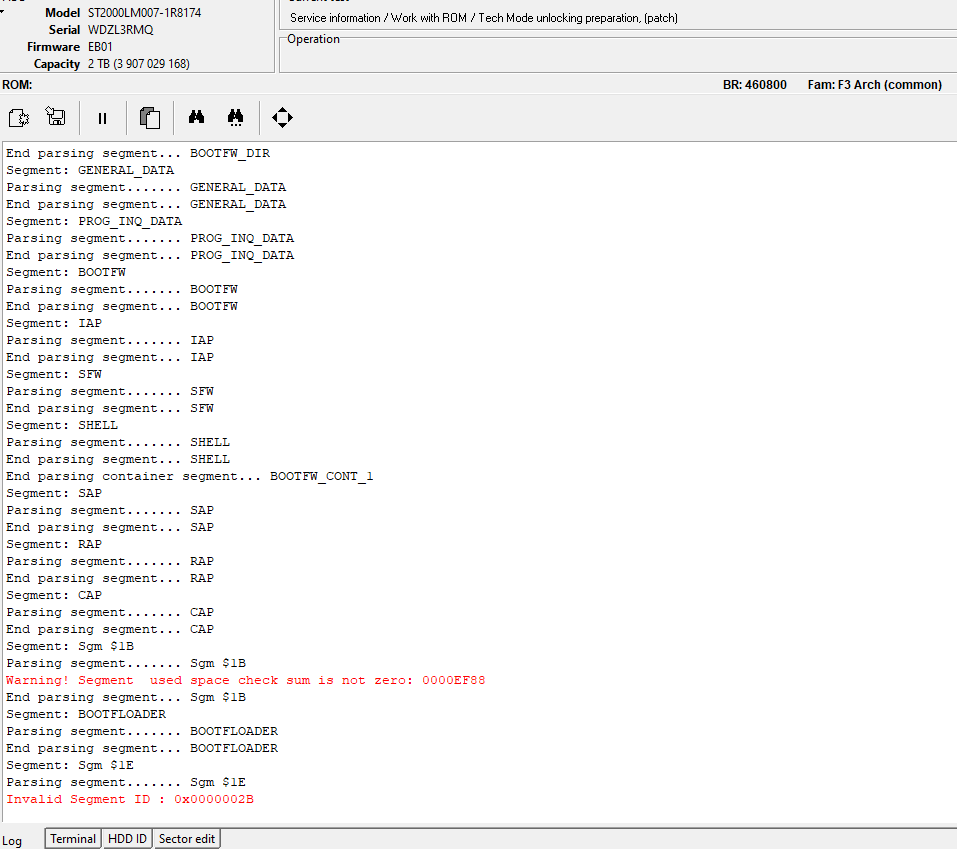

Seagate 2TB
Model : ST2000LM007-1R8174
Serial : WDZL3RMQ
Firmware : EB01
Capacity : 2 TB (3 907 029 168)
It is detecting properly and i am not able to unlock the diagnostic port,
following is the terminal report
End parsing segment... BOOTFW_DIR
Segment: GENERAL_DATA
Parsing segment....... GENERAL_DATA
End parsing segment... GENERAL_DATA
Segment: PROG_INQ_DATA
Parsing segment....... PROG_INQ_DATA
End parsing segment... PROG_INQ_DATA
Segment: BOOTFW
Parsing segment....... BOOTFW
Segment: IAP
Parsing segment....... IAP
End parsing segment... IAP
Segment: SFW
Parsing segment....... SFW
End parsing segment... SFW
Segment: SHELL
Parsing segment....... SHELL
End parsing segment... SHELL
End parsing container segment... BOOTFW_CONT_1
Segment: SAP
Parsing segment....... SAP
End parsing segment... SAP
Segment: RAP
Parsing segment....... RAP
End parsing segment... RAP
Segment: CAP
Parsing segment....... CAP
End parsing segment... CAP
Segment: Sgm $1B
Parsing segment....... Sgm $1B
Warning! Segment used space check sum is not zero: 0000EF88
End parsing segment... Sgm $1B
Segment: BOOTFLOADER
Parsing segment....... BOOTFLOADER
End parsing segment... BOOTFLOADER
Segment: Sgm $1E
Parsing segment....... Sgm $1E
Invalid Segment ID : 0x0000002B

This is Janos_AF, not supported by PC-3000 currently.
Should be in next update probably.

Janos_AF = your drive's family.

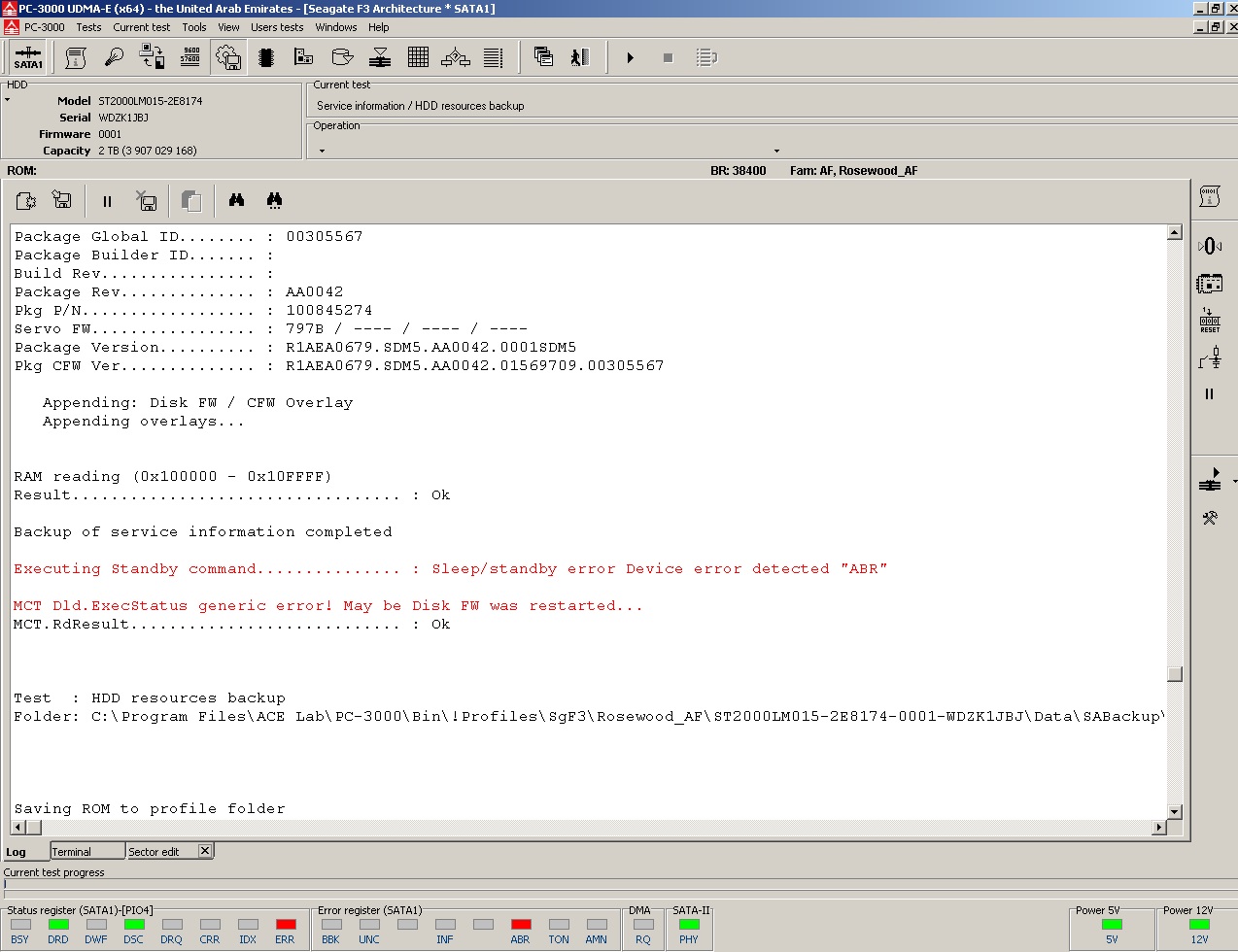

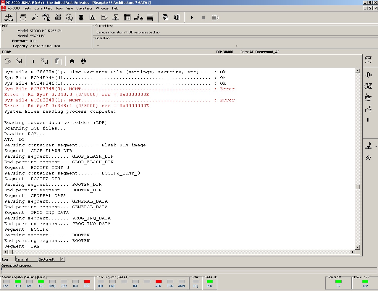

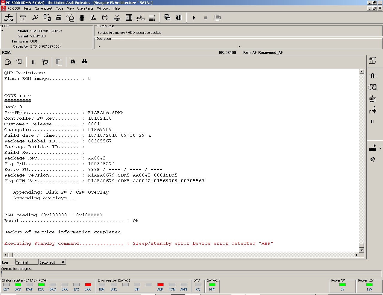

Hi.. Everyone
I have AF Rosewood
Model : ST2000LM015-2E8174
Serial : WDZK1JBJ
Firmware : 0001
I unlocked the drive backedup Modules and system files copy.0.1 made a loader, finally and read data in sector 0.
the point is make hyphenate AFRosewood throw PC-3000 and reconnect Device Manger SATA Cable to PC and refresh device manger drive to extract data by R-Studio as I did with ST1000LM035 Model.
How can I keep this type of drive unlocked permanently for refurbishing used ?
Log AF Roswood.log
(78.82 KiB) Downloaded 214 times
