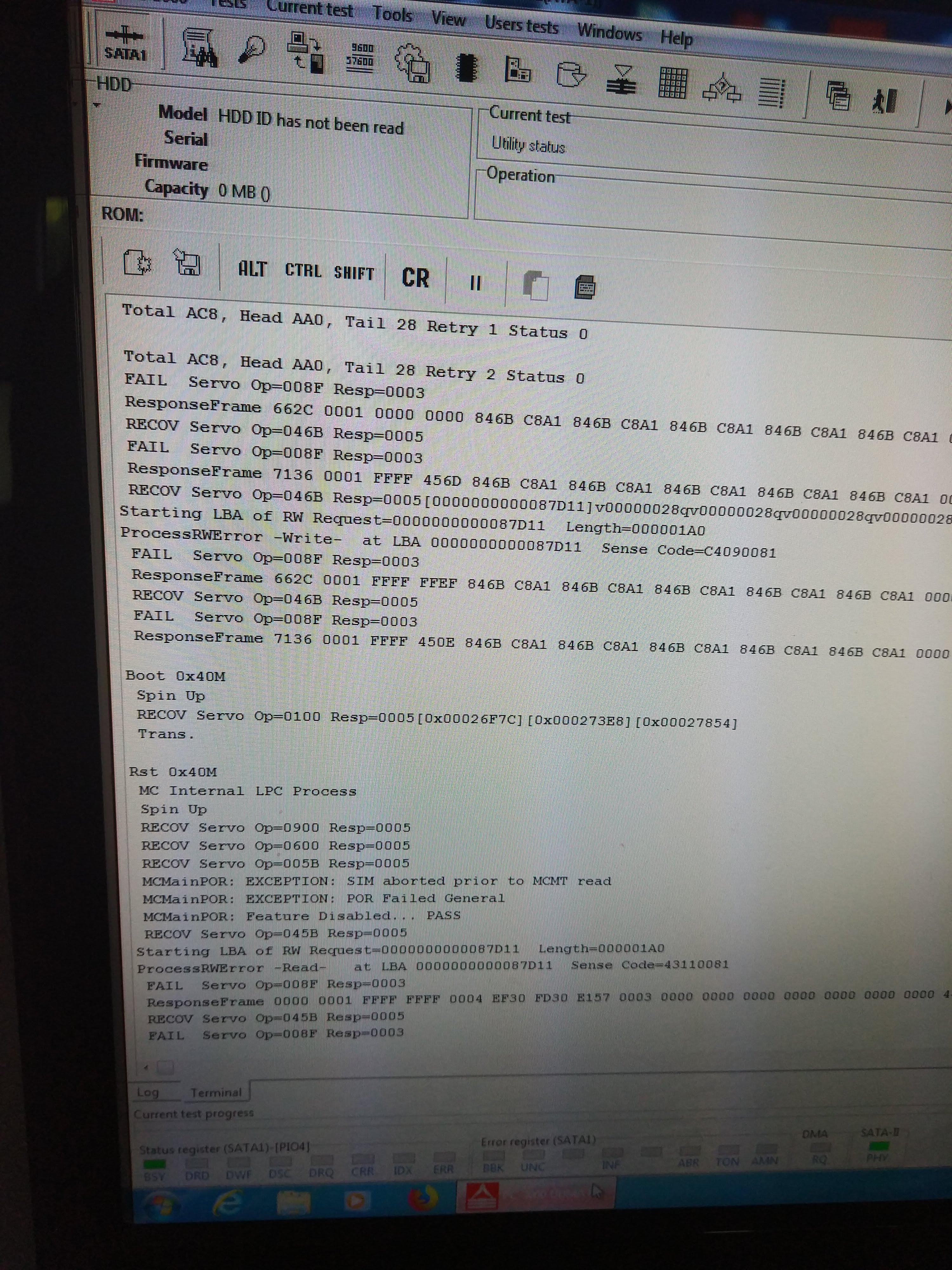

I'm struggling with a ST3000DM001 here..
I have swapped heads on it (same preamp), but I get this log.
I checked heads under microscope and they don't show any dust.
I swapped heads back again to donor and it seems that head 3 (at least that one) failed. If I do a SAP change to use 0,1,2, the drive ID's fine (the donor).
I tried also to import head adaptives, but same thing.
What do you guys think? Media damage? Or some kind of FW problem?

Re: ST3000DM001
Translator was not read, you'd have to fix it later
Drive is busy walking through MC and marking bad sectors, wait until it stops doing so (could take hours)
Also you saying that H3 is bad, that could mean the drive is developing MD, make sure you address this issue before you let the drive parse MC

Re: ST3000DM001
you need to make sure there is no MD on H3, if there is - cut the head
after that, yes, let it run
very possible it would show No Host FIS error, because translator was not read, fix the translator(assuming heads can write) and drive should come ready if there are no more surprises
