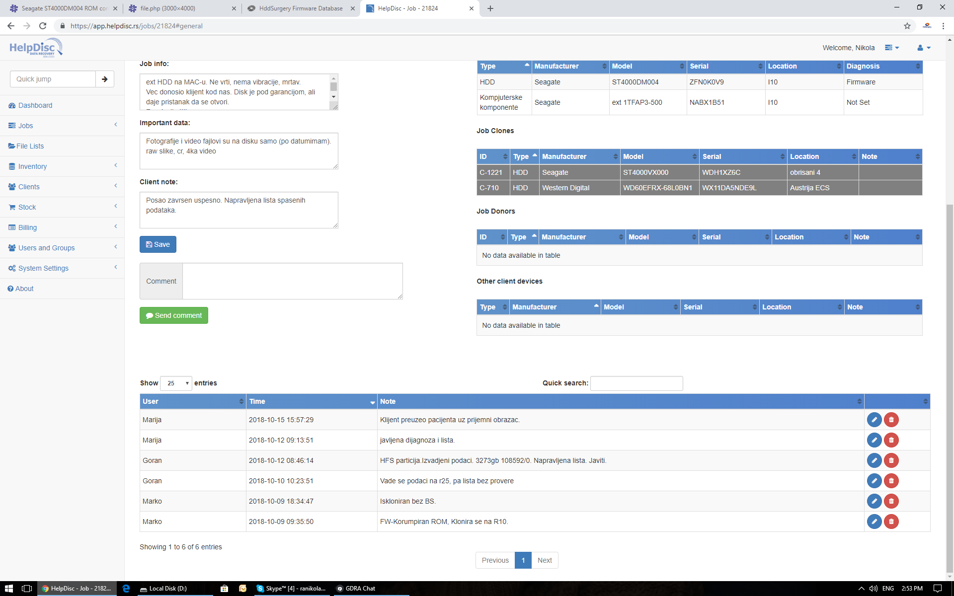

You can see in our job tracking sistem that first log was written that client brought a hard drive witch is does not spin. We did what guys suggested to Miodrag. He can read serbian so he can see and corupted is more less same on Serbian.
Since he did not know how to do this him self, clearly shows client brought it to a good company first and bad one later, but it is his right.

There are two ROMs in the package, one with original corrupted content and the other one which is fixed and with which we cloned the disk. You can also see the times when we read original ROM (8:36), extracted CAP, SAP, RAP... parts and assembled fixed ROM. Then at 9:20 we got fully working disk with full ID and made full internal firmware backup and cloned the disk. At 9:35, if you take a look at the screenshot from our software, our engineer noted bad ROM, and that disk is being cloned, and a couple of hours later at 6 PM that disk was cloned without any BS.
