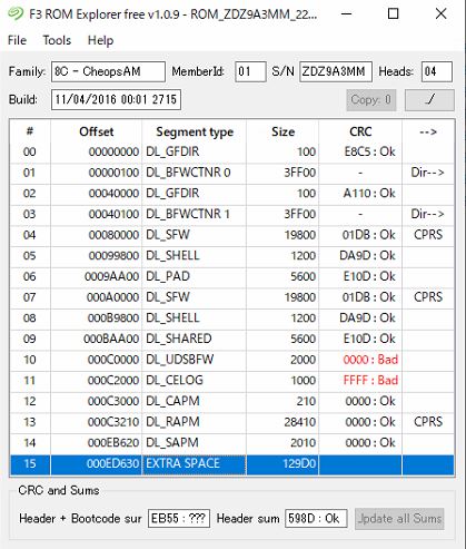

igen wrote:Source of the post recalculate CRC
how to recalculate CRC??
i tried this official guide
https://blog.acelab.eu.com/how-to-fix-a ... -chip.html
but this guide doesnt work for me ! after Repeat the unlocking steps (1-6) i cannot enter the command OI1 ! with the DONOR PCB ! because i will get LED:0x000000BD FAddr:0x000059D8 !
and if i skip this command and Repeat the unlocking steps (7-9). i get Waiting drive spin up !
is this guide accurate? im starting to doubt!!!!!

igen wrote:Source of the post F3ROMExplorer
Sir which part of the rom should i recalculate the CRC?
