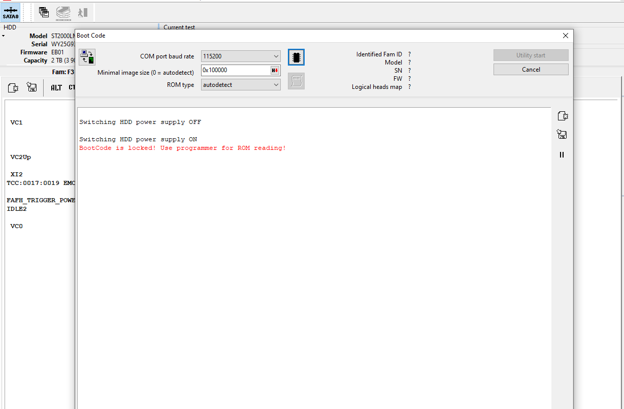

I have the same drive ST2000LM007-1R8174 here. I read the ROM using a programmer and unlocked. But the drive still gives "BootCode is locked! Use programmer for ROM reading!". I got access to user files and i am copying files but extreemly slow. I need to speed up the process please. Unlocking the ROM on WD drives using PC3k is straight forward. May be i didn't do the unlocking right? This is terminal and log

Why u read a rom with programmer? u dont have a Ace Pc usb terminal 3?

Thank you for the feed back. I do have Terminal but I dont have access to Bootcode. What do you suggest?
