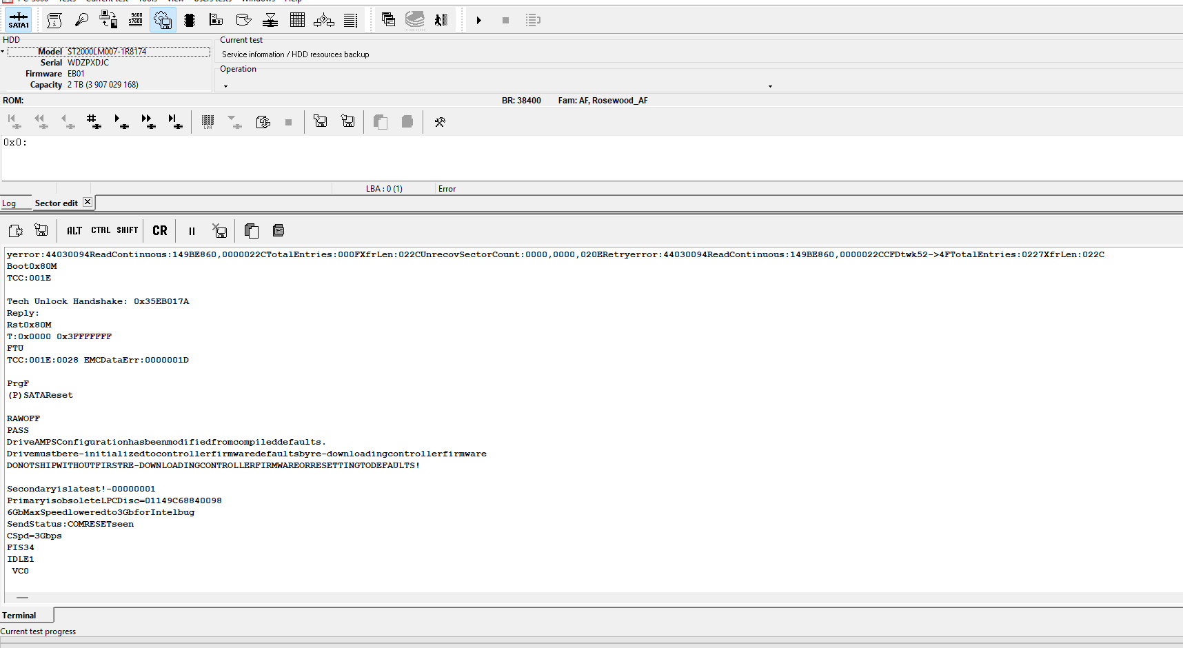

I got this ST2000LM007, readies up fine, Unlock Tech is fine and got full ID. No clicking no noises

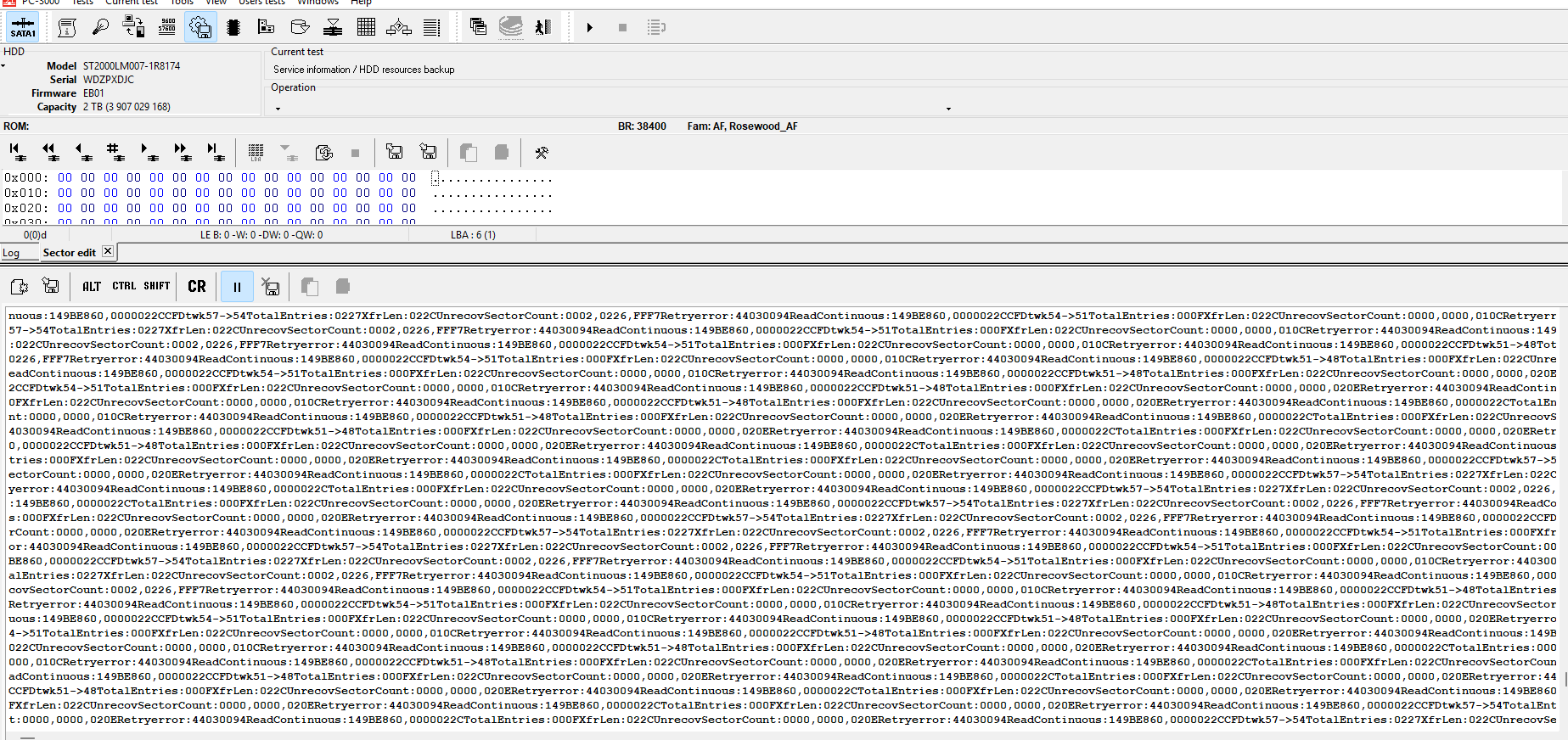

I got the full Module Backup. As soon as i read 1 sector in Sector Edit the drive becomes BSY and the terminal dumps out a whole bunch of stuff
Can anyone help! Many Thanks!
GETS FULL ID
Screenshot 2025-10-02 121607.png (57.06 KiB) Viewed 2305 times
As soon as I read a sector. The driver Stuck in BSY
Terminal sends a bunch of codes
Screenshot 2025-10-02 121759.png (164.1 KiB) Viewed 2305 times

Save all modules, and deactive backgroud activity in module 93 if head 0 write, if head 0 dont write, found preamp version and changes heads.
