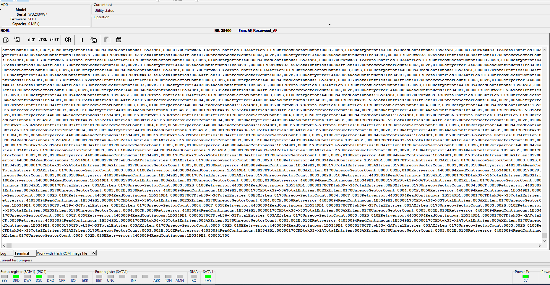

model st2000lm009
2tb seagate
unable to get terminal.Showing continuously background process . Pls help me if someone has face this problem .
seagate err.PNG (219.18 KiB) Viewed 6582 times

Try to short the reading channel on the PCB for getting stable terminal access, then pay attention on Translator system file's condition.
Of course, ROM should be patched for SED bypassing.
