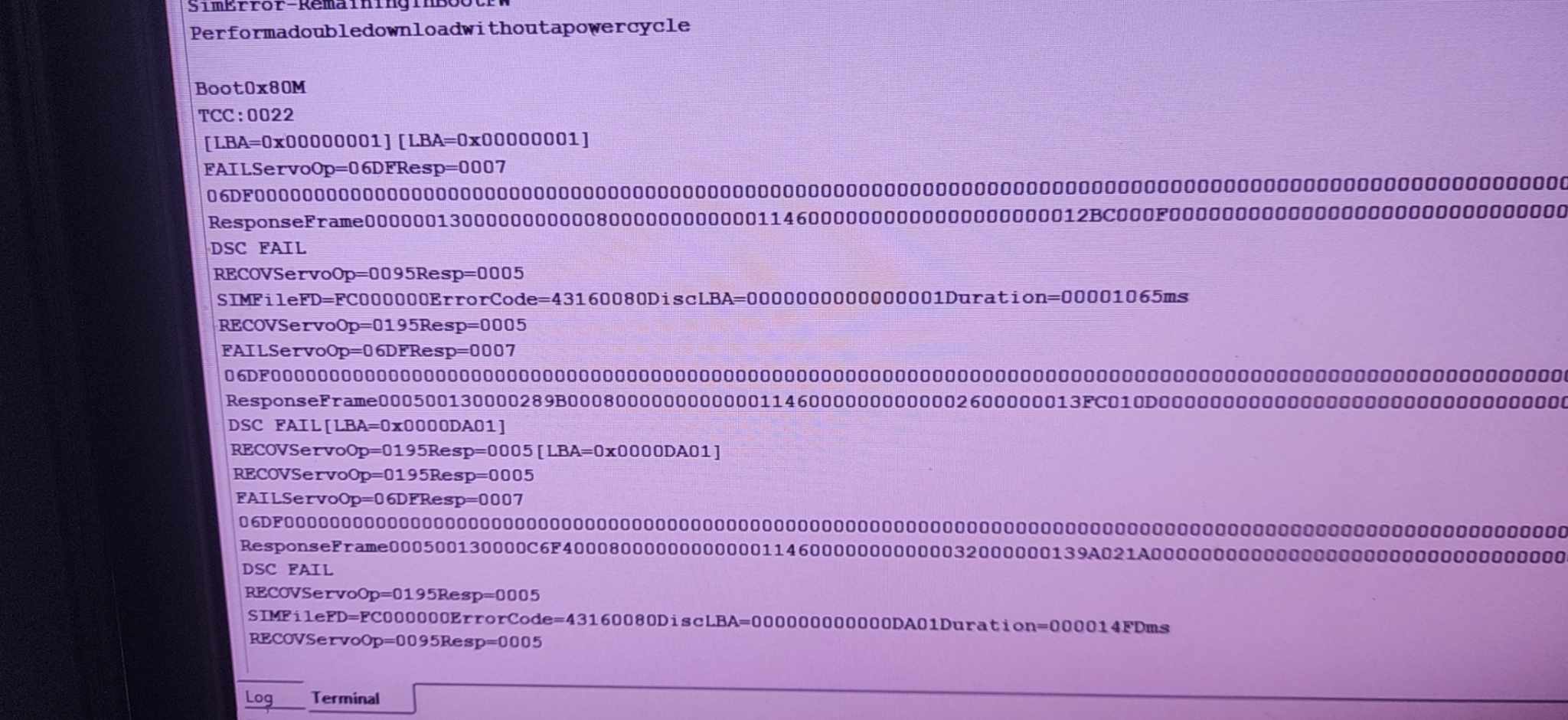

that's the issue unfortunately
Re: Seagate 0MB problem
Postby gameboybin » 10.05.24, 08:45
I have exact same problem. After changing heads> Clicks a few times and got ready on Double down
