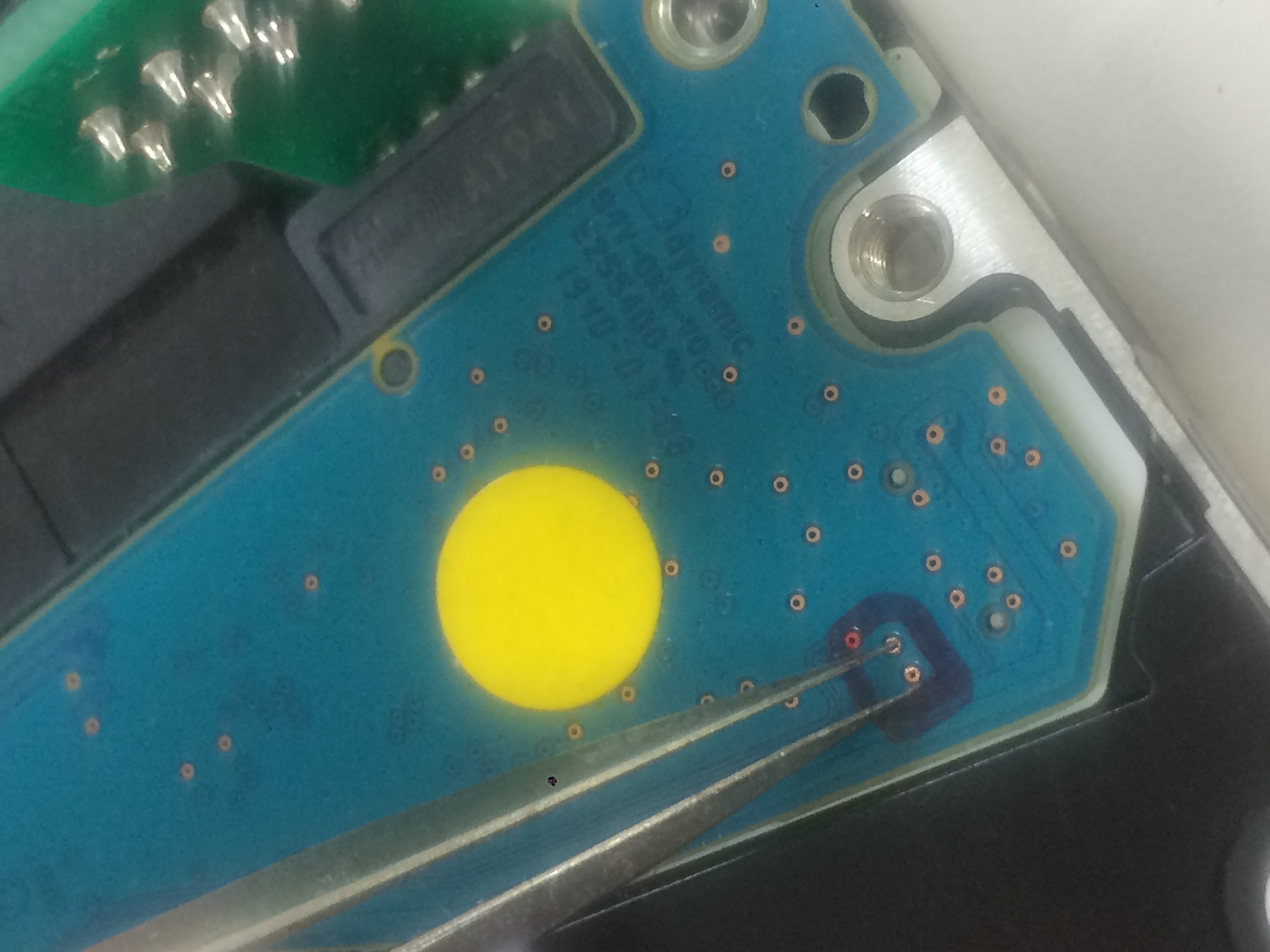

Postby computershopee » 10.01.20, 13:09
Try to shorting the pcb by instructing by manual...
i success & got the data 1000 GB..
once you go with solution for unlolck 00000CD process
First we have to get >T
when you got you will success.. i tried for 3 days to get >T & finally got it. :wave:

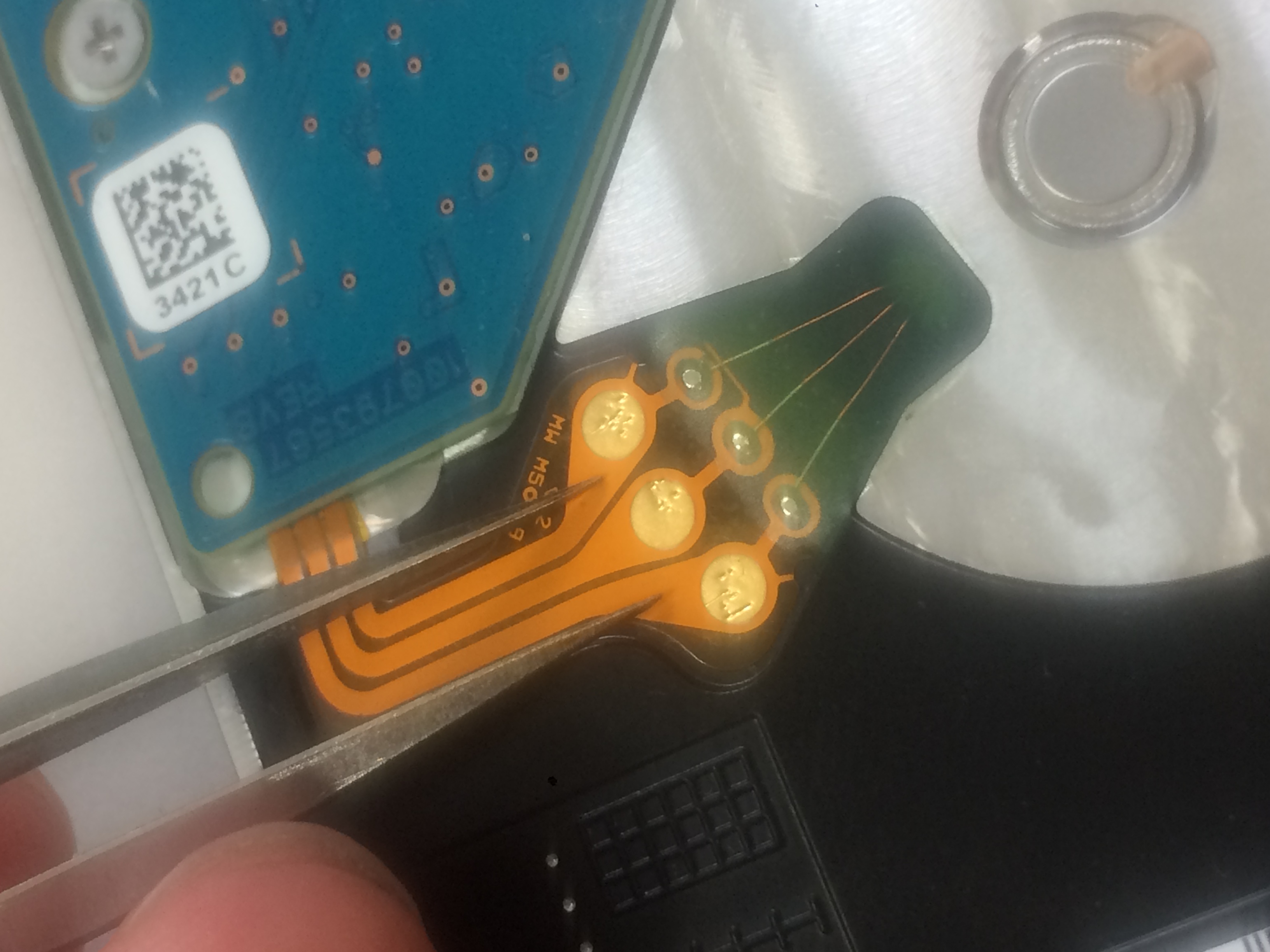

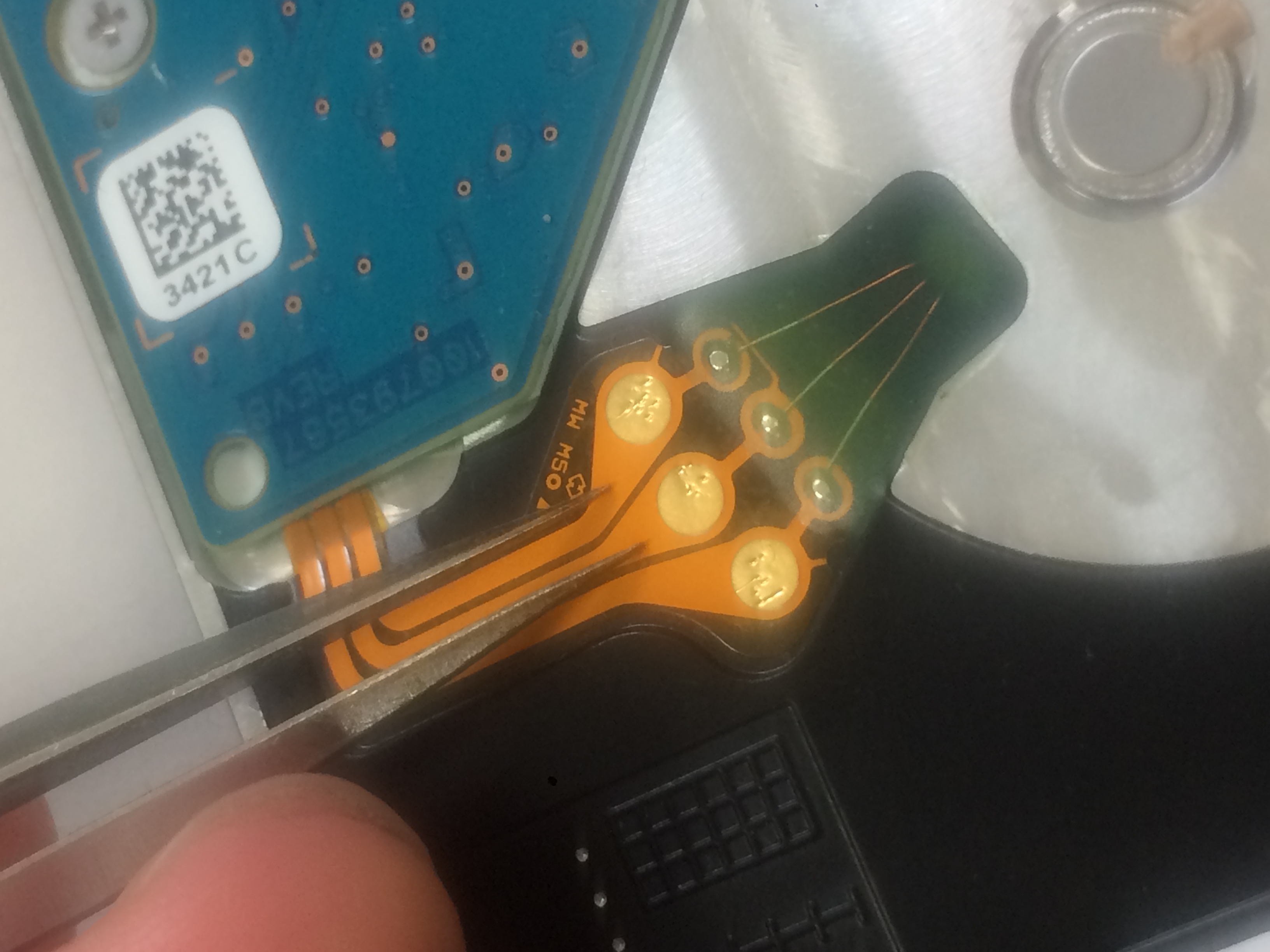

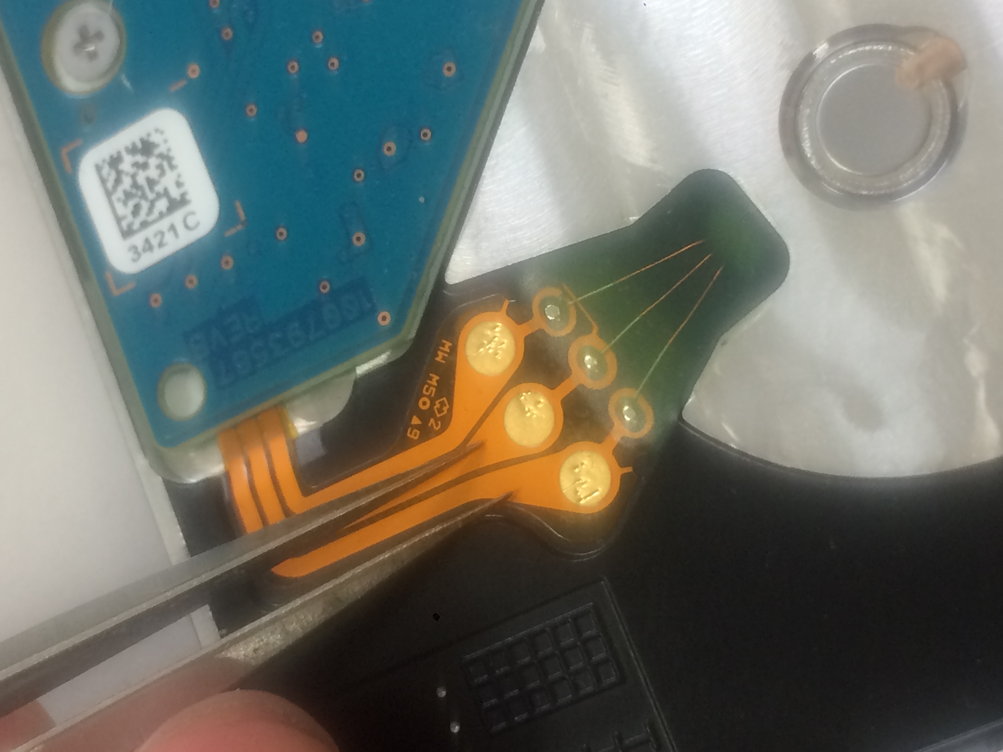

can somebody tell me which is the correct position for the read channell? i tried many times but is still get the error LED:0x000000BD FAddr:0x00008004
should i short before or after the tech Unlock Handshake"?
should i keep the position untill the drive get ready ? if the position is correct will the drive keep spinning or will stop spins?
