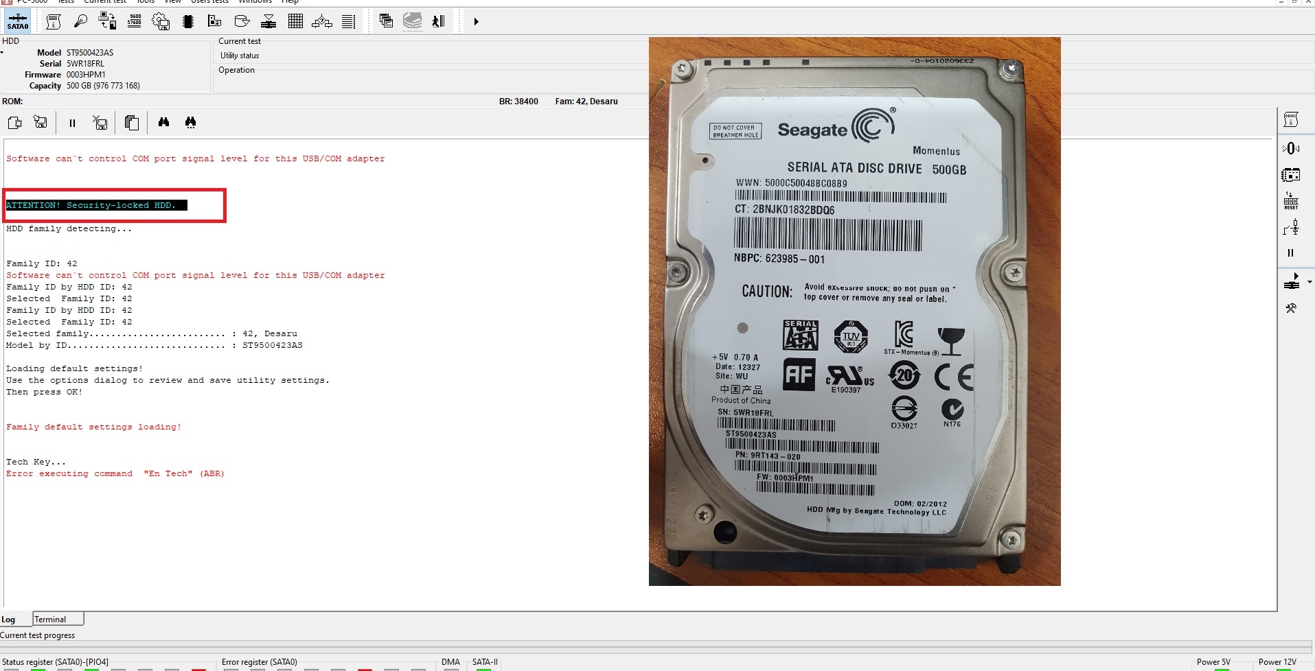

Who can help me to remove the lock on this hard drive?
If you advise, I can do the work.
ST9500423AS,
Thanks,
Daminda

Re: Security Lock Remove ST9500423AS.  Topic is solved
Postby rezafarah » 02.02.24, 13:21
menu
tools/HDD/HDD security Subsystem/Open HDD or Clear password
then follow the instroctions.
