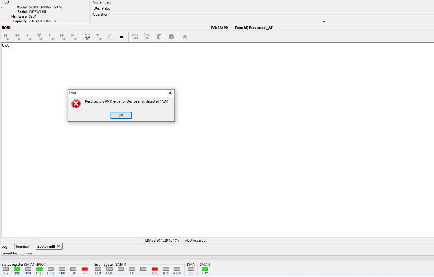

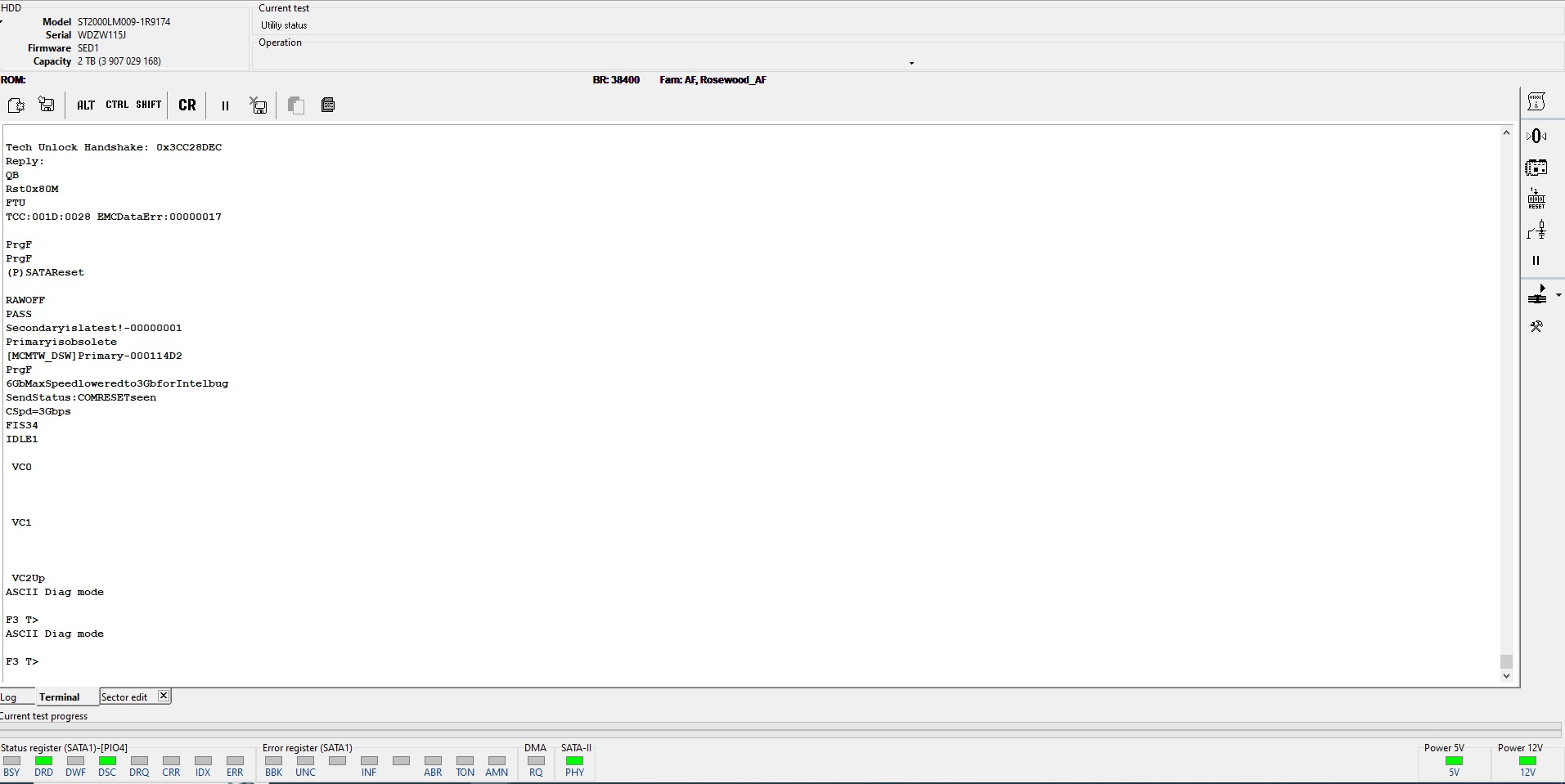

Need advice please.
There was an MCMT error in this hard drive.
I fixed error use with this commands. ( /cU10 , /1N1 , /7m100 ) , I have original system files backup.
now disk working well , but can't access any sectors.
who can give me support for this?
Thanks,
