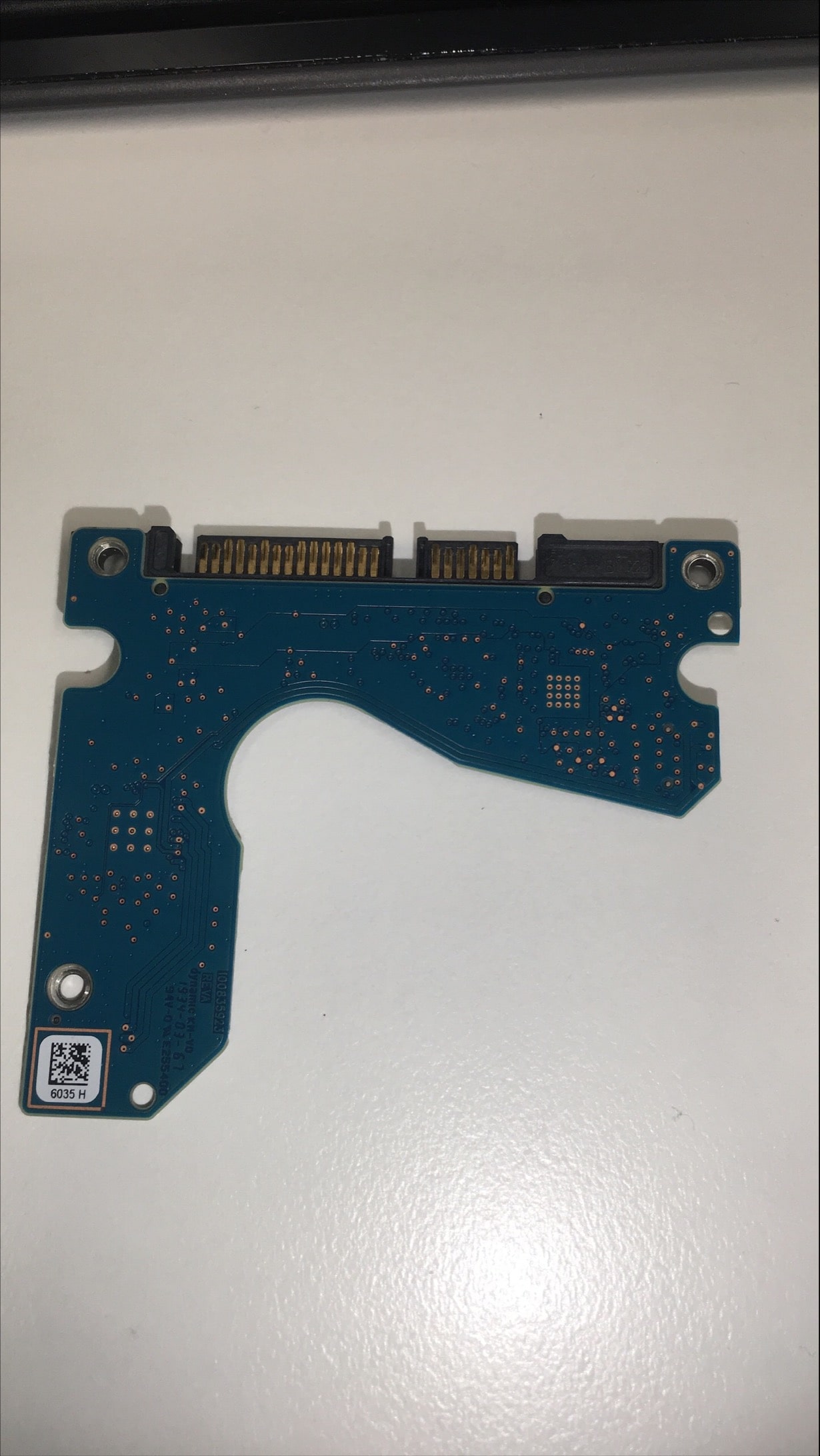

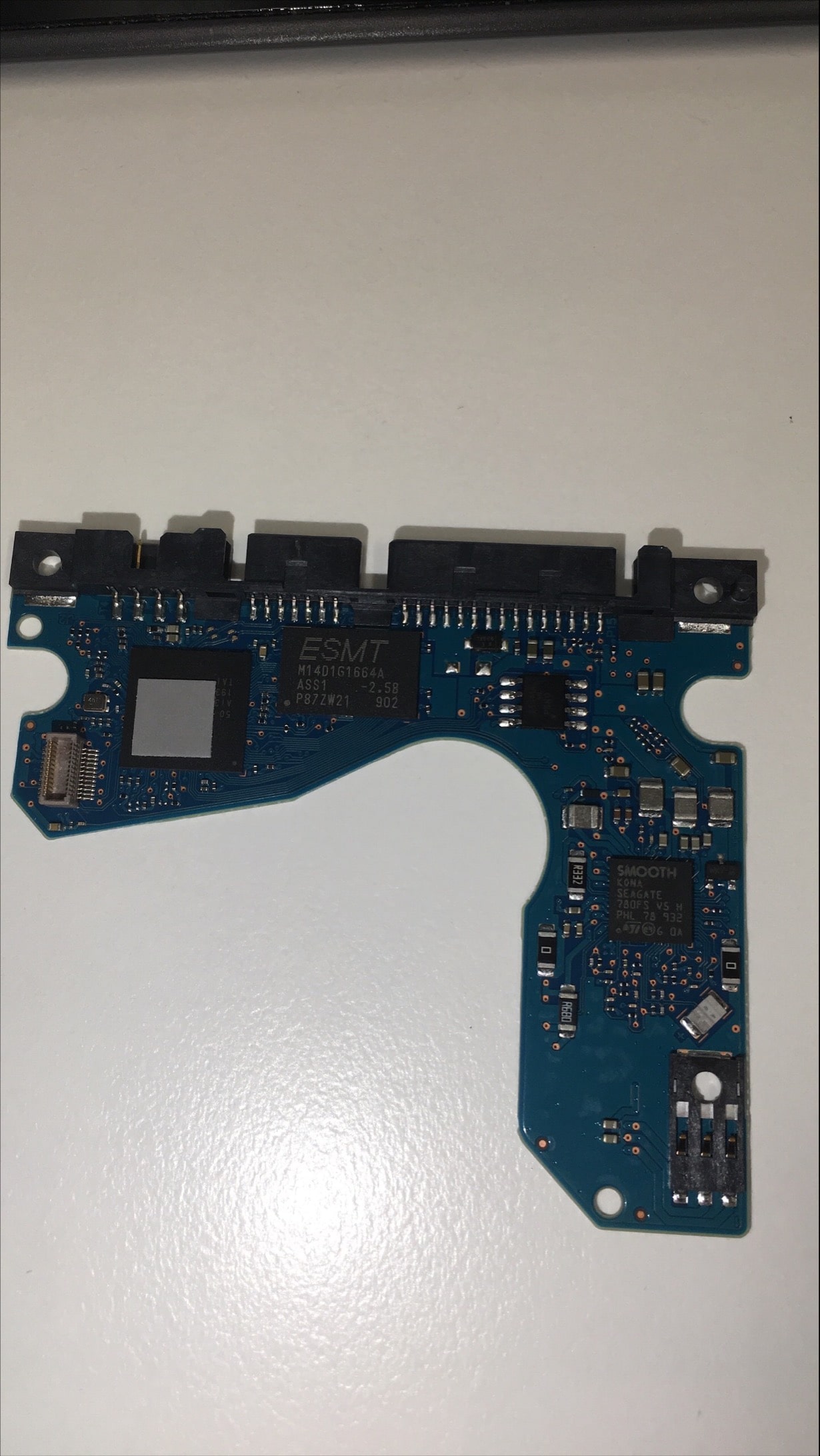

Would like to find the shorting points for ST2000LM007 (100835923).

ST2000LM007 - Shorting Point
Re: ST2000LM007 - Shorting Point
PreampType: 87 10 matchs with preamp 8210 ? i want to replace engine and heads because this problem, it readed a few part of disk and after appears this bug edac mcmt bla bla bla
Here you can find a shorting points for ST2000LM007:
https://blog.acelab.eu.com/pc-3000hdd-p ... rives.html
