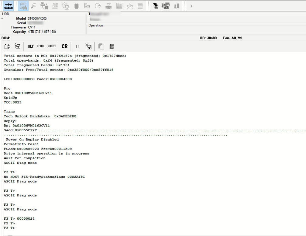

Do you guise face this issue after translator regen on Seagate SMR hdd
Does the data look encrypted or unreal?
ref family M11, B2 Etc .
ref log
Boot 0x0100MVM0163CV11
SpinUp
TCC:0022
Trans
Rst 0x0100MVM0163CV11
SAdd:0x0055C17F
NVCScram Saved HB Size:020A
LD: MD_Alloc:00000078 HB_Alloc:0000 MD_Alloc:80380000 HB_Alloc:8032 FlashRestore MD_Saved:00000078 HB_Saved:00000000 MD_CRC:14D9
PP: MD_Alloc:0000B400 HB_Alloc:0000 FlashRestore
PVTSize: 00002C00 CompSize: 000003BA DeCompSize: 00002C00 MD_Saved:000003BA HB_Saved:00000000 MD_CRC:131C
WCD: MD_Alloc:00012000 HB_Alloc:02E6 FlashRestore...............................................................................................................................................................................................................................................................................................................................................................................................
LED:0x000000BD FAddr:0x0000A78A
after short PCB F3 access but no host issue
I read sys 1b,28,35,93, this hdd not have 348 HDD family B2
after translator regen on Seagate SMR hdd Does the data look encrypted or unreal?
