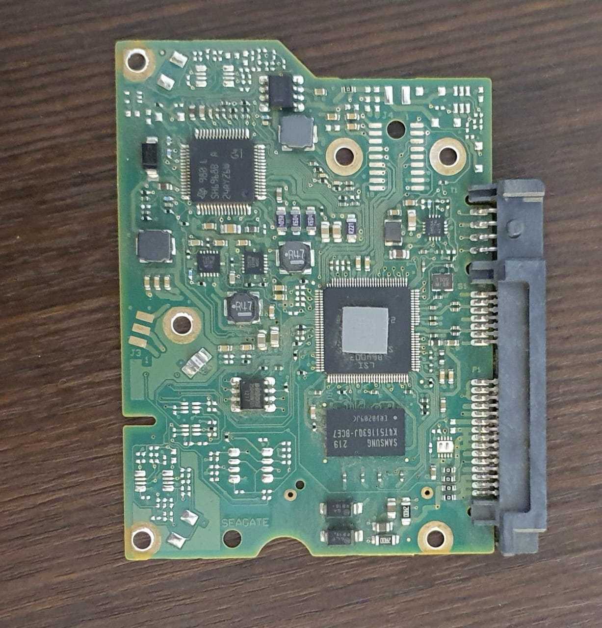

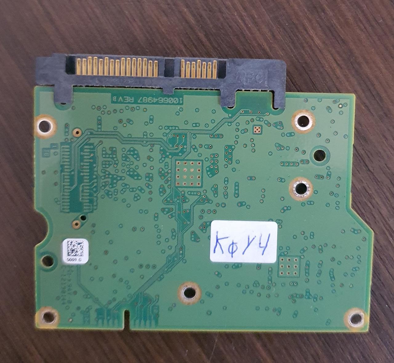

ST2000DM001 LED 00000047 error
Postby Issam » 28.09.22, 13:29
The disk is spinning normally, no cliccking
I did unlocked patch, but cannot access the terminal:
Boot 0x40M
Spin Up
TCC-0025[0x000065B4][0x00006A20][0x00006E8C]
Trans.
Tech Unlock Handshake: 0x44B88143
Reply:
UNLOCK ERROR!
Rst 0x40M
MC Internal LPC Process
Spin Up
TCC-0025
(P) SATA Reset
MCMainPOR: Start:
Check MCMT Version: Current
MCMainPOR: Non-Init Case
MCMainPOR: EXCEPTION: MCMT PRI copy corrupt
MCMainPOR: MCMT SEC copy valid
Reconstruction: MCMT Reconstruction Start
Max number of MC segments 0A61
Nonvolatile MCMT sequence number 00484CAF
[RSRS] 07E1
ProcessRWError -Read- at LBA 0000000000066555 Sense Code=40000087
InitiateMarkPendingReallocateRequest for disc_lba: 0000000000066555!
Reconstruction: Completed 1:
[MCMTWS]
Rst 0x40M
Spin Up
TCC-0025
LED:00000047 FAddr:FFFFFFFE

These drives do not have locked terminal, you don't need to patch them. So, revert it back.
Your drive complains about MC.

but i cannot access the terminal
Re: ST2000DM001 LED 00000047 error
Postby Amarbir[CDR-Labs] » 09.10.22, 02:14
Issam wrote:Source of the post thank you
Well,
In That Case Short the Read Channel And Get Access
