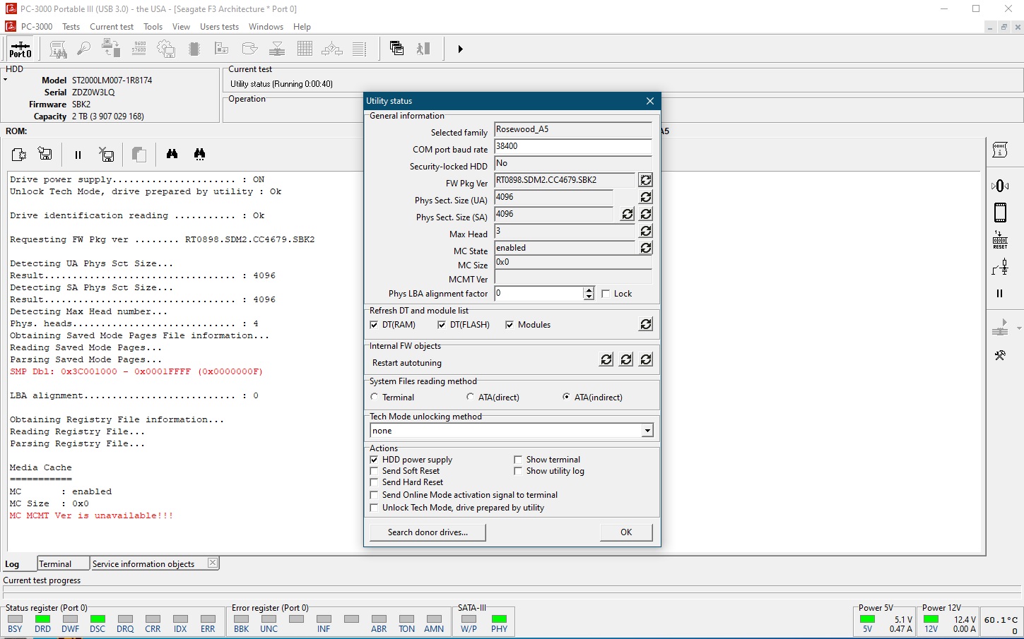

after head unstick was able to copy data, half way during copy drive started making clicking sound. Swapped heads drive spins but sometimes clicks.
Executing user command.................. : Check Heads
ASCII Diag mode
F3 T>/7
F3 7>X
FAIL Servo Op=0195 Resp=0007
0195 FFFE FFFF 7FFF 7FFF 7FFF 0000 0003 0000 0000 03E8 0000 FFFF 9540 0000 0000 0048 02BC 2871 0000 0000 0C70 430A A000 0000 0000 0000 0000 0000 0000 CB00 0000
ResponseFrame 0000 0000 0821 00A6 0008 0000 0000 0000 EEB8 0AC0 F708 FE26 F604 01BC 1CFA 144C F708 FE20 F504 6380 EDD3 0A2A ED93 1A2B EEB4 0AE0 EEF1 FA10 BFC8 EEB0 0000 0000 00B9 Loop=2443
ResponseFrame 0008 0011 0821 00A6 0008 0000 0000 0000 EEB8 0AC0 F708 FE26 F604 01BC 1CFA 144C F708 FE20 F504 6380 EDD3 0A2A ED93 1A2B EEB4 0AE0 EEF1 FA10 BFC8 EEB0 0000 0000 2443 Loop=2443
RECOV Servo Op=0295 Resp=0005
Head 00 Resistance 017F
Head 01 Resistance FFFF
Head 02 Resistance 0183
Head 03 Resistance 0156
F3 7>
Head 01 is the culprit? or the head stack assembly not compatible?
New to rosewood go easy on me. If someone could help please PM would gladly get a coffee for any help. Thank You.
terminal data 05272021.txt
(11.53 KiB) Downloaded 251 times

h1 is bad, your terminal output shows that drive complains about h3 too.
