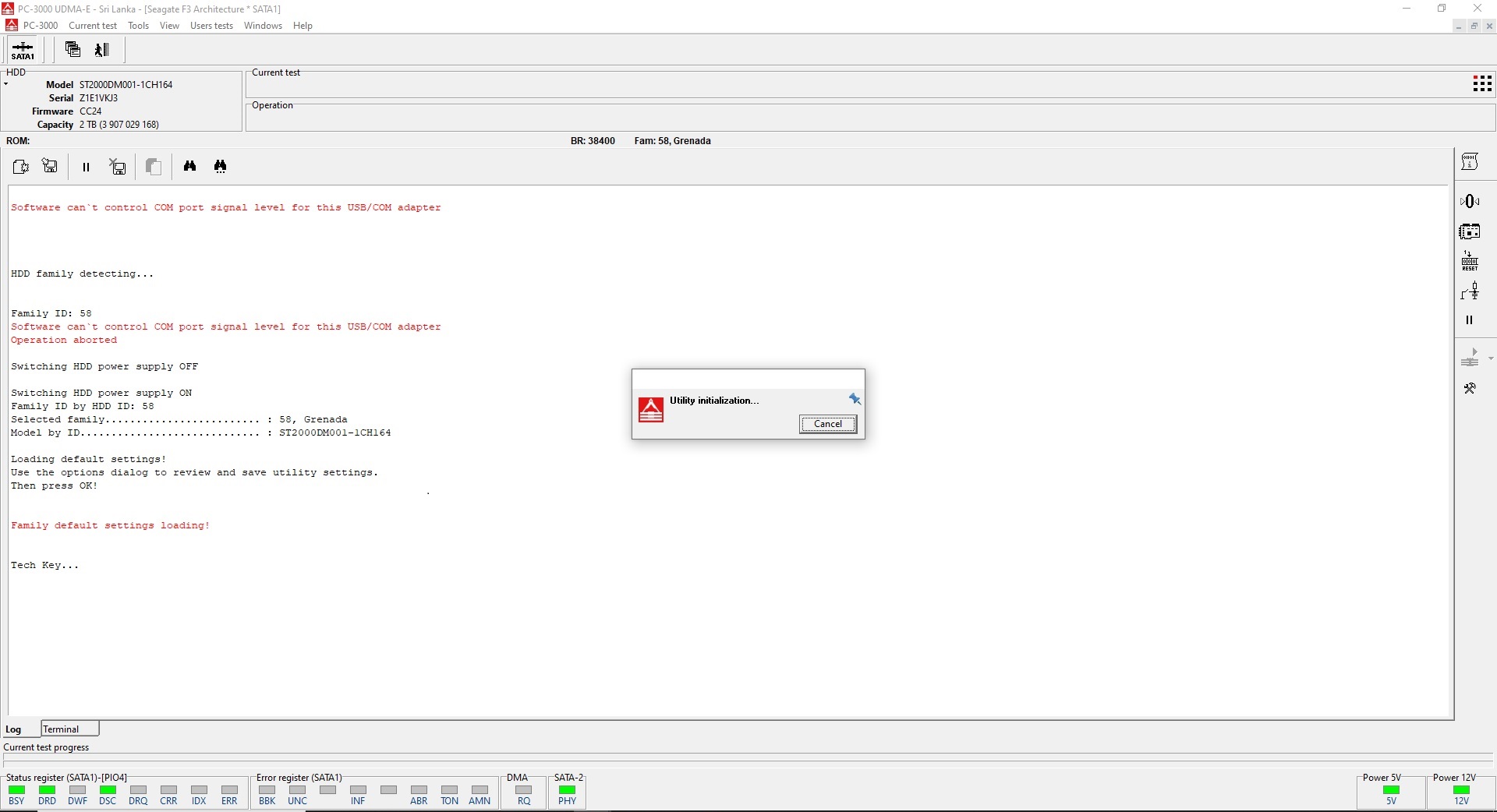

Dear Friends,
Please let me know how to solve this busy error ?
please find attachment pictures.

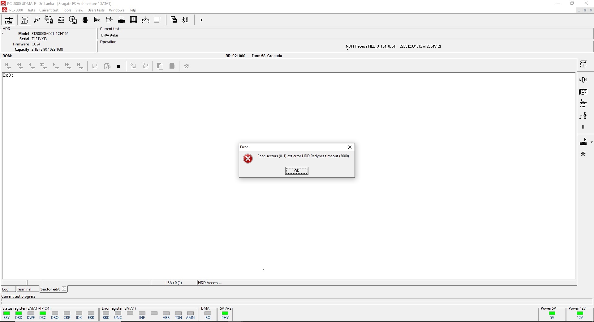

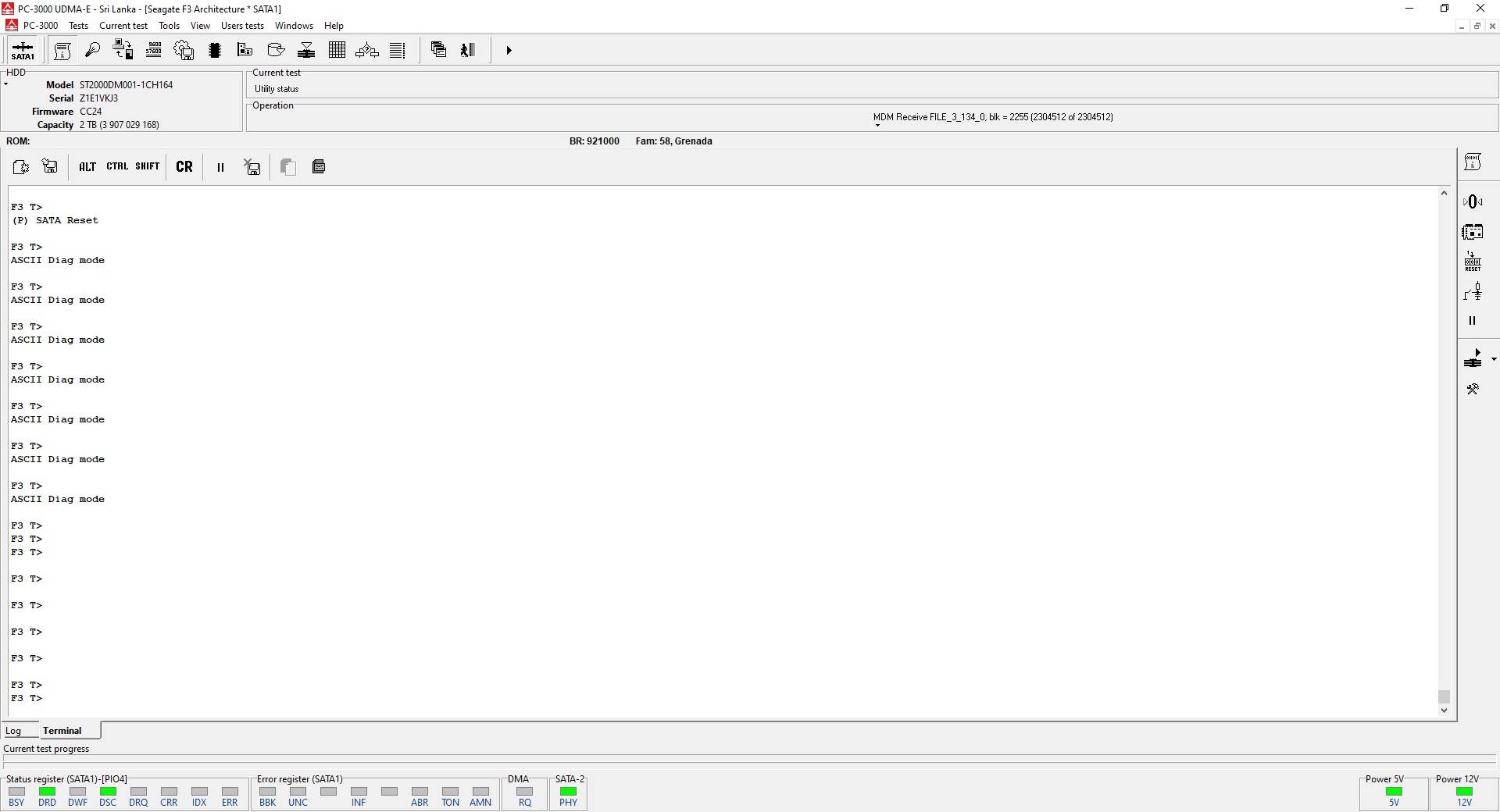

Test head 0 writing ability on mod 181. If everything ok, edit ID (mod 93) in terminal.

Hello MasterT,
Thanks for your reply,
yes can writing from head 0 system file 3-181-0, and i am edit it 3-93-0.
but still have problem.
DRCSL
Joined: 14.05.18
Re: ST2000DM001-1CH164-CC24 GRENAND FAMILY - BUSY on READ ID attempt.
Postby DRCSL » 11.03.21, 08:17
Thanks problem solved.!
