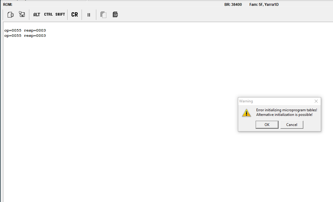

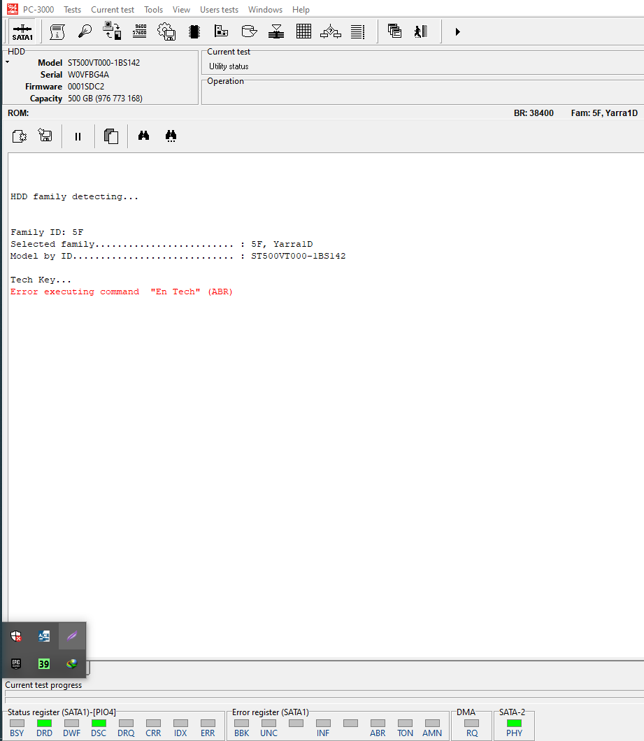

When I try to do this solution to this disk,
Code: Select all
No editing objects are found!
Tech Mode unlocking preparation, (patch).................... : Error
I see this error.
All service information object area is empty...
I see the classic Seagate error screen at the first opening.
