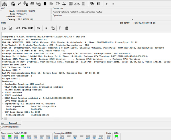

Hi to all! :mrgreen:
after a few seconds it gets busy and i can't copy the data. :shock:
Any solution ?
Please look print screen.
rosewood 8c.png (51.59 KiB) Viewed 4017 times

Postby digitalsupport » 22.01.21, 10:25
Would help if you tell what you have already done to stabilize the drive.

Postby sempre » 22.01.21, 13:38
digitalsupport wrote:Source of the post Would help if you tell what you have already done to stabilize the drive.
I waited to get ready and read the HDD ID and started reading the data. But after a few seconds ready she gets busy again!

Postby digitalsupport » 26.01.21, 16:30
Backup SA and turn off background activities.
