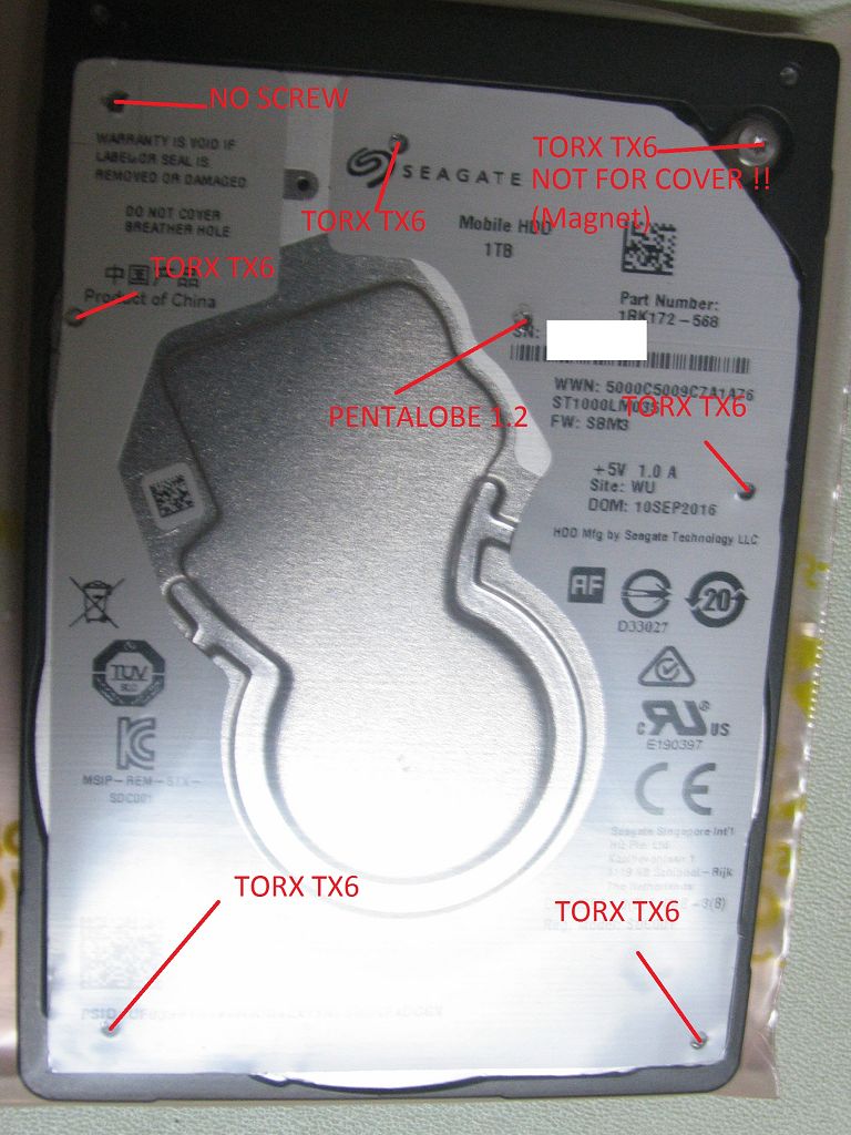

We search how to open the Seagate "mobile HDDs". The screw behind the label is not a Torx. See the following pictures:
Do you know what screwdriver we need?

This is a pentalobe screw. I have seen the HSA and ramp screw on Seagate mobile HDDs are pentalobe but the metal cover screws were still torx.
Re: What screwdriver to opening ST1000LM035 ?
Postby Amarbir[CDR-Labs] » 20.07.17, 18:13
Hello ,
its a pentalobe 1.5mm not pentalobe 1.2mm ,Little Rare To Find ,German Brands are best
Edit : Its Not 1.5mm and also Not 1.2mm .Though Only 1.2mm Screwdriver in pentalobe will fit into this but i think Seagate has a ODD Size ,It Should be 1.3mm .1.2 mm is a bit loose and 1.5mm does not fit ,What the heck i would say,just like in platter they use T7 in many HDDs odd size

Pentalobe 1.2 works well

goooz
What does it mean in your picture where it says' "not for cover" (magnet) ?
RevocoTT
Posts: 10
Joined: 12.08.12
Postby RevocoTT » 19.09.19, 22:40
It means it's not part of the cover, it holds down the magnet for the heads.

osity
Posts: 491
Joined: 05.12.15
Reputation: 4 / (44)
Postby osity » 20.09.19, 18:06
ah, I thought you were implying the screw somehow had magnetic properties. :)
